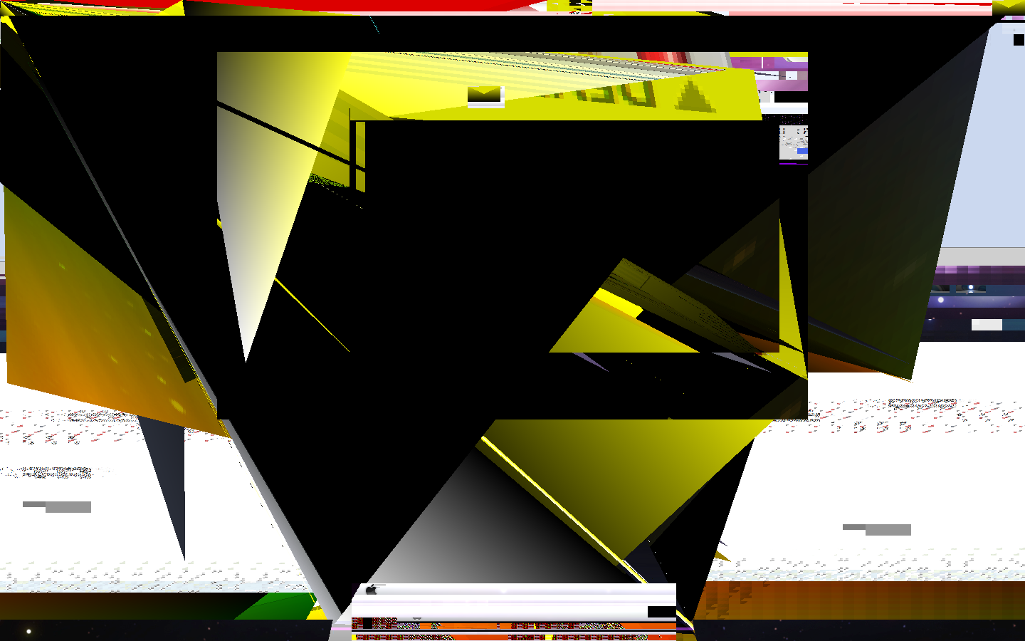

Ok, now it's doing whole screen messups. I'm calling Apple tomorrow, because this is scaring me.
That looks like a bad video driver.
The data is all there; it's just rendered wrong.
I don't know why you keep insisting he's got software issues. He's got artifacting that is getting steadily worse. That was EXACTLY the pattern of events that I experienced with my prior 20" Core Duo iMac that ended up needing a logic board replacement.
I'm glad to see he's finally calling Apple. That is going to settle the matter one way or the other. Send it in and let them sort it out.
I did some quick research and found screenshots of identical graphics problems in iMacs.
The consensus is that the problem seems heat-related, possibly due to a fan control malfunction. (fans not throttling properly or something to that effect)
There's some scuttlebutt regarding Leopard installations causing errors in the SMC.
Have you tried restting the PRAM and SMC?
Reset PRAM: Hold down Command-Option-P-R during startup until you hear the ROM sound twice.
Reset SMC: shutdown the machine and unplug all cables for at least 15 seconds; plug in the power cable, followed by the mouse and keyboard, then press the power button to start up the machine.

I certainly appreciate you guy's concerns! I took it to my authorized service provider (no apple stores here 🙁). They replaced the motherboard, and he said if it makes the graphics screwup again, they'll replace the LCD.

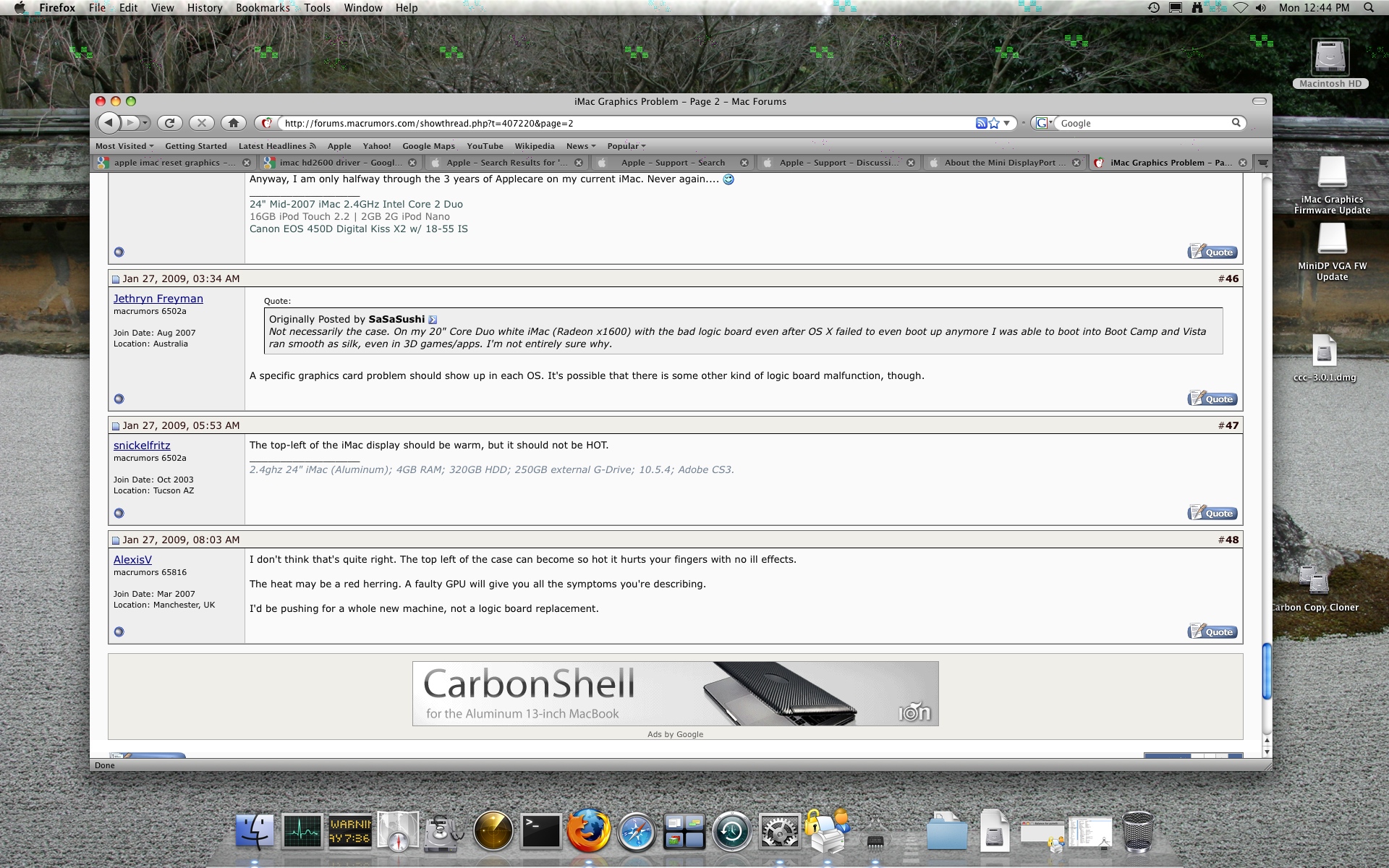

Sorry for resurrecting this thread, but I'm experiencing a weird graphics bug on a 24" iMac. On the desktop and in other applications there will be these square boxes made up of 4 green lines. This pattern repeats on the very top of the screen. Interesting thing is that this iMac is connected to a projector and if the displays are set to mirror they both have the green boxes. If they are not set to mirror then only the built-in display on the iMac shows the green boxes, the image from the projector is fine. iMac is fully up to date with all software updates and I tried installing the graphics driver again from Apple but it said it would not install because it was already installed. Attached is a screenshot, any help is appreciated.
