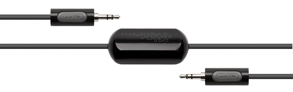

My latest work-around is the Griffin 'noise-reducing audio cable', which (and I hope that I am not speaking too soon) appears to be working. You lose a great deal of amplitude, but it appears to do the trick for $20.
This can be found here`:
http://www.griffintechnology.com/products/noise-reducing-audio-cable
and I include a picture, attached.
The boring thing about this bit of kit is that it is male-to-male, so you need a 3.5mm female-to-female adaptor.

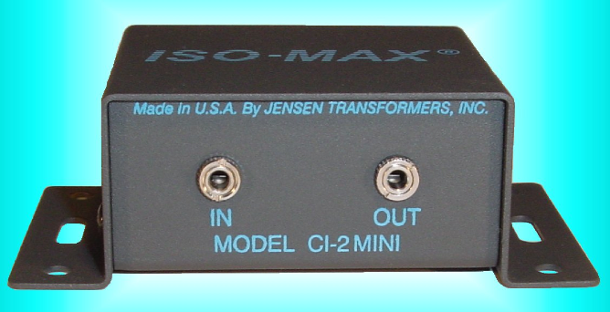

The alternative for audiophiles with deeper wallets, and untested by me, is the 'ISO MAX' noise isolator from Jensen Transformers, model CI-2MINI. It is not listed on their website ( jensen-transformers.com ), but has a similar spec. to the CI-2RR. The price is a whopping $177.95, so it had better be good. The indication is that it will be, as Jensen are often on the circuit speaking as the audio industry experts at isolating ground loops. Picture attached.
