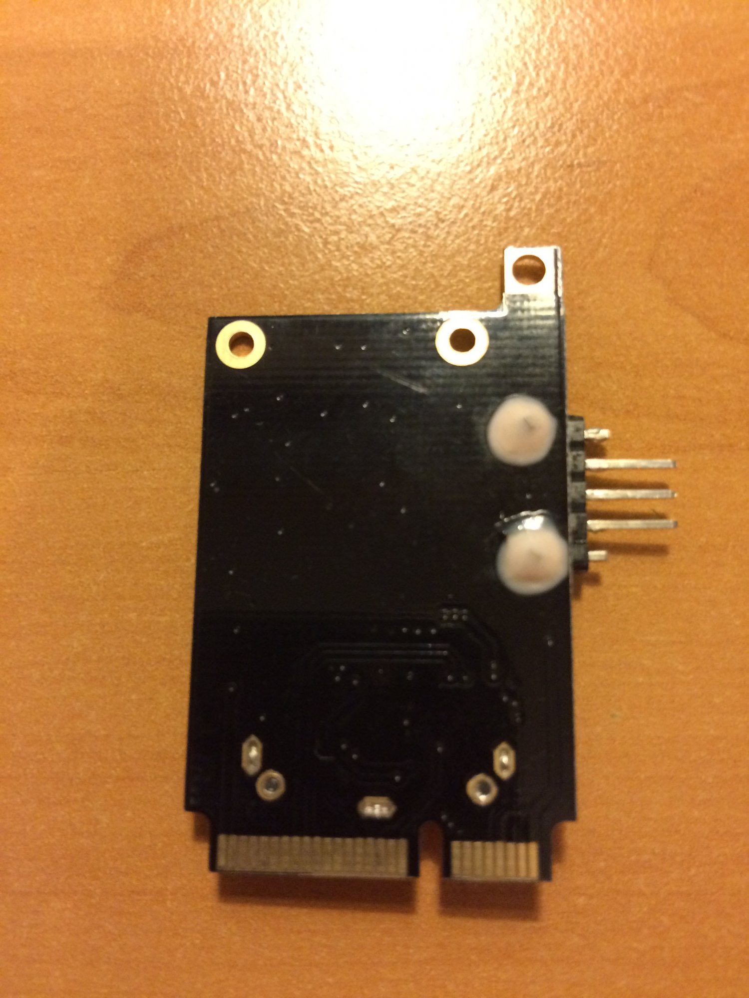

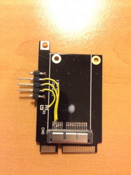

Any other user of the local338 kit ? Less expensive than OSXWifi but still quite expensive and antennas connectors "face down".
I am using a similar adaptor (which I had to modify to give it USB connectivity).
No problems with antennas connectors facing backwards.
Sorry for my question: Why does adapter need the USB connectivity. I see a lot of adapters and some, not all, have the 3 pins, but I can't find information on what their purpose and where do you connect them. Is this something I need to use to make sure I can do unlock with Apple Watch?

You need USB connection as USB pins are not connected on the mainboard socket. Therefore, you have to use the same cable that goes to the original BT card. I also cut the trace that connects the 2 power lines (BT and WiFi) on the adapter so I can enable/disable them independently.
