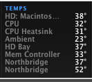

CPU: 37C
HD: 40C

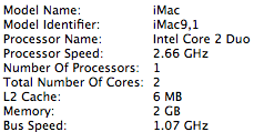

This is actually the coolest running Mac I have ever had. My G5 idled in the 50s, and my MacBook is constantly in the 60s.

Here's my 2.4ghz aluminum iMac under normal use just reading forums.

I don't know that this is true or if its true for the older models, but mine reads cool and is cool to the touch everywhere.
