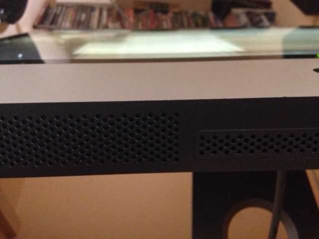

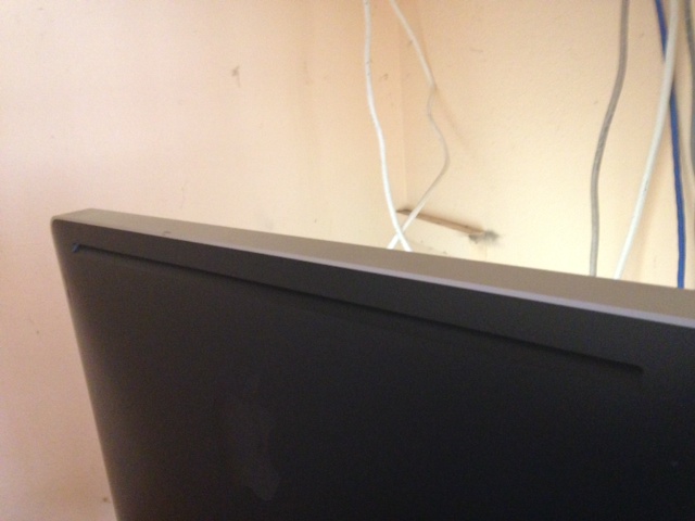

Clogged vents will also cause your iMac 2007 fan to run hard. Check the bottom grates on the bottom edge and top vent on the back, gently vacuum if needed. After a lot of fan noise one summer, I noticed quite a bit of dust blockage on the bottom of my '07 (still going strong/factory WD hard drive had to be replaced). Cleaning helped a lot. The iMac body does get quite warm to even hot which can be disconcerting to new uses but this normal for iMacs.
Bottom Vents underneath bottom edge
Top Vent
