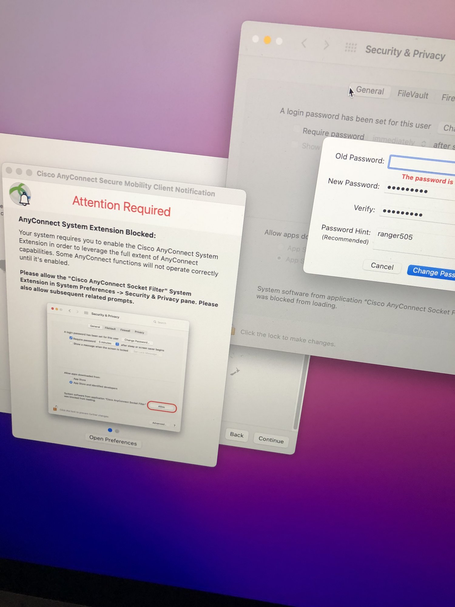

I recently bought a iMac (Retina 5K, 27-inch, 2020) originally was working I wanted to reformat the hard drive and erase everything. After doing so I get a error message wants me to put in the old password but I don’t know it. My friend is a IT person and told me you got burned the computer is basically scrap now. The guy I bought it from used it for work he quite when the company went out of business he says he never had a password. I hate to throw it as I paid quite a bit of money. Any suggestions on getting it working again I have attached a picture of the error message it is giving me. I contacted Apple they really weren’t any help they had me do the same thing that I intended to do

Your understanding is not applicable to OP's case. His iMac was a company issued item and there is a hidden ID and password to log into the Company system using VPN. The previous owner didn't have to log-in the iMac because auto-log-in was set. But any changes to the machine will require an administrator's password.
In a normal case of usage, using an USB installer may be able to erase all the set-up and return the iMac to factory setting.
In a worst case scenario, the iMac was locked by EFI password and for T2-security chip equipped iMacs, it's not an easy job for a novice user to remove the EFI password (i.e it's Mission Impossible for the OP).

The 2020 iMac was $600 because it is owned by a business and is under Mobile Device Management. The iMac might be stolen The only way to know for sure is to look up the company name listed in the remote management window to see if it really went out of business.

I also work in IT, I manage Macs. If the company didn’t properly release the device from their systems, you really are out of luck. There’s no way around it. If they were still in business, that would be a different story
