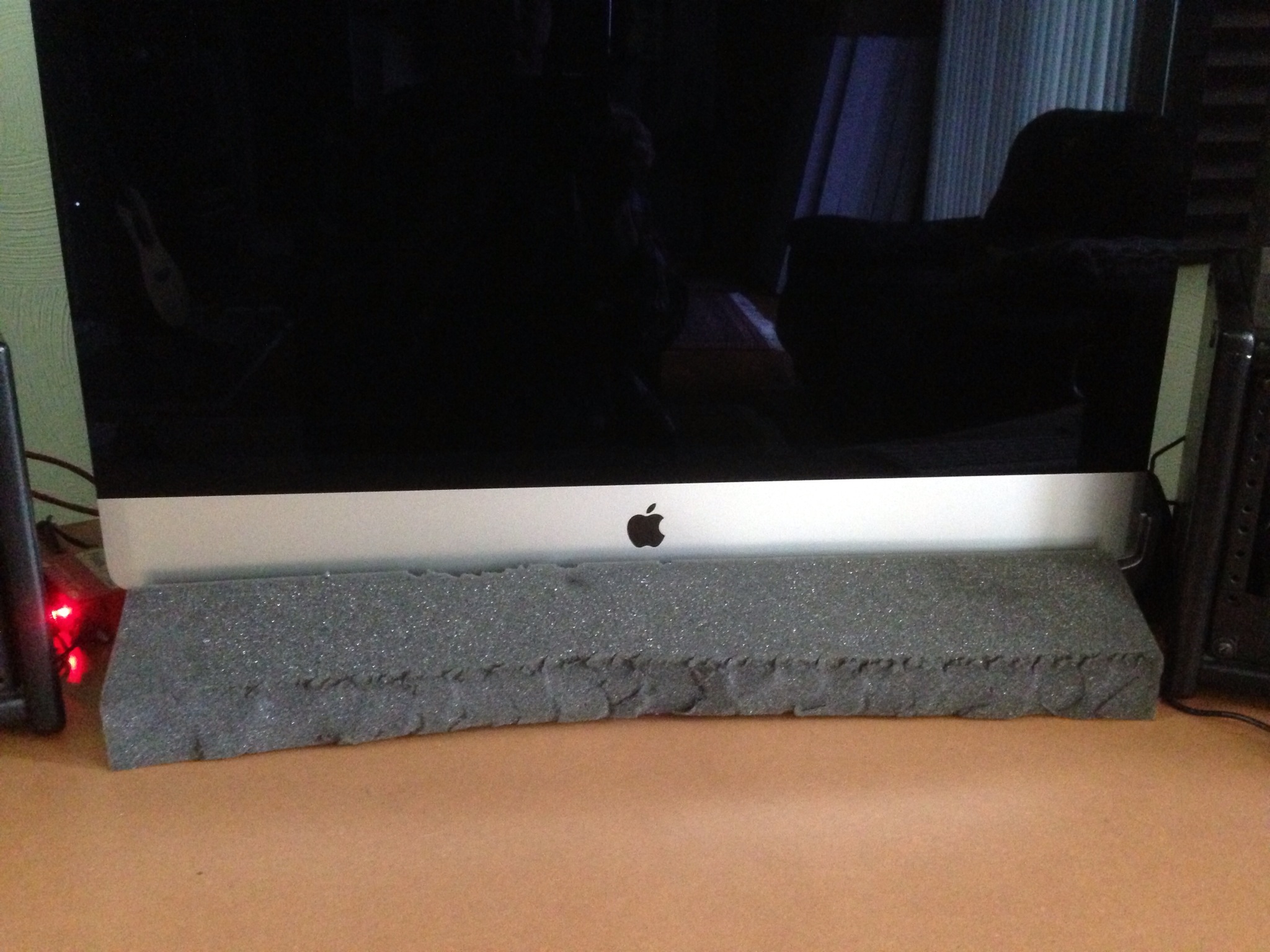

1200 rpm on the new 27" is very quiet to me. Measures ~1dBA over background room (32dBA room - 33dBA with imac on sitting 2.5feet in front of it. FWIW I can still hear that enough that I put a piece of foam on the table to block reflected fan noise from the grates to the stand/desktop.
You may have a faulty/especially noisy fan in which case I would either bring it back or if you need a machine to keep going - order a new one - get that one then bring it back.
OR- there may be nothing wrong and you may be sensitive to the noise these make. I feel for you! A mini at lowest fan put as far away from you as practical will be quieter. If the fan ever ramps up on it though - you will not like it...
