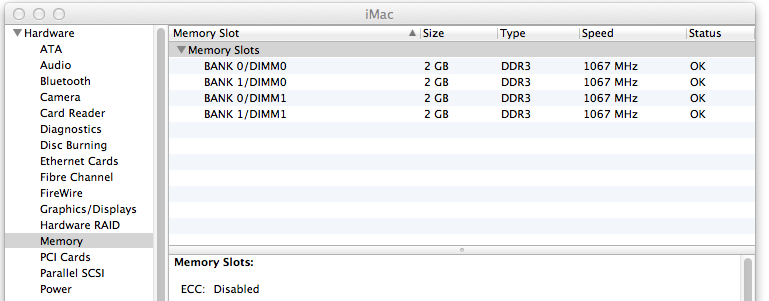

When you boot with stock RAM check the Bank/Module number :
Example in this screenshot :
attachment.php
As far as I know, Stock RAM should be in the same Bank ( 0 or 1 ). Your new ones should be in the other Bank - Dual Channel configuration --
Hence the perplexing manner of this issue. lol Because I can't actually see all four on screen, I checked the memory info in About this Mac for each set (one set installed at a time). Except for the size, both sets come up as the same specs (DDR3 1600Mhz SODIMM). And I installed all 4 modules as they should be installed. One set in 1+3 slots, the other set in 2+4 slots.
Actually, it's the other way. If you have two different sized pairs, one matched pair should be in DIMM0, and the other pair in DIMM1. If you think of BANK as Channel it makes sense. The list in system info is not the actual physical order of the slots. To verify the proper order look at the memory layout diagram in About this Mac. If you have 2 x 4GB and 2 x 8GB each row in the diagram should contain a matched pair. This is for dual channel performance for the entire 24GB. If the DIMMs are paired as 4+8 and 4+8, you will still get dual channel performance for the first 16GB. Only the memory between 16GB and 24GB will be single channel. This is because the Intel memory controller will use dual channel for the lowest value in the pair, so 4+8 will be dual channel for 4+4.
indeed, I was confused between Bank ( whatever that means ) and channel.
I Think they should have Wrote DIMM/Bank instead of Bank/DIMM but thanks for the correction.
I agree that Apple's terminology is a bit odd here. For triple channel it would be very obvious as there would be BANK 0, 1, and 2, with DIMM 0 and 1 for each. I assume that's the way it would be in the Mac Pro with triple channel RAM. Asus motherboards use letters for the channels, and numbers for the DIMMs, so for dual channel you'd have A1, A2, and B1, B2 in that order on the board. If you only had two DIMMs you would fill A1 and B1.
