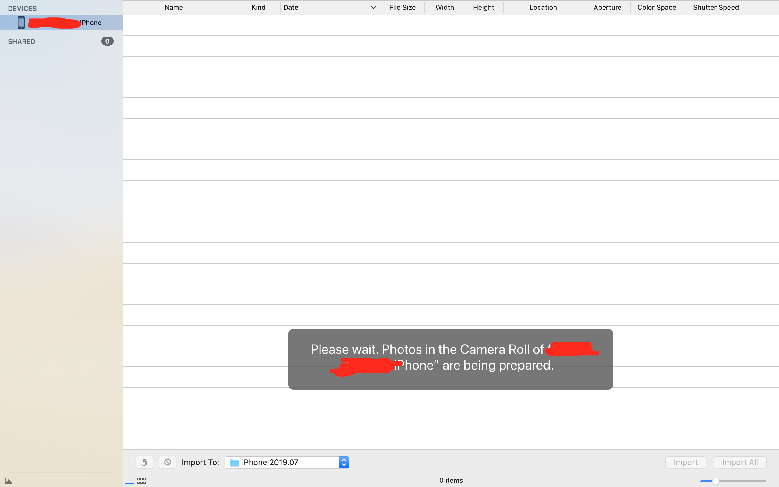

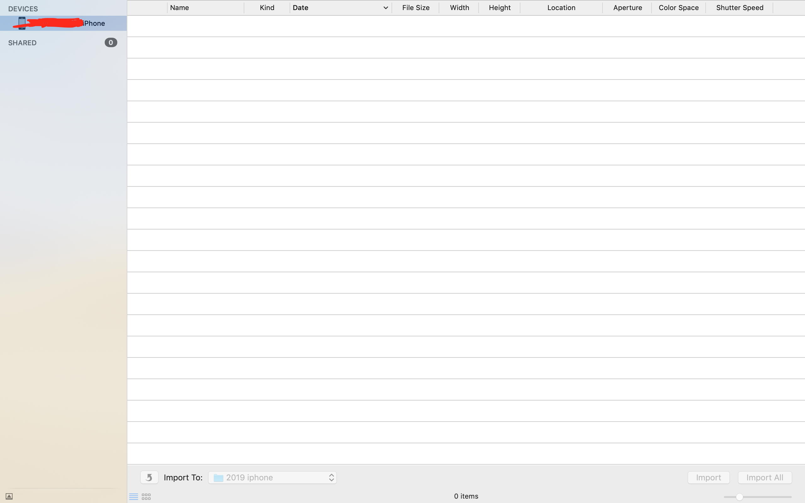

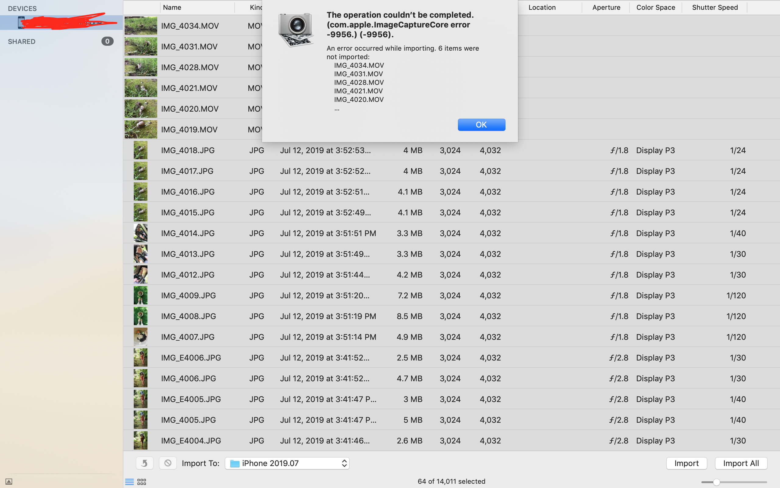

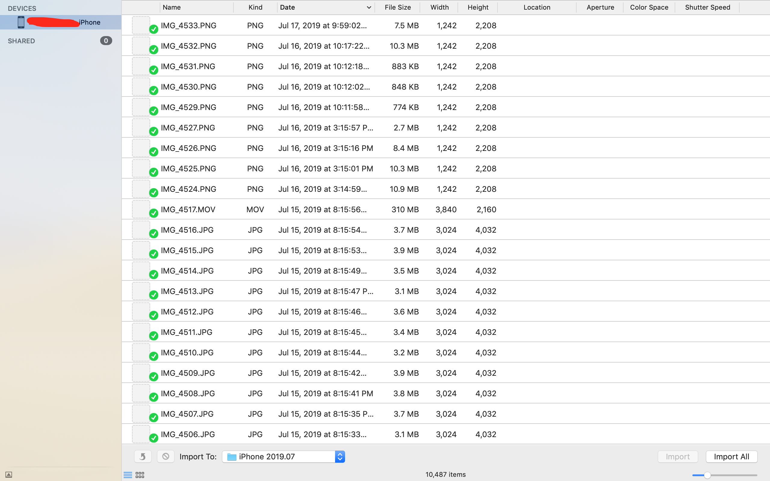

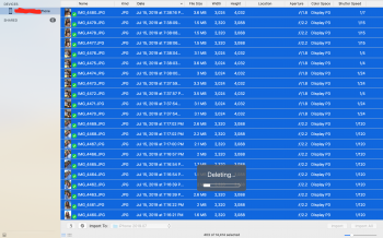

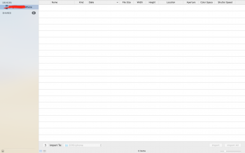

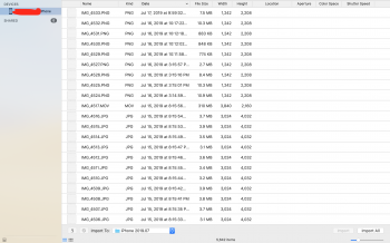

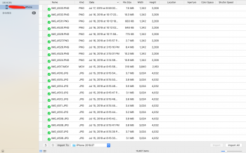

The same thing has been happening to me and it's so frustrating. I've used Image Capture dozens of times before and transferred thousands of pictures at once from my phone to a hard drive without any issues. Today, image capture has repeatedly frozen on me while transferring photos. I was only able to transfer about 450 photos before it completely stopped working. No amount of restarting my Macbook Pro or iPhone 8+ has helped (both devices are up to date). My charging cables are relatively new, clean, and shouldn't be faulty. When Image Capture has frozen, I've cancelled the image transfer, and then it shows me a bunch of error codes. Now... my images are no longer showing up in Image Capture at all. The Photos app isn't even showing my pictures, although it is recognizing my iPhone. This all feels like a huge conspiracy designed to force people into paying for iCloud storage.

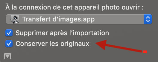

Hello i fixed my issue just by clicking on "Keep Originals" checkbox on Image Capture option.
Imports now are fast, like i was used to.
At the bottom of the app, toggle Transfer to Mac or PC to Keep Originals. (screenshot from Capture.app FR-fr)
