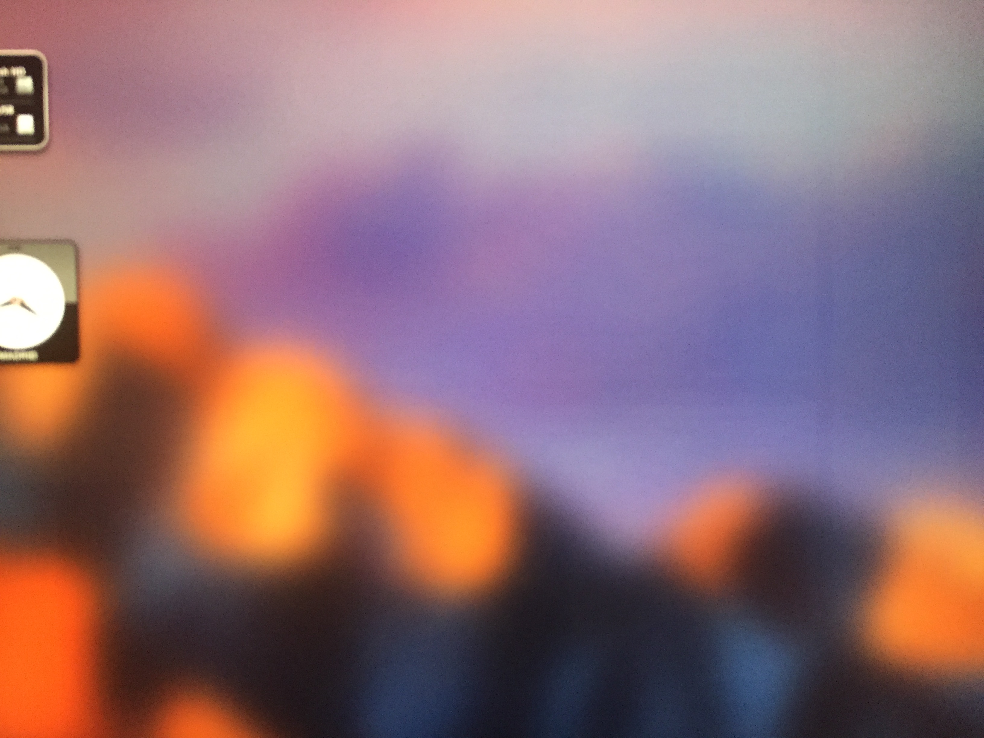

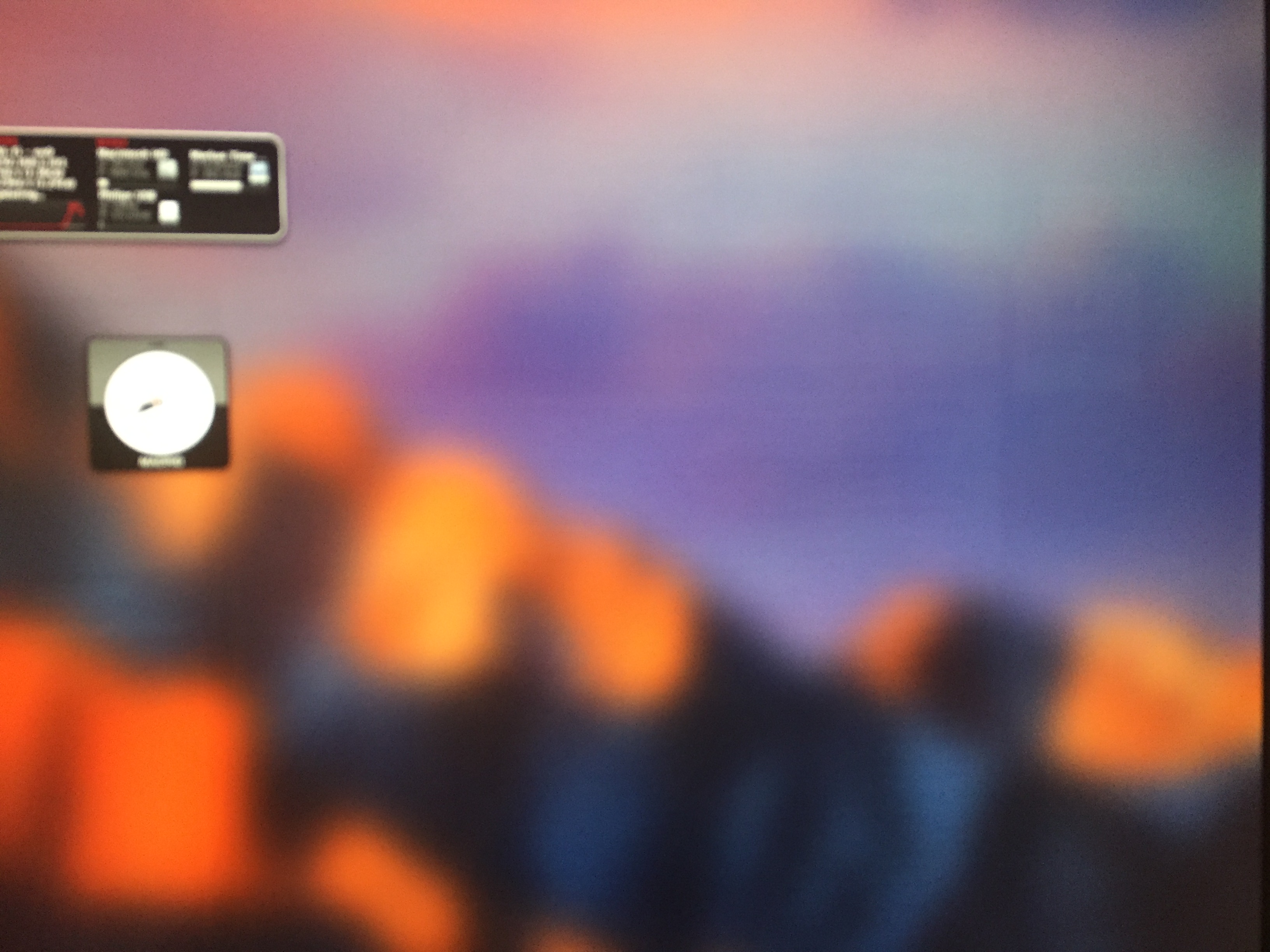

I noticed when using applications like Pages or Safari and afterwards changing to dashboard, the display shows clearly image retention. I did the image retention test and after only 5 minutes there is a ghosting/retention effect. The image retention disappears in some minutes. In normal use, this doesn’t bother me too much, but I am afraid that this could be a serious defect, that could get worse over the time.

[doublepost=1490426712][/doublepost]Here is an image where you can see what I mean:

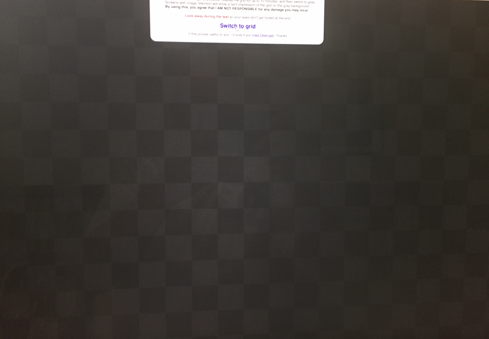

I tried the image retention test (google search: image retention test). The above images shows the result after only 5 minutes!!!🙁. I am sure that this is not normal. Please can anyone do the same test, to compare the result.

Some people say that this is a normal behaviour of ISP panels, maybe this happens too all LG 5k panels. If so, it doesn't makes sense to change the display. Therefore, please, if you are a owner of this panel, try this test for 5 minutes an show us the results.

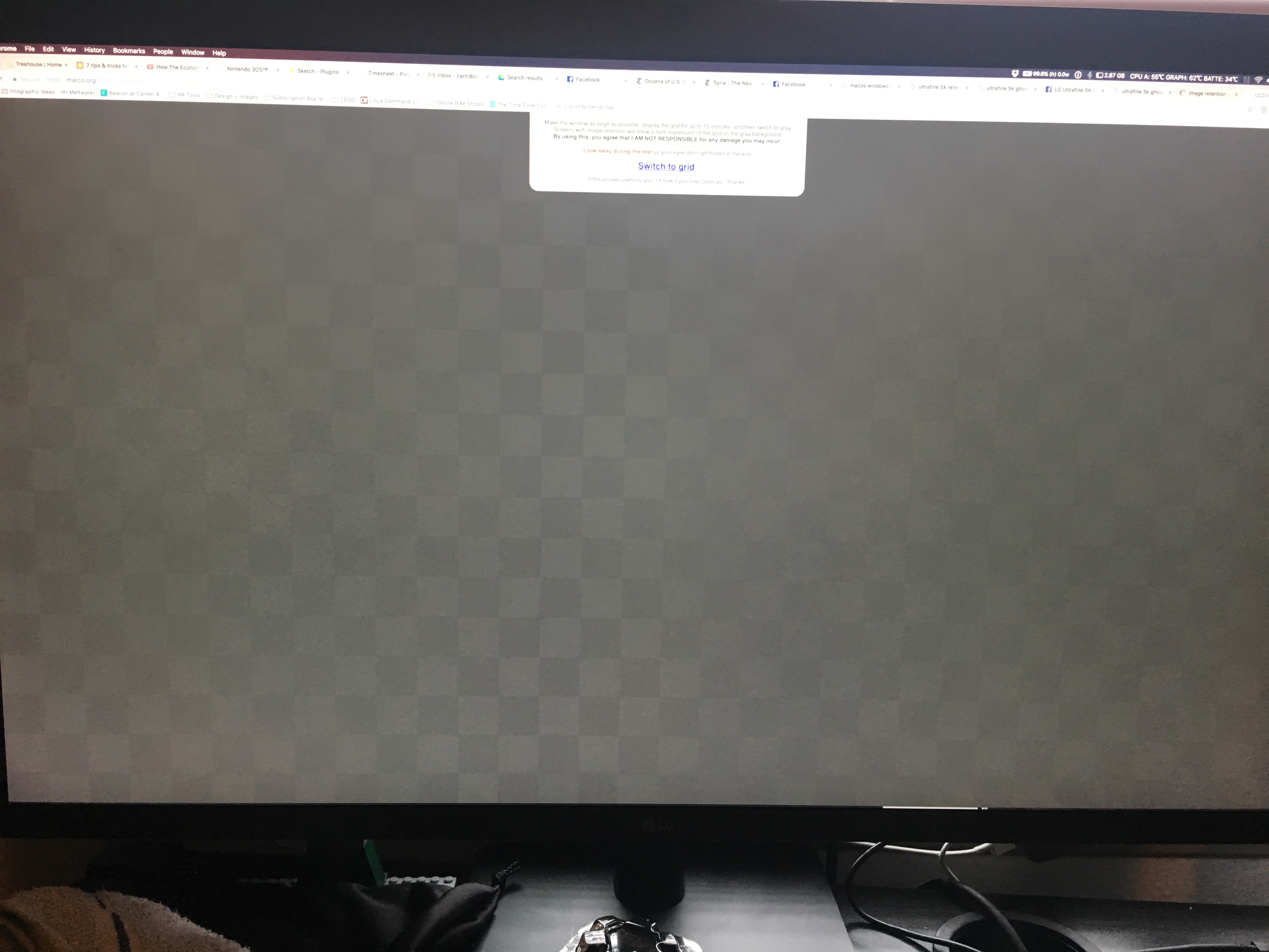

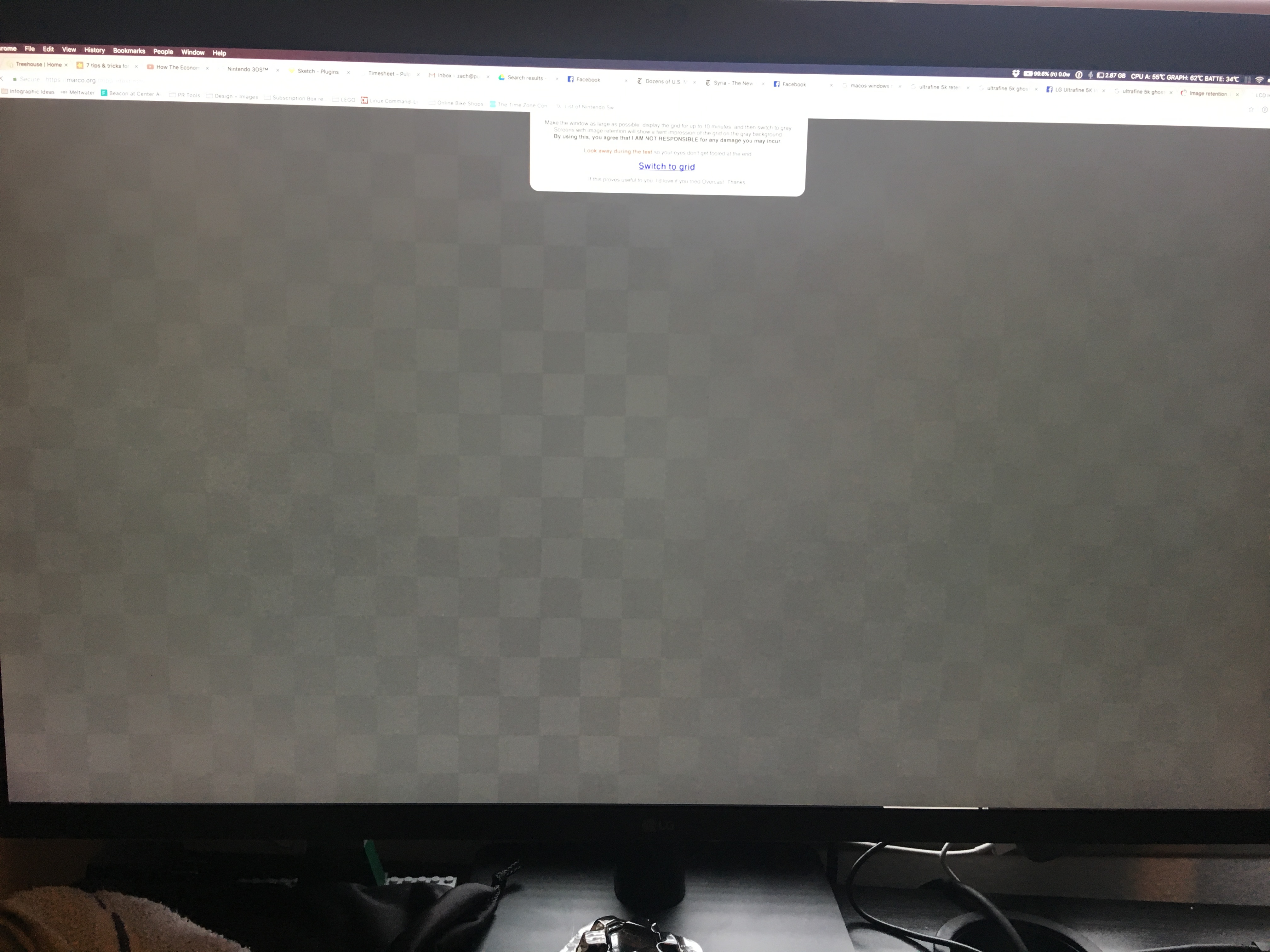

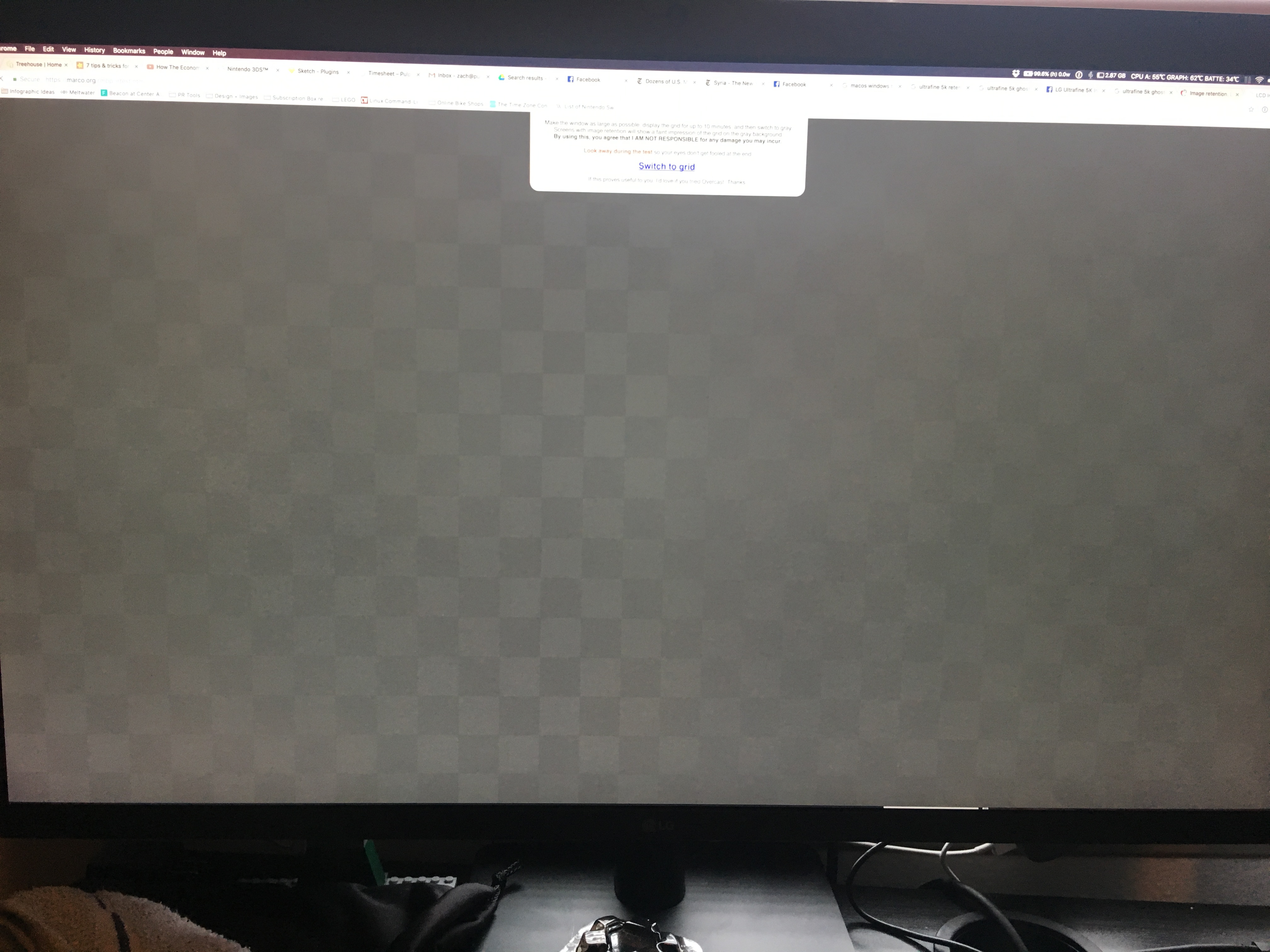

This is after only 3 minutes.
This looks very bad too. I am sure that there are a lot of monitors LG 5k where happens the same.
