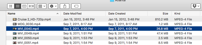

I noticed few post on the subject but nothing similar to what I have...
File created / modified are properly set:

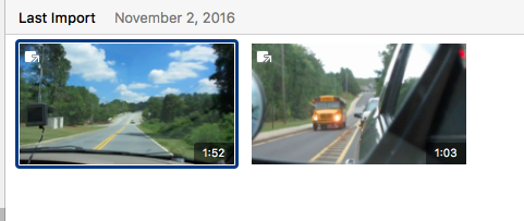

but once the file is uploaded, it is taking date from somewhere else...
It's not todays date - Today is Nov 4th.

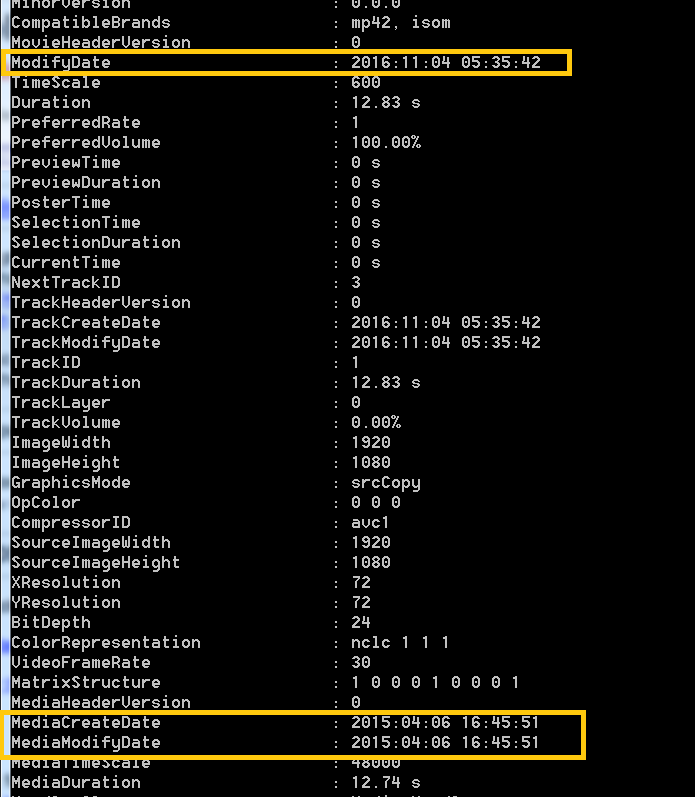

First, you'll need to find one of the properties that contain the correct date. In my case it was the File Modify Date.

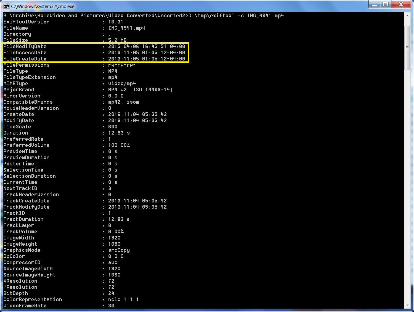

To review the file properties, run exiftool -s <FileName>
In my case, the Modified date was the time the video was taken. it might be created date in other cases.
We can see that the dates are wrong for Media Created and Media modified (in my case, this was the date I converted the original videos to MP4).
These are the dates that Photos is using to tag the videos.
NOTE: Most likely that the "modified date" will be modified as we trying to modify the file properties. so it is important to use this date first if this going to be the source for the updates.
You probably need to view some of the files, make sure that dates are correct.

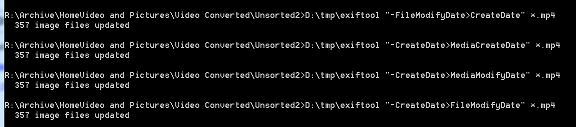

I used the following script:
exiftool "-FileModifyDate>CreateDate" *.mp4
exiftool "-CreateDate>MediaCreateDate" *.mp4
exiftool "-CreateDate>MediaModifyDate" *.mp4
exiftool "-CreateDate>FileModifyDate" *.mp4

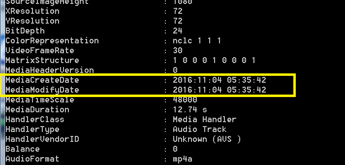

First, I updated the created date and then, I used the created date to update all other dates.
Once completed, I validated:
Now, I uploaded all videos into Photos and all date tags was properly set!
