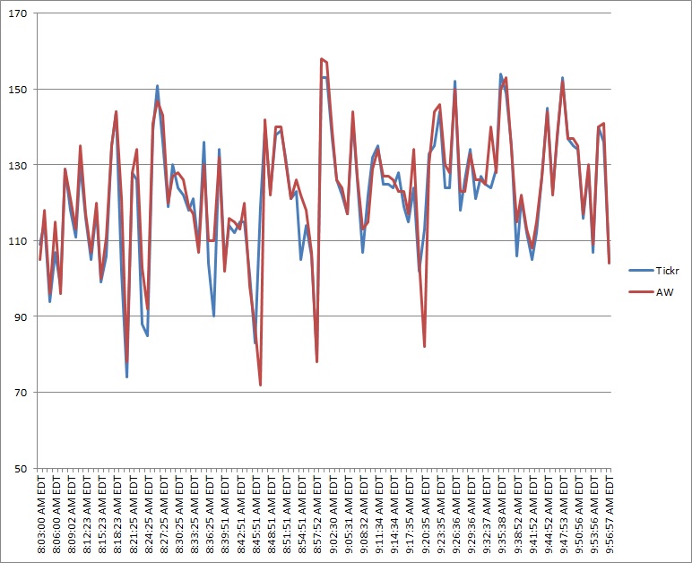

Here is a comparison of my HR rate during this mornings 35 mile ride. The blue line was recorded with my Garmin 800 and Wahoo Tickr chest strap, the red line with the Apple Watch. As you can see, the AW had a tough acquiring and reading my heart rate during much of the first half of the ride. It basically said "measuring" during most of the first half of the ride. It did seem to get better as the ride went on. It seemed to track much better with the chest strap prior to the update...

No but I will try to pull one together ... I have the data. It is a bit of manual process due to the ridiculous nature of the Apple Health app ... There just is at any easy way to export the data.
One observation I forgot to make about the chart I posted above. It seemed the AW had the most difficulty acquiring and maintaining my HR during the section of the ride where there were a lot of steep rollers. Places where your descending down a 10% grade, then a few seconds later you are ascending a 10% grade. During these sections my heart may be in the 80s during free wheeling the descents, then quickly rise to 160 or more as you are climbing the steep grades.
It is almost as if there is some algorithm that throws out readings that change by a certain % from one five second interval to the next. Could just be a coincidence, but the area with the most dropouts was exactly as I describe above.

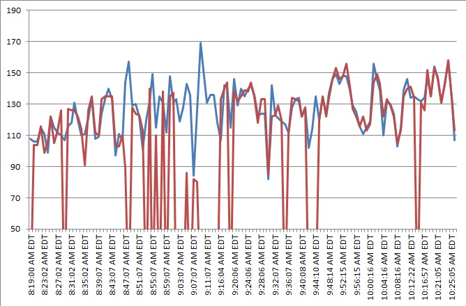

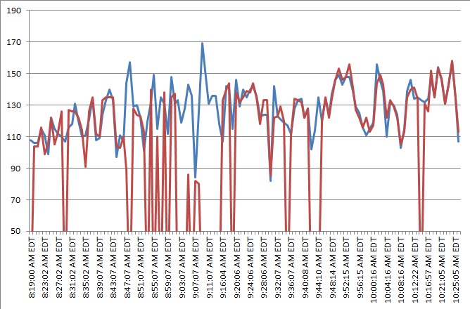

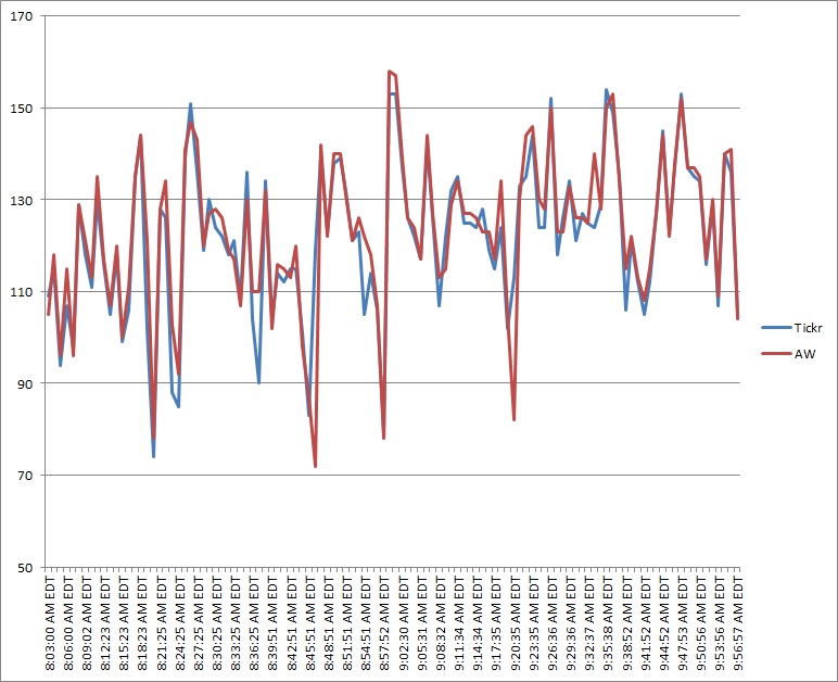

OK, so the suspense was killing me. I had to go back and pull together another chart .. this time from 5/18 before the 1.0.1. update. As you can see, the AW and the Wahoo Tickr chest strap tracked nearly perfectly as I suspected and observed during my ride.
I don't understand why Apple can't just come out and say ... we effed it up with 1.0.1, but we are working on a fix that will be out shortly. That at least would give me some hope. But with Apple saying nothing, it makes me believe they don't see an issue where one clearly exists.

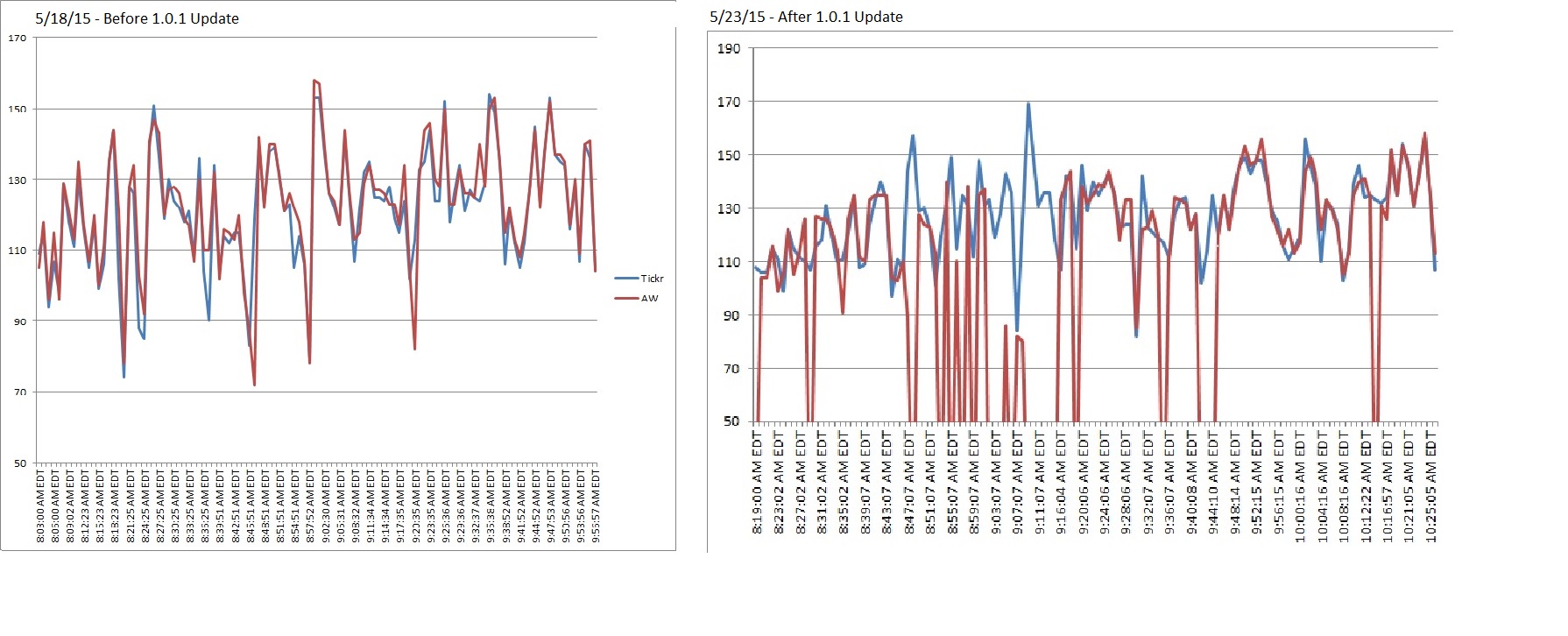

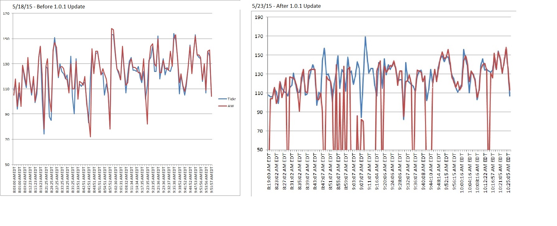

Here is a side be side comparing the charts on bike rides of similar distance and terrain before and after the update:

Thanks but I don't think that is the issue. It was worn exactly the same way in both of the charts I posted above.
The only thing that has changed is the OS version.

My early experience with AW was great as it clearly was the most accurate of any optical HRM I have owned. That changed with the 1.0.1 update however and now it is totally inaccurate.

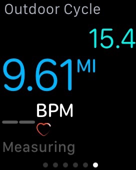

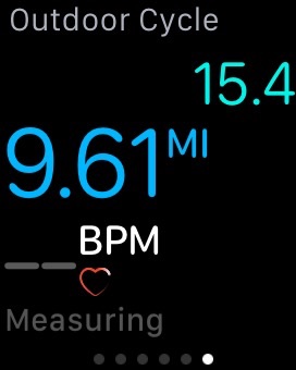

So this is basically what I saw on the AW throughout my 2+ hour bike ride this morning. When I went back and looked at the HR data in the Health app I see many gaps of 3 minutes or longer and some minutes with just 1 or 2 readings. In workout mode the watch is supposed to take a reading every 5 seconds ... You can see by the screen grab I was in "Outdoor Cycle".
I am thoroughly disappointed in Apple .. first for messing something up that was working fine prior to the update and secondly not acknowledging that there is an issue.
Again, this behavior only began after the 1.0.1 update.

It was done manually in Excel unfortunately since Apple didn't see fit to giving us a usable to export "our" own data.
