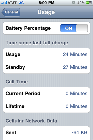

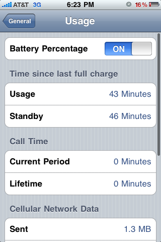

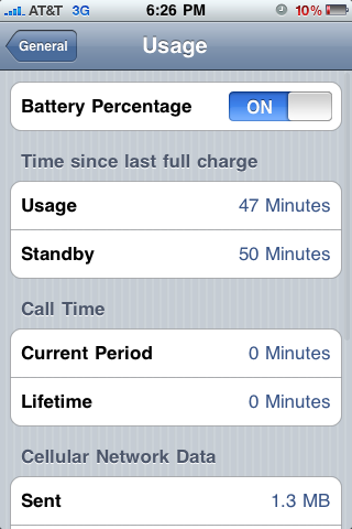

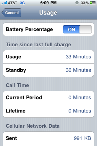

experienced this battery issue right after iPhone 3.1 update, so i decided to restore as new phone this morning and use it without changing anything, didn't even add email accounts or applications and still experiencing same issues.
At this time my phone is practically unusable what so ever! tried turning off and on, clearing all settings, etc etc with no luck. Any tips or help would be appreciated
32GB iPhone 3GS

Did you restore in DFU mode (and if the answer is yes, are you sure you were really in DFU mode...many people get that wrong)? Also, did you set up as a new iPhone, or did you restore from a backup?

yes, i did a DFU restore and setup as new phone, same issues

your phone dropped from 49% to 10% in 26mins? time according to your clock....
dont even bother, take it to the apple store...something is clearly wrong...when people talk about bad battery life, they are talking more like a day or half a day with everything possible running...push on, fetching every few mins. You phone lost approx 40% in 26mins.....thats a shot battery.
If you DFU mode and restored it to a brand new phone and it continues, its gotta be replaced.
