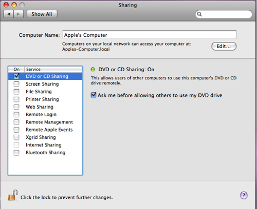

I think you have to use the CD sharing feature found on the macs system preferences
Thanks. I'll give it a try tonight. I wonder if I used the wrong sharing. I went into sharing preferences and checked "file sharing".
Yep, file sharing shares files, CD/DVD sharing shares complete CD/DVDs and uses them as CD/DVDs, as file sharing doesn't recognise the CD/DVD as CD/DVD and will not allow any CD/DVD behaviour, thus the two links I provided.

I did this last night. Turn on CD/DVD sharing on the one with the drive, then on the MBA you should see a Remote Disc icon in a Finder window. Click on that and request the drive and install. Worked perfectly.
