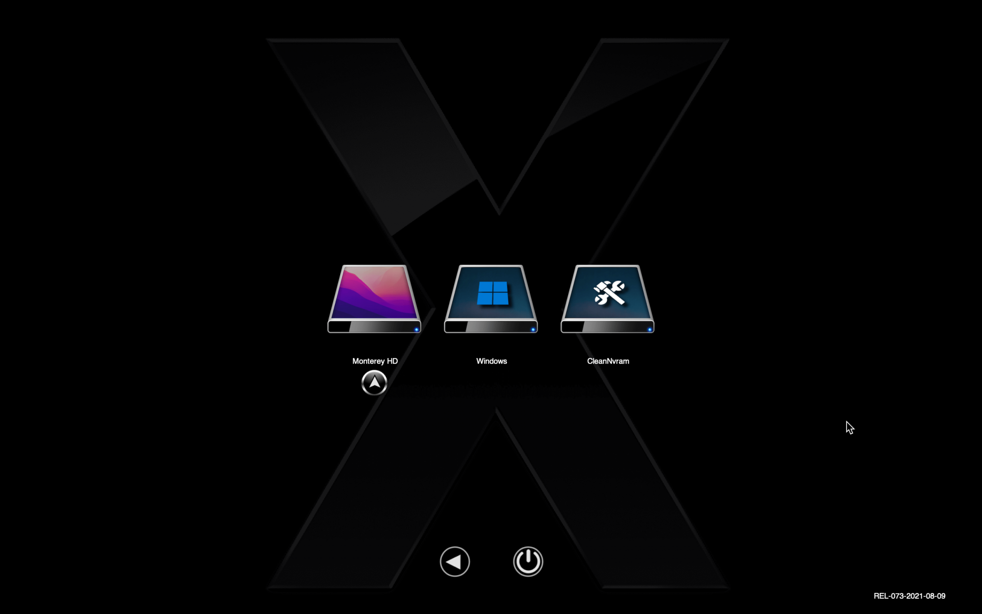

And, to make sure, does post #9 mean to modify the EFI folder linked to in the first post or one freshly generated by OCLP?
When I do the latter, there’s no ClearNvram to select at boot.
Post #9 does not reflect the first page of this topic, OCLP hase nothing to do here
Use the file provide here and you will see ClearNvram
Reactions: macpro_mid2014
Will do. I’ll follow post #1 as close as I can and let you know what happens. Thanks for being patient. I’m new to this.

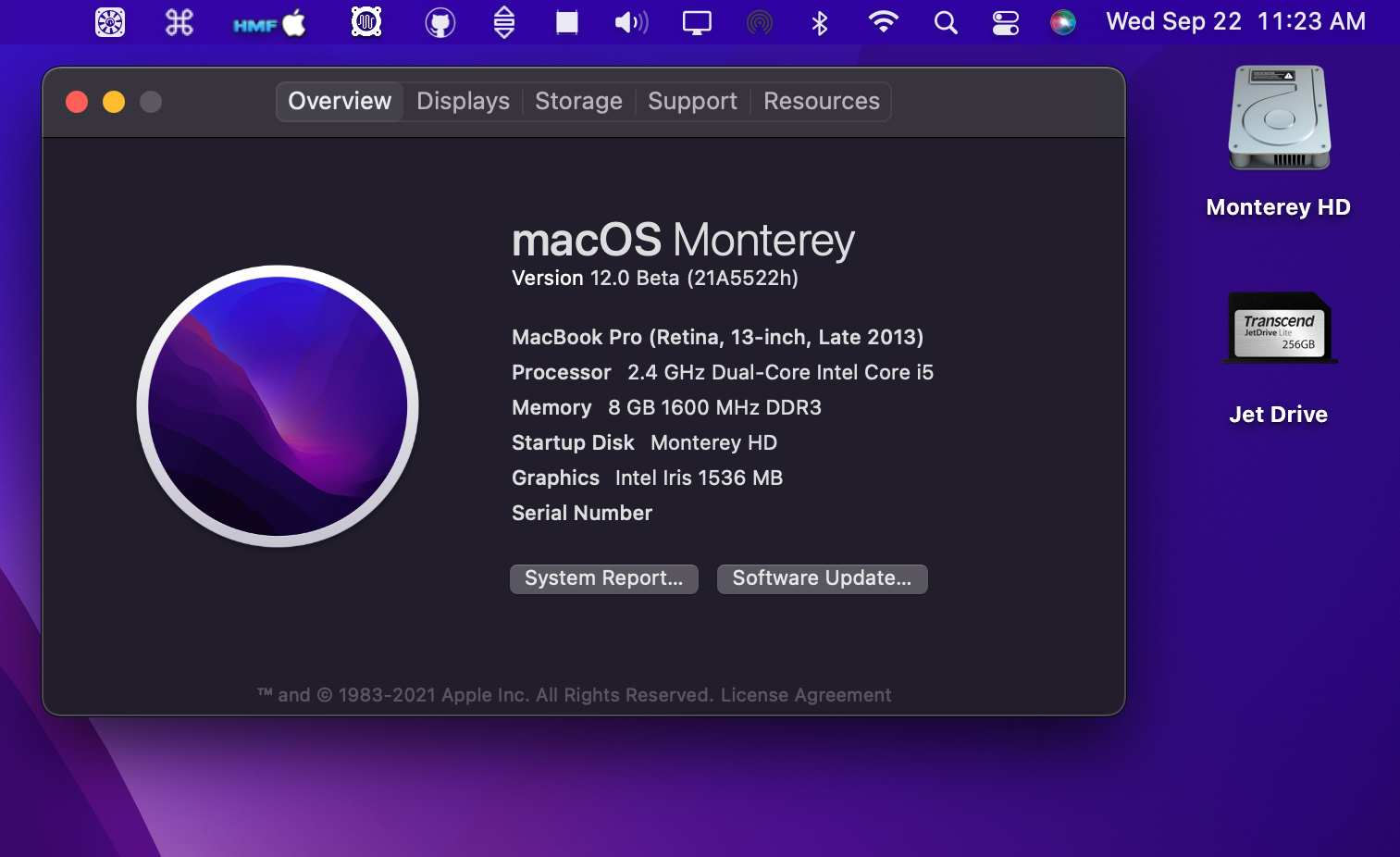

Well, following the OP’s instructions closely seems to have done the trick. I have a clean install of Monterey on my internal drive that boots without issue and hasn’t had any kernel panics. I suppose OCLP has a bunch of kexts that don’t fit my machine’s needs and were causing them, but I certainly don’t know.
Currently giving migration assistant a try in pulling over my user account from my backup and hopefully by morning I’ll be all fixed up. Maybe even able to just install future Monterey updates without having to think about anything special.

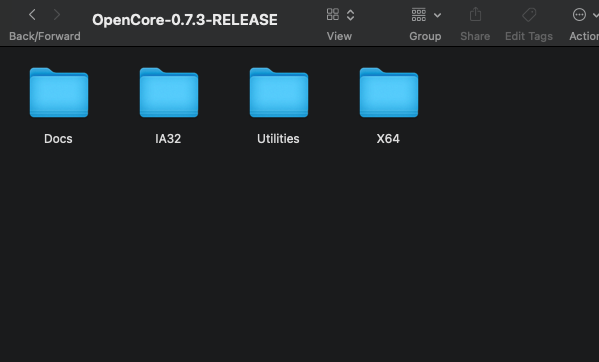

If you want to stay in the base of this topic and make your own EFI OC I strongly advise you to compile OpenCore from source here ☞ OpenCorePKG
and use the output files in OpenCorePkg ➤ / Binaries ➤ / OpenCore-0.7.3-RELEASE.zip unzip the file and everything is there : DOC , EFI , Utilities
Read the DOC You don't need nothing else
This post is add in the first page

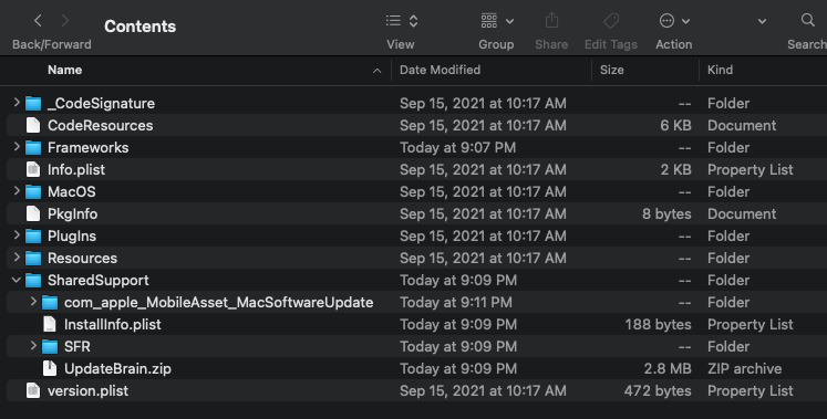

This is the contents of the script, you can read and open with TextEdit
#!/bin/bash # script for making installer Monterey Beta 7 # by chris1111 echo " **************************************************** ****** Install macOS Monterey ******* ****************************************************" sudo rm -rf /Applications/"Install macOS Monterey beta.app" sudo rm -rf $HOME/Downloads/InstallAssistant sudo installer -verboseR -pkg $HOME/Downloads/InstallAssistant.pkg -target / echo "Expand Package Please Wait. . . " pkgutil --expand $HOME/Downloads/InstallAssistant.pkg $HOME/Downloads/InstallAssistant Sleep 1 echo "Attach Image " echo " " hdiutil attach -nobrowse $HOME/Downloads/InstallAssistant/SharedSupport.dmg sudo mkdir /Applications/"Install macOS Monterey beta.app"/Contents/SharedSupport echo "Copying Resources Please Wait. . . " sudo cp -R /Volumes/"Shared Support"/* /Applications/"Install macOS Monterey beta.app"/Contents/SharedSupport echo "Copying Resources Please Wait. . . " Sleep 1 hdiutil Unmount /Volumes/"Shared Support" echo "Done. "
This is the Contents of the working app
you can Install direct to the SSD, Also Create Install Media on USB
On my Real MacBook pro its work on every attemp
Anyway Good Luck

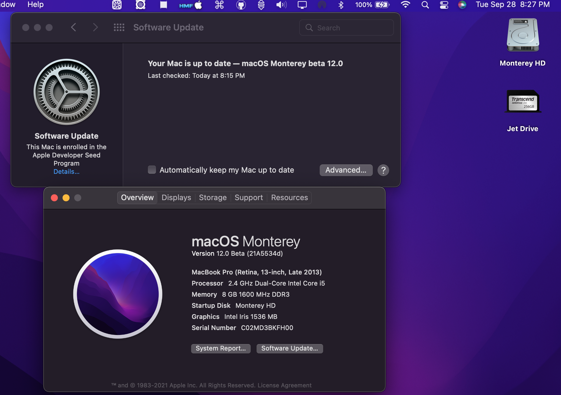

OTA update from Beta 7 to Beta 8 finished without any issue. The update was about 40 minutes only. During the last reboot, I got a 10min countdown and that's it!
No need to use the OPTION key to select the correct boot option.
It is really a shame my MBP was excluded from the official Monterey update.
Reactions: chris1111
Hmm, my Software Update pane just checked for updates and found none. Still on beta 7. Hopefully that's normal. :|
OTA from B8 to B9 took less than 40 min.
