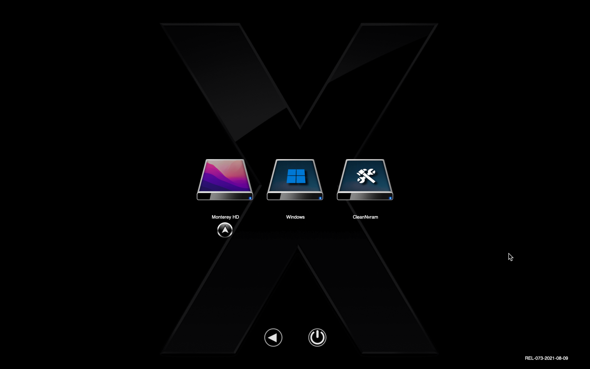

Create install Media of Monterey put the EFI folder on EFI Partition of USB installer then boot from option select EFI USB install Media on the OpenCore menue Icons, select ClearNvram
and Reboot the system ➣ TAB
Reboot
Reboot again Option EFI USB install Media select Install macOS Monterey
Formate the Disk then Install macOS
Reboot again Option EFI USB install Media, select macOS Installer then complet Installation
NOTE : You have to boot multiple time on macOS Installer.
Reboot again Option EFI USB install Media, select your Disk to complete installation
You have to boot twice on the disk to complet
Post Install ⬇︎
Mount the EFI Partition of the SSD then put the EFI Folder then unplug USB Install media
Done! Enjoy.
After everything is finished, you can remove the -v in the config.plist to have the apple at boot.

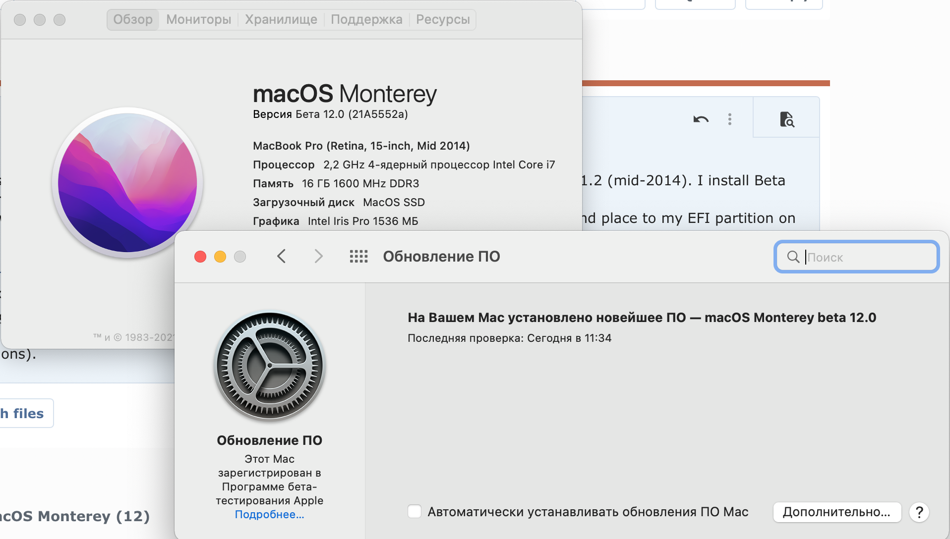

Hi 🙂
Thanks for the instruction - working perfectly macOS 12.0 (21A5552a) on macbook pro 11.2 (mid-2014). I install Beta Monterey above BigSur (please create CCC backup before any operations).
1. I download EFI folder from macpro_mid2014 attached, but update opencore to 0.7.4 and place to my EFI partition on laptop.
2. Run sudo /System/Library/PrivateFrameworks/Seeding.framework/Versions/A/Resources/seedutil enroll PublicSeed (from macpro_mid2014 messages) and reboot.
3. Check updates from System Preferences, receive update and run installation. That's all. All app still present and working. Thanks 🙂
p.s. This is bad way, casue may be better run clean installation, but working(please create CCC backup before any operations). Please usage if you want check you device for working Monterey and waiting new m1x(m2) laptops. 😉
