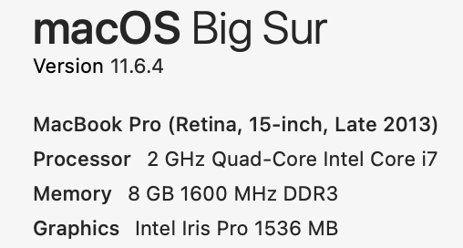

I have a "15-inch, Late 2013" MacBookPro11,2 (2 GHz Core i7, 8 GB RAM, Intel Iris Pro) that I'm now thinking about moving from Big Sur to Monterey.
I'm curious, how is the performance of Monterey on this or similar computers compared to Big Sur?
And, are there any odd issues to worry about? Xcode still runs and installs apps onto iOS devices, FaceTime/Zoom still work, etc?

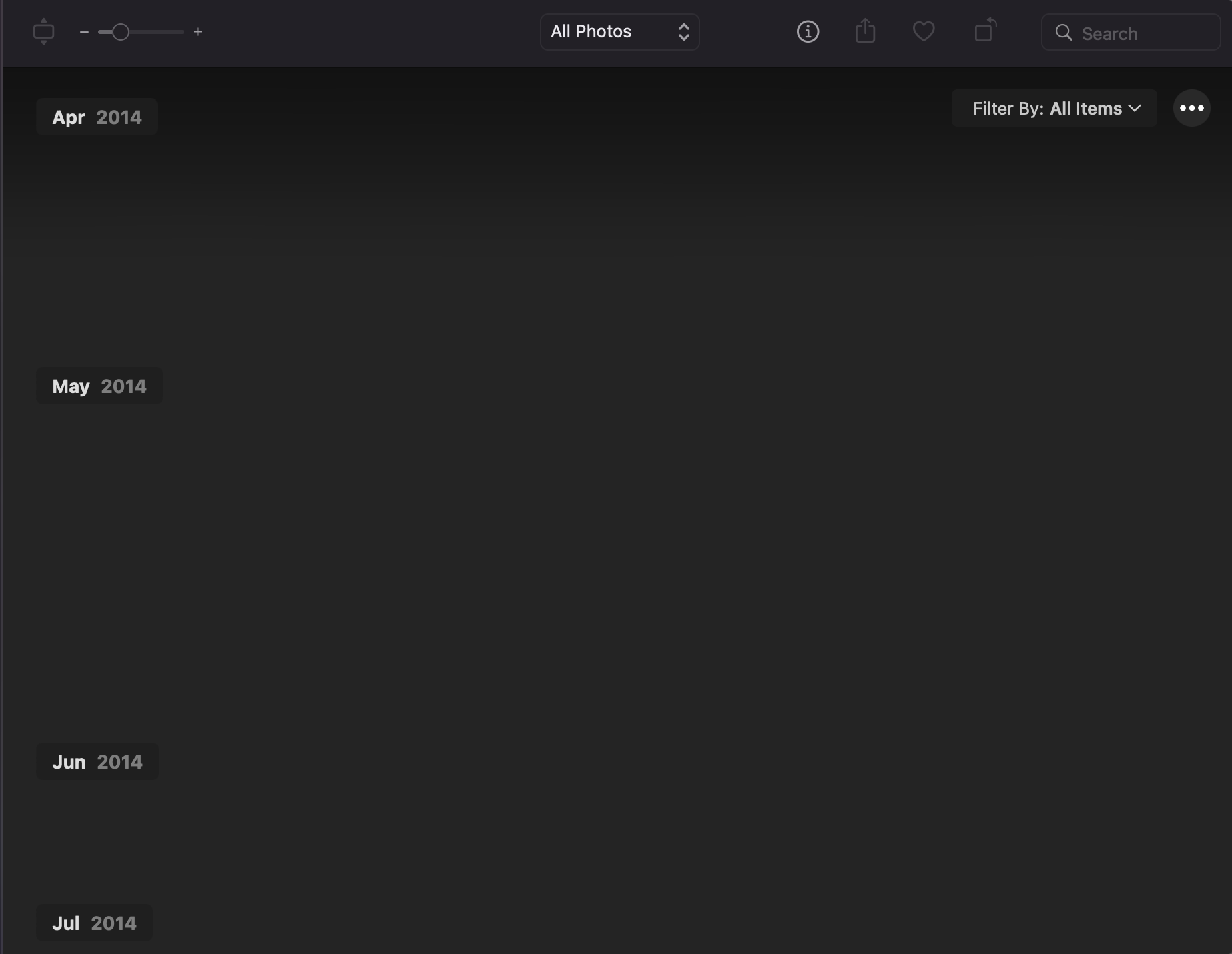

Okay! After a few days of using it after installing using instructions from both @chris1111 and @macpro_mid2014 , it's working flawlessly and most things are working well! For the sleep mode/hibernation issue I found this post on reddit and one of the comments recommended checking the sleep setting and modifying it. And so far no issues, loss of battery time, or draining with the sleep or battery! Thanks again you guys!
The only weird thing is that I can't fully zoom out to view all my photos, see attached, below. At that zoom level, my pictures don't appear at all, my screen just looks greyed out, any ideas?
Mine works well! Zoom In/Out without any issue.

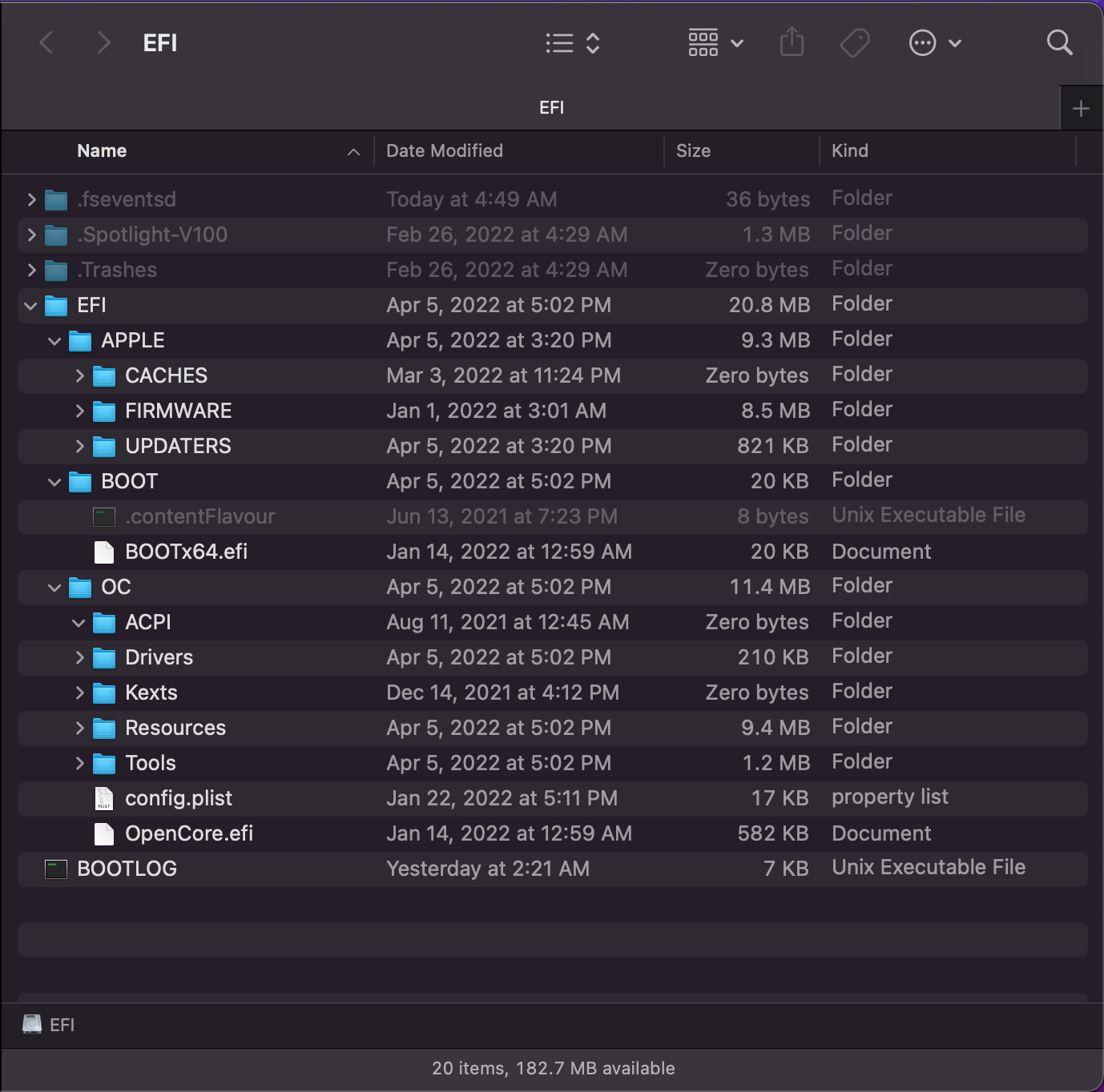

I just want to say Thanks that this forum did the job done on mine's macbook pro late 2013 too.
i read all 8 pages til now the entire posts on this thread to find out what is going on.
because at fist i cant get it done of course by my miss understood.
i mistakenly copy the contents of EFI folder to EFI partition.
after 6 hours of trying with no success i so close to give it up.
but suddenly i understand i must copy the entire EFI folder into EFI partition.
so at last the the EFI partition also must have EFI folder on it to get it worked.
sorry its my bad maybe because when I'm doing this, i was too tired or in sleepy mood.
its around 3 to 9 am midnight to early morning without night sleep when I'm doing this. 😵‍💫
i created screenshot of files Tree that must in EFI Partition for those wacky nerds such me.
because it has the same folder name with the partition label i had confused with that.
when the software update detects 12.3.1 it has applies it without any problems too.
again want to thanks you all, @chris1111 @macpro_mid2014 and the OC community for this make it happened to us.
hope we also see it for after on and so next after next macOS releases too.

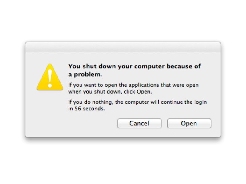

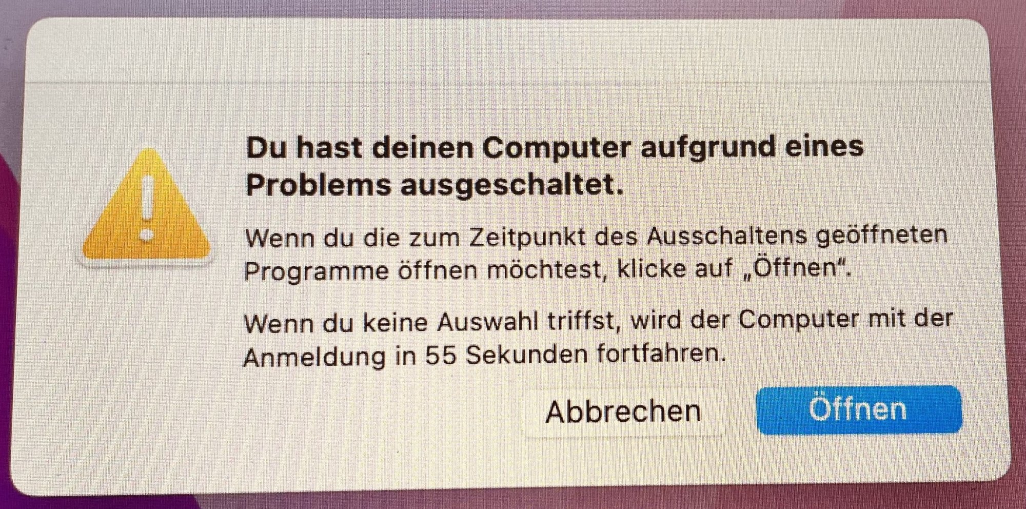

No problem. I looked up the picture in English. I did NVRAM reset. Start with CMD+ATL+P+R and SHIFT+CTRL+Power. Problem occurs with every restart or after shutdown.
