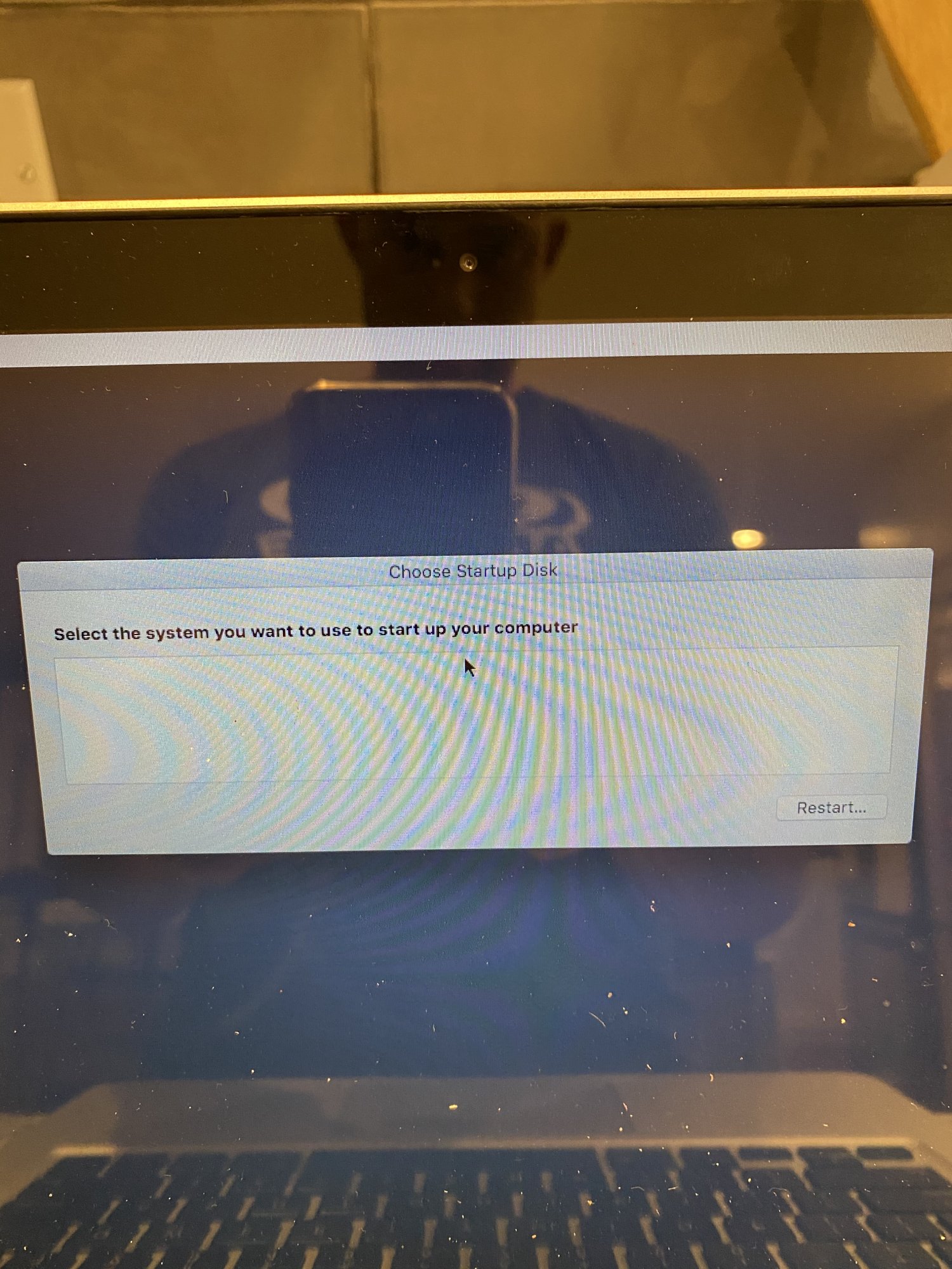

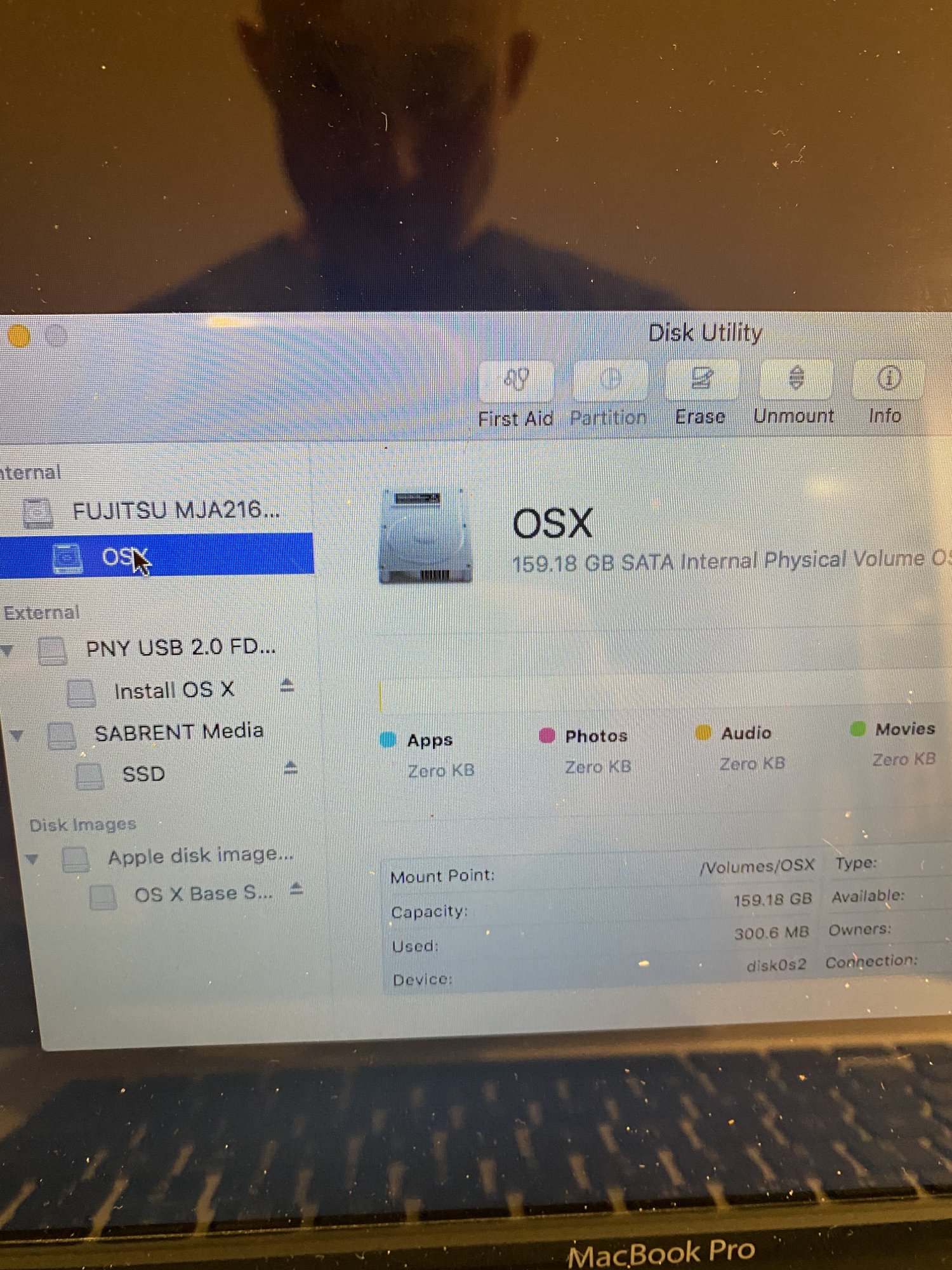

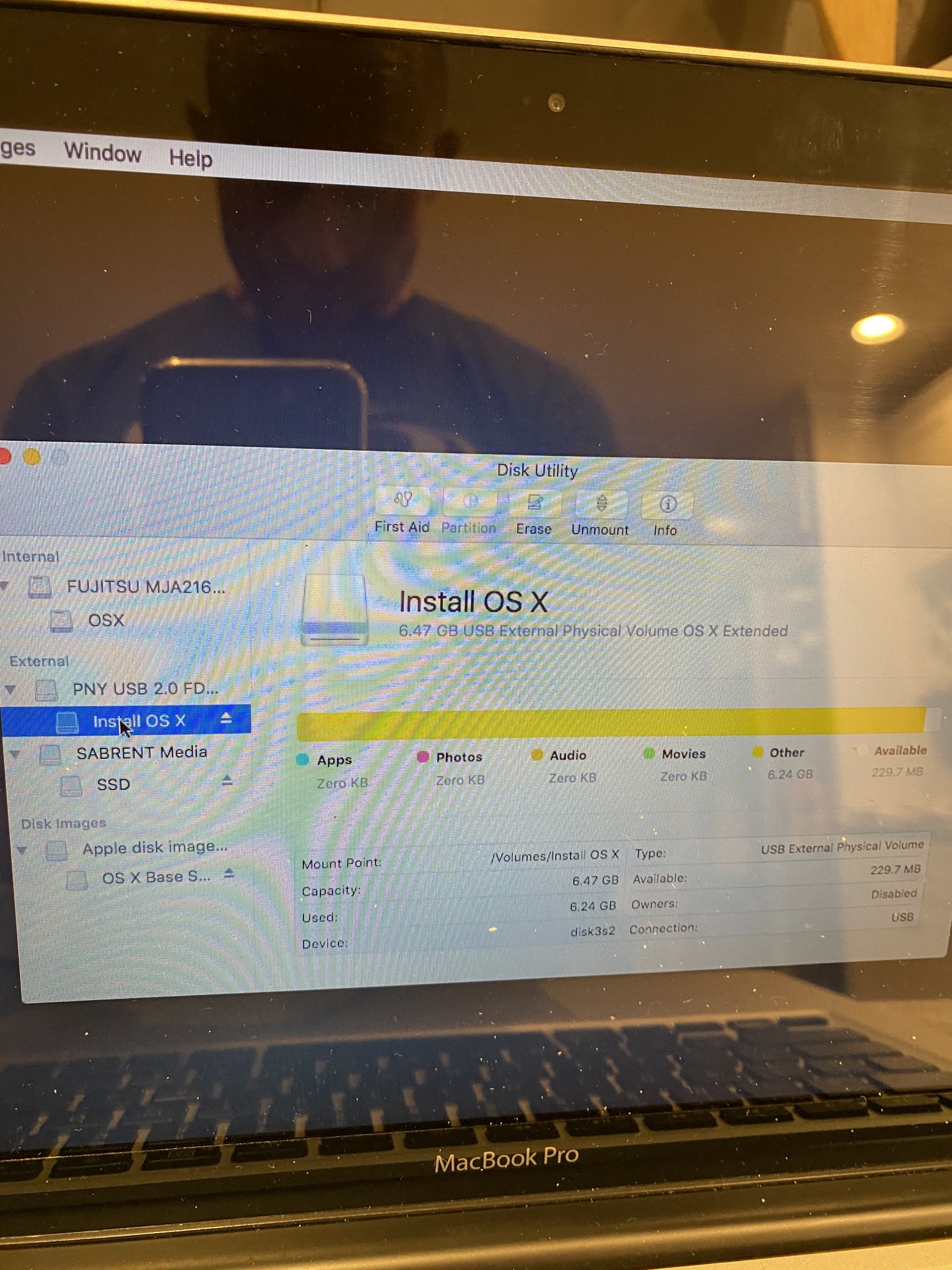

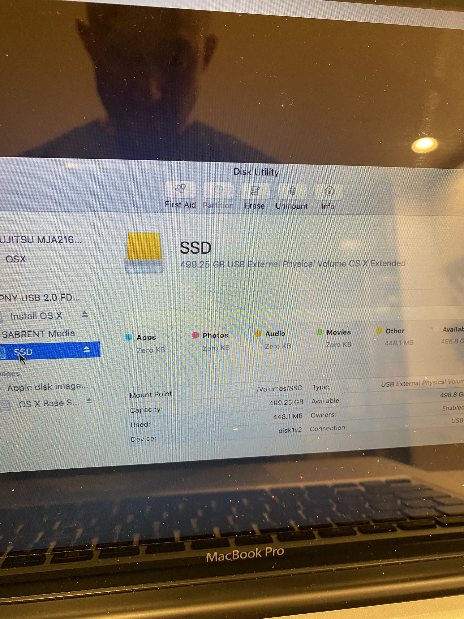

I finally got El Capitan onto a bootable USB. Now I cannot load it onto any hard drive. I have successfully partitioned the new SSD hard drive as well as the jump drive with the OS X. I have the old hard drive but it won't recognize my USB Installer OR my New SSD that's also plugged into another USB port.
Any suggestions??

If you have the installer on that PNY flash drive, leave that inserted, then reboot, holding the Option key. Does the "OS X Install" appear as a choice in that boot-picker screen?
Give it some time to appear. Unplug that flash drive, wait a few seconds, then plug back in. Does it appear then?
If not, then you either have a faulty flash drive, or you have not used the correct method to make the installer bootable.
What process (or which app) did you use to make that bootable installer?

I tried it using a windows computer. Just checked and it was OS X extended but not journaled. Could this be the issue?
Neither apps you provided would work for me unfortunately using my Apple MacBook Air.
Even if your OS X installer is correctly made, it won't boot a non-Apple PC, not from a default (un-modified) OS X bootable installer.
Journaled (or not) is not an issue, and does not affect booting in any way.
If your flash drive does not show up as a bootable device, then either your flash drive is faulty, or the software on your flash drive is not installed properly (and is NOT set up as a bootable device). THAT'S your goal, reachable through a proper setup of the terminal commands.
Best way to do this, is using the terminal -- using the commands that Apple provides. The terminal method will work; I make bootable installers often, several times per week (really!)
I have already posted the method that I use (and is a method that results in a bootable installer), in fact, I think I have posted it with two different explanations for the steps that I used. (refer to posts #27, and #36). I made a new bootable installer, just as a quick test to make sure the steps actually work. Try it one more time (!)
It worked 🙂. I think the problem is I need to set the date back to before 2016 since El Cap expired in 2016, correct.
So terminal: date 0101101015
date month/day/time/year in two digits
This may solve the issue of the installer not working half way through the install process?
My 2nd big issue: the new SSD does not show up as a device to boot up- is this because it not only has nothing on it, but that I need to internally install it, or should it still show as a start up? I am using the Sabrent device.
The SSD cannot be a boot device, unless it has a bootable operating system.
After you install a system, it should show up as a boot choice (assuming that the install is complete, and that the SSD is working
Can I load the USB into the blank SSD drive using Sabrent or should I install it internally into the MacBook then try to load the bootable USB to the SSD internally?
No difference in the install, either internal, or external. You just have to select that SSD as the destination for the system install. The external install will be slower, of course, because of the USB 2.0 speed, but won't make any difference after installing the SSD internally.
