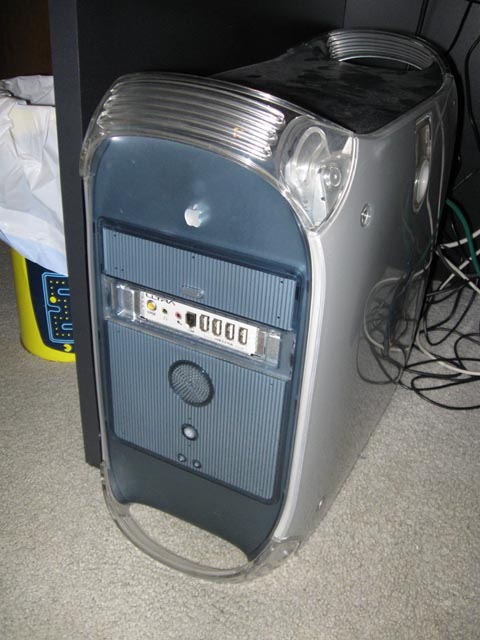

I've included a picture of the PowerMac from the front, showing the added internal USB/Firewire Hub.

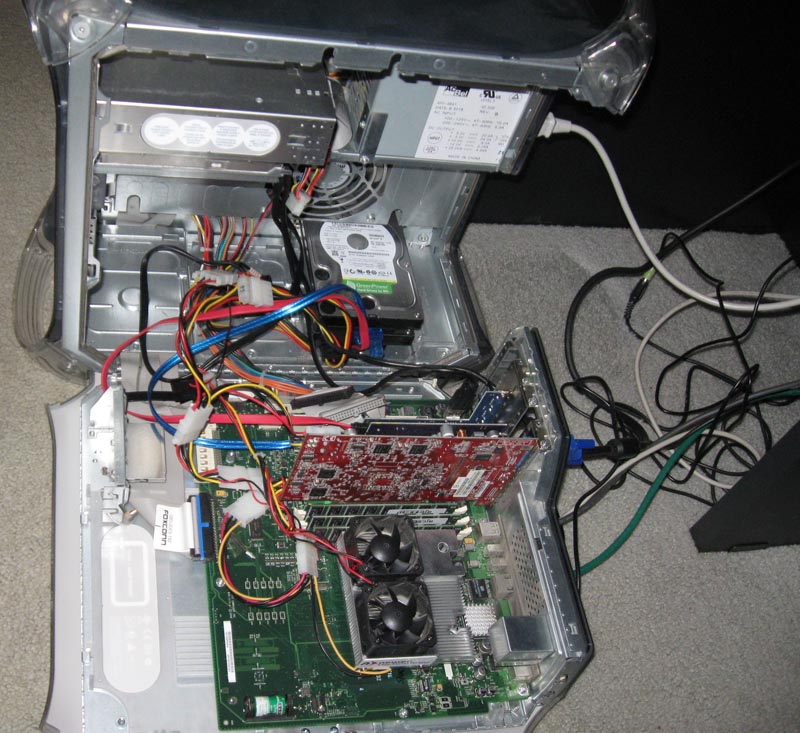

Here's a picture of the upgraded machine with its side door open. Note the two internal 500GB Sata drives, NewerTech CPU/Heatsink/Fans, Radeon 9800 Pro card and the Sata and USB cards. It's populated with the maximum 1.5GB of low-latency 133MHz ram. The CD-RW drive was replaced with an 18X Pioneer DVD-RW drive as well (can't really see it).
