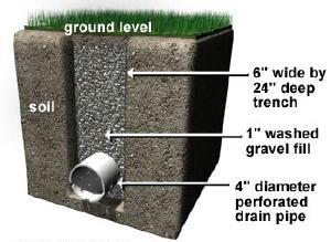

at the very least, use a "sock" around the pipe. If you prefer to go the extra mile, surround the pipe with gravel, and surround the gravel with landscape fabric.

I did this for a run of about 50' in my back yard. But, the trench I made was 12" wide (which is overkill.)
- Rent a trencher from Home Depot. Works like a charm.
- Call a stone company and have stone delivered in bulk instead of buying it by the bag.
- If you can, leave the trench open at the top, it will work better.
- The perforations do down.
- Make sure to put 2-3" of stone down before you lay the pipe down.
- I would put in a clean out (I didn't and am regretting it.)
Mine cost about $500 total for the job and with two guys, two shovels, a wheel barrow, and a trencher, I was done in a day and a half.
Well worth doing it yourself.

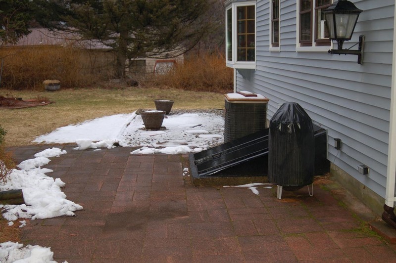

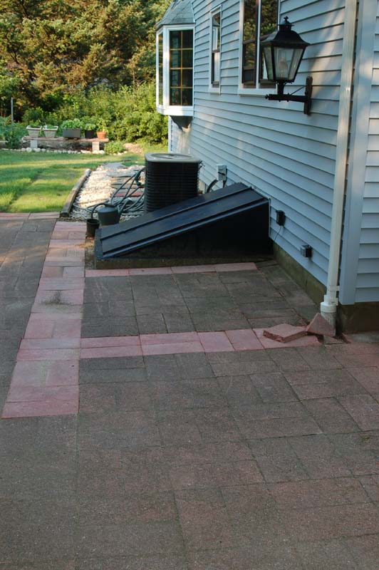

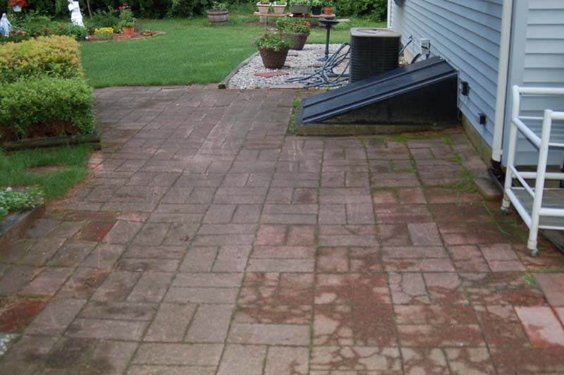

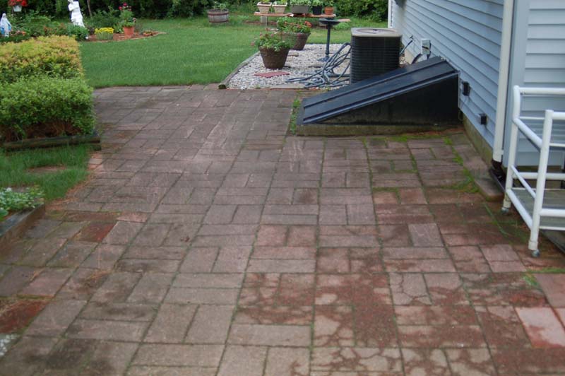

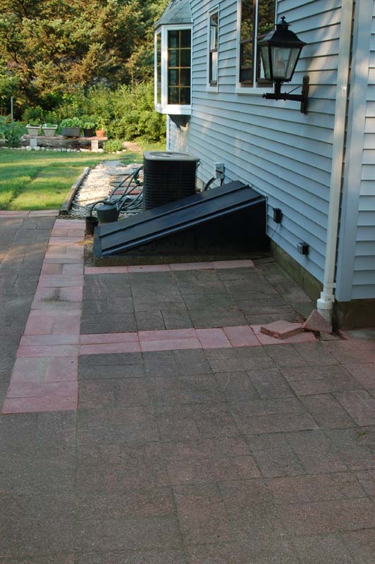

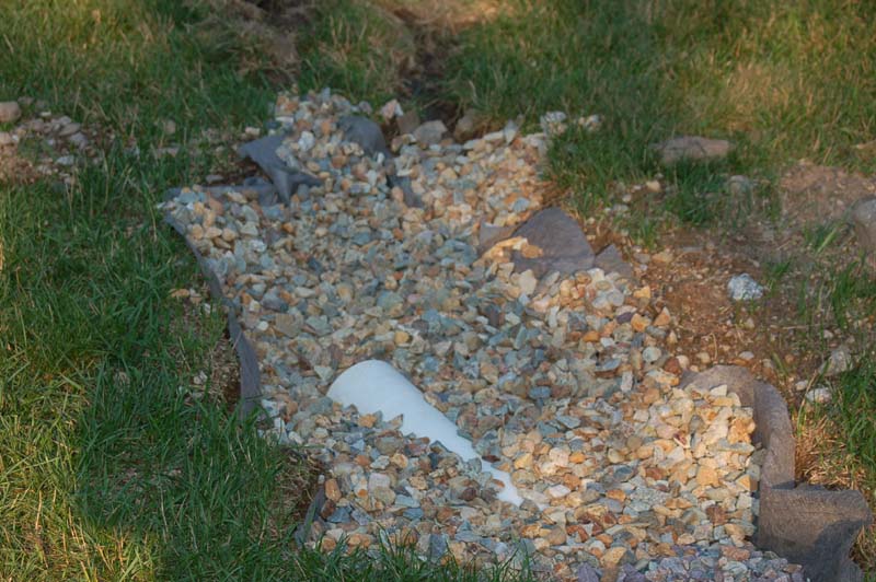

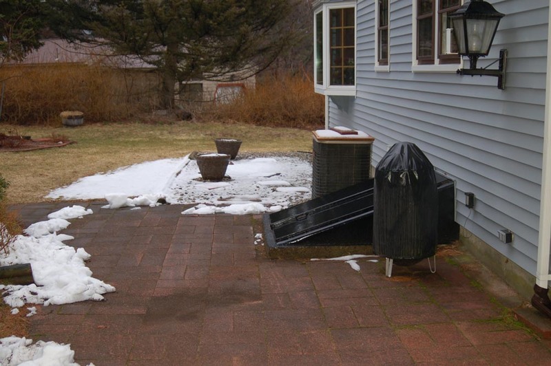

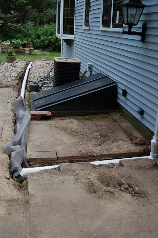

Since I started the thread,I thought that I would post a follow up..I went through and installed the drain system.I tied my downspouts into the drain using solid pipe,drain is perf pipe.I lined the trench with landscape fabric,put a layer of crushed stone under the pipe and on top of it. I dug down about one foot and followed the natural slope of my land. I'm just trying to eliminate surface water and pooling on my patio..One foot deep was enough..The pipe comes to daylight and empties into a swale that runs along the side of my house. We had a couple torrential rains the last couple days and it worked great..I couldn't believe the amount of water that was flowing out of it. Patio pavers will be replaced and the existing ones are temporary..Here are some pics.
