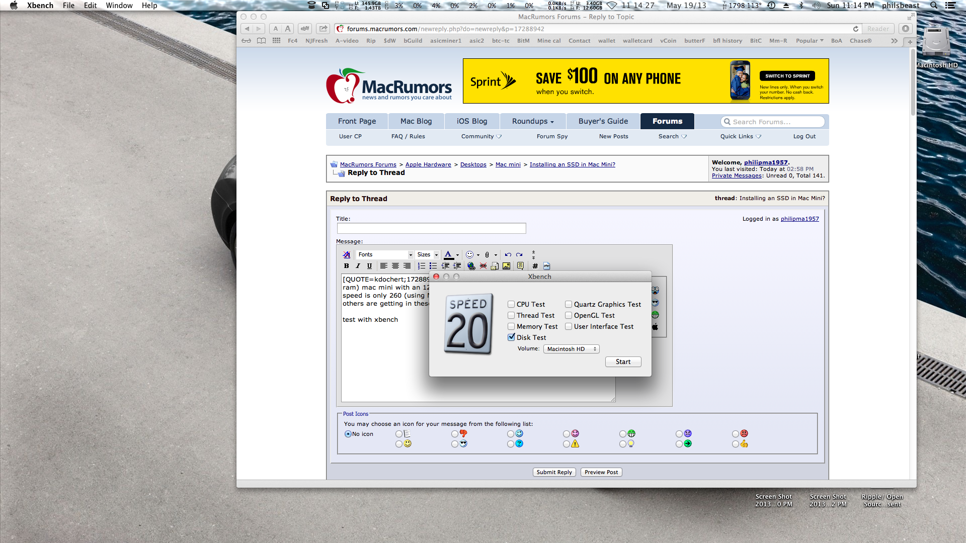

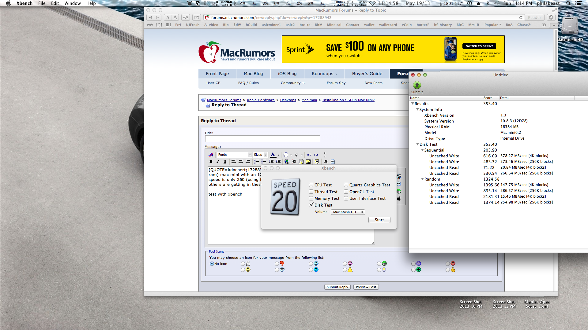

test with xbench
http://xbench.com/
the results are for my 1.96gb fusion drive with a crucial m500 960gb ssd and a hgst travelstar 7200 rpm
take a screen shot of your results and post. you should beat my results with ease

Xbench results
Here are the xbench results for the Samsung 128 Gb 840 pro installed in a 2011 base model Mac Mini with 8Gb ram:
Results 517.49
System Info
Xbench Version 1.3
System Version 10.8.3 (12D78)
Physical RAM 8192 MB
Model Macmini5,1
Drive Type Samsung SSD 840 PRO Series
Disk Test 517.49
Sequential 310.82
Uncached Write 703.65 432.03 MB/sec [4K blocks]
Uncached Write 494.73 279.92 MB/sec [256K blocks]
Uncached Read 127.23 37.23 MB/sec [4K blocks]
Uncached Read 638.30 320.81 MB/sec [256K blocks]
Random 1544.37
Uncached Write 2088.40 221.08 MB/sec [4K blocks]
Uncached Write 887.00 283.96 MB/sec [256K blocks]
Uncached Read 3009.90 21.33 MB/sec [4K blocks]
Uncached Read 1534.70 284.77 MB/sec [256K blocks]
Is this about right? I tried to run blackmagic also but it said I didn't have write access?
