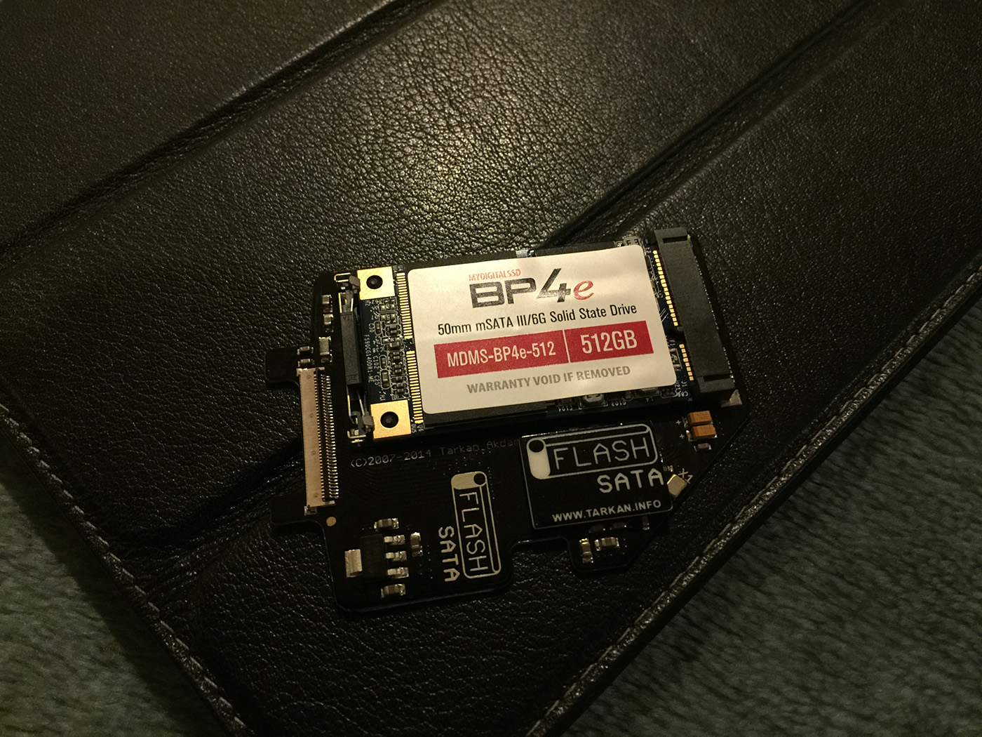

Just got the mSata drive in.

You should go to www.tarkan.info as his adapters seem to be the ones that everyone is using and having the best success with. Apparently the current ones that he sells do not have power drain issues when doing either CF or CF to SDXC. However, mSATA does have a power drain issue.

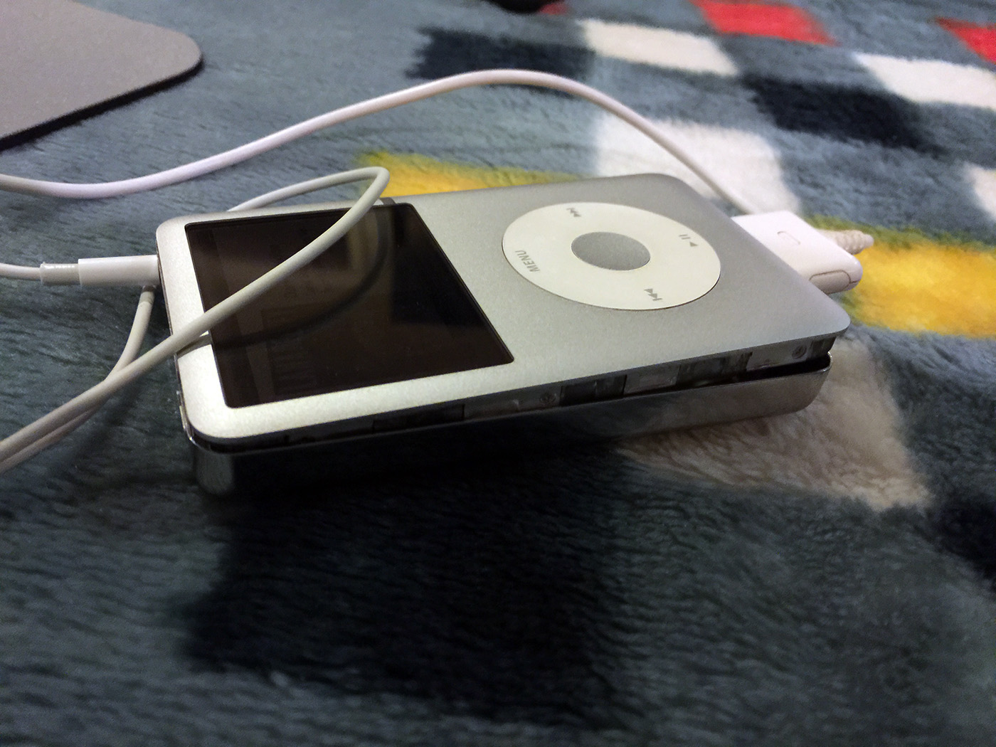

I've opened two. The first one was a breeze. No deformations, and it looked perfect. The second one didn't open as nice. Note that this was before the idea of swapping the hard drive for a flash card.
Can you 'un-deform' a deformed back? I was never able to get it 'perfect'. It was the video classic, and the plastic top had a lip over the metal back, and the metal back had a stiffer ring around it that was the main thing that I couldn't seem to get to a good position.
It's not hard to deform the edge of the back, but the first one I did was a far newer model, so if you are careful, and don't pry very far, it should be fine.

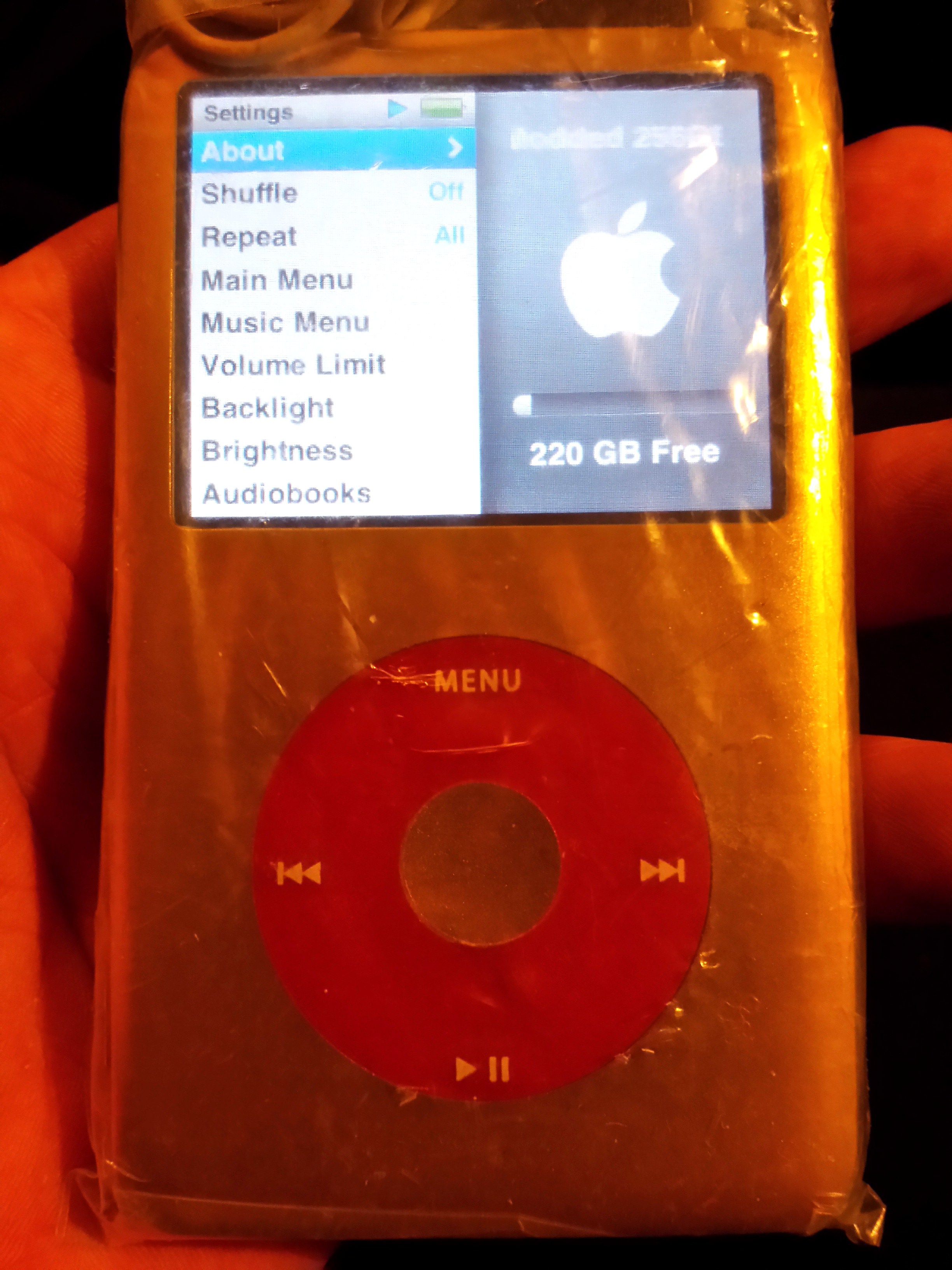

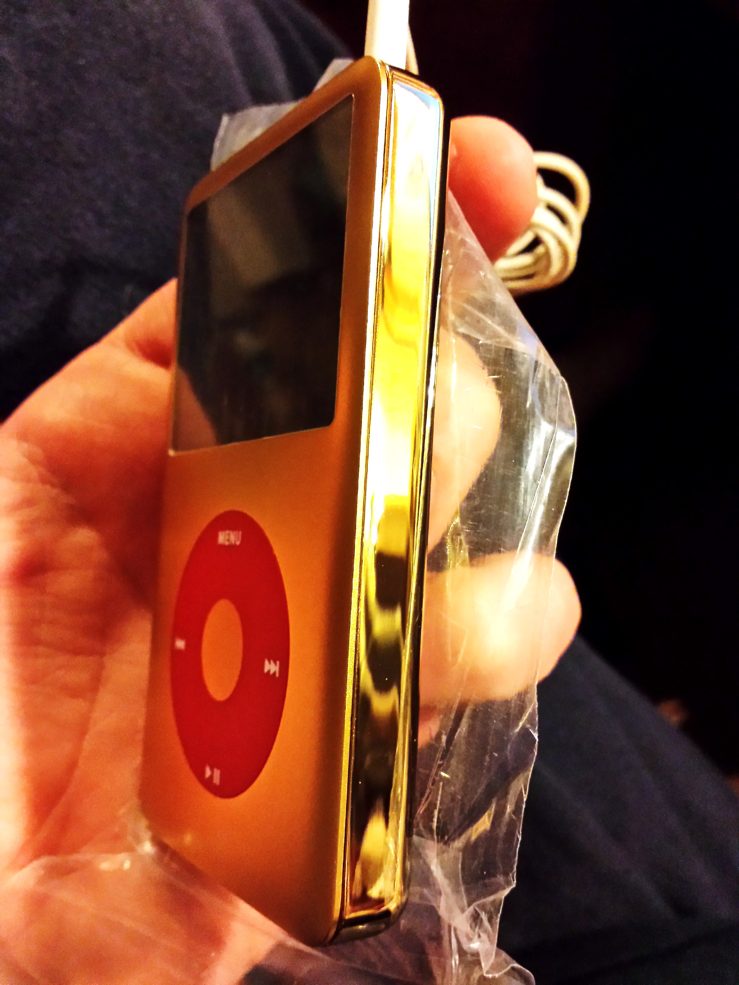

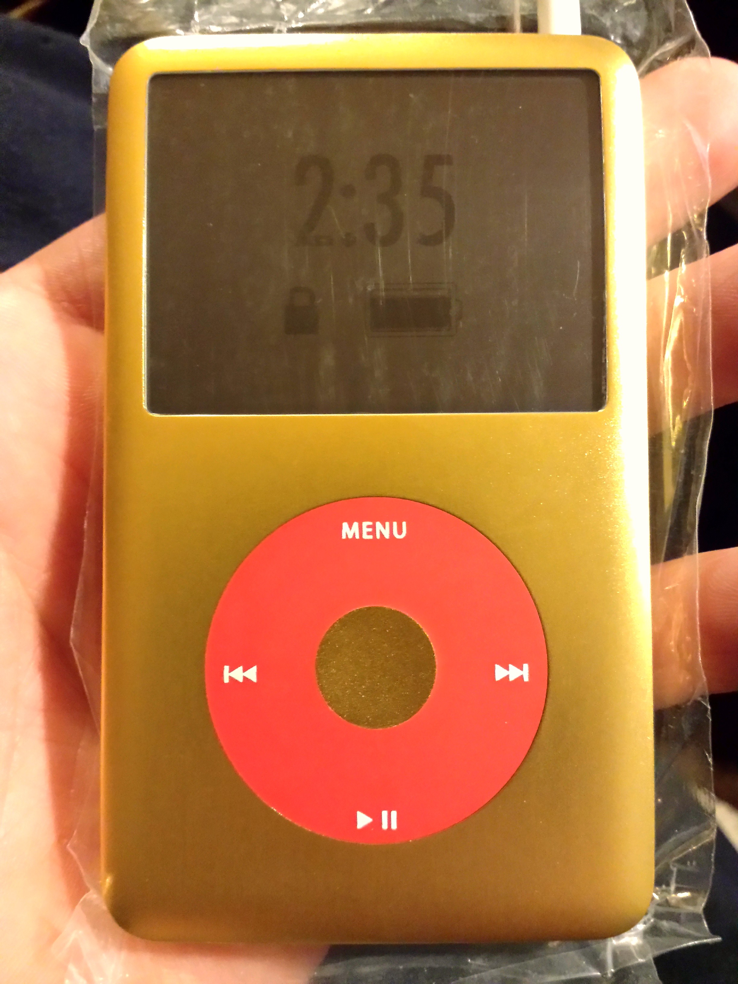

Ipod Classic 7th gen Gold U2 256gb SSD mod
I'm looking at my black 160G classic, and can imagine some issues opening it. It's also the thin back, so I am hoping to get a few more years out of it before having to risk opening it.
I'd either research the best ways and tools to open it, or perhaps have someone else do it that has a lot more experience opening them do it.
Patience is probably the word. I was impatient getting the second one open, and it showed.

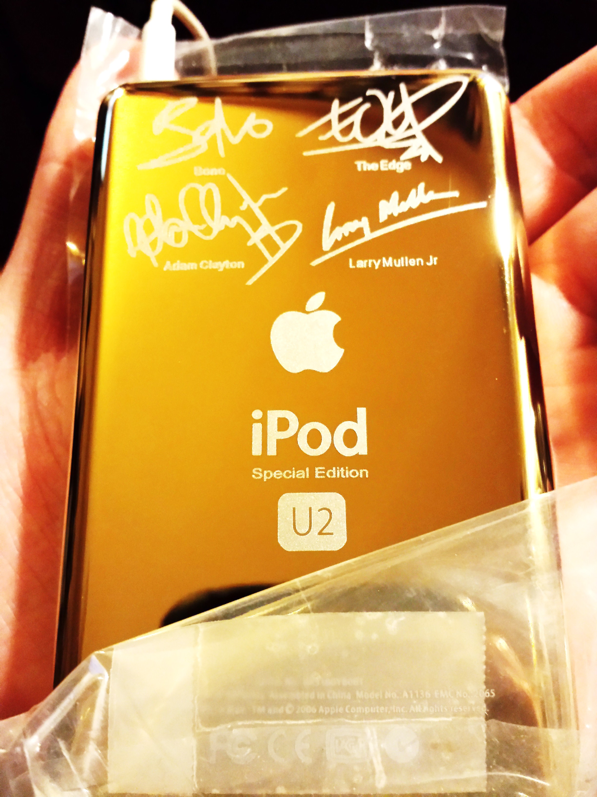

Hey Pinky,
You can always let me know about your 7th gen if you ever
wanted to upgrade/mod it. Let me know and we can go from
there.
Check this ipod out:
https://www.flickr.com/photos/131371374@N08/
This ipod was originally a 7th gen 160gb thin back classic.
It's now a 7G Ipod Classic 256GB mod. (I could have
went the 512GB or 1TB route, but opted for the 256gb
for the time being with this one.)
I did this mod with a gold faceplate, red clickwheel,
gold center button, thick gold U2 back plate, a 7.5G
motherboard (7th gen thin 160gb board), a Tarkan
SSD iFlash adapter, Samsung PM851 256GB SSD,
and lastly a 1900mah battery, (which is why I went
with the thick back plate with this one. With this
battery it's a tight fit, but pretty much a perfect
fit at that.)
Ipod Classic 7th gen 256gb SSD Mod - Gold U2 Version
Ok, just trying to figure out a way to imbed
pics right into this thread. Heads up on it ?
Ahhh, ok, I'm still a fast learner 🙂
here you go for anybody interested.
Hit me up with any questions you may have.
I'd be more than happy to help you out if you'd like.

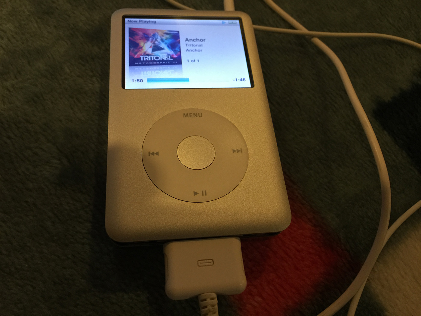

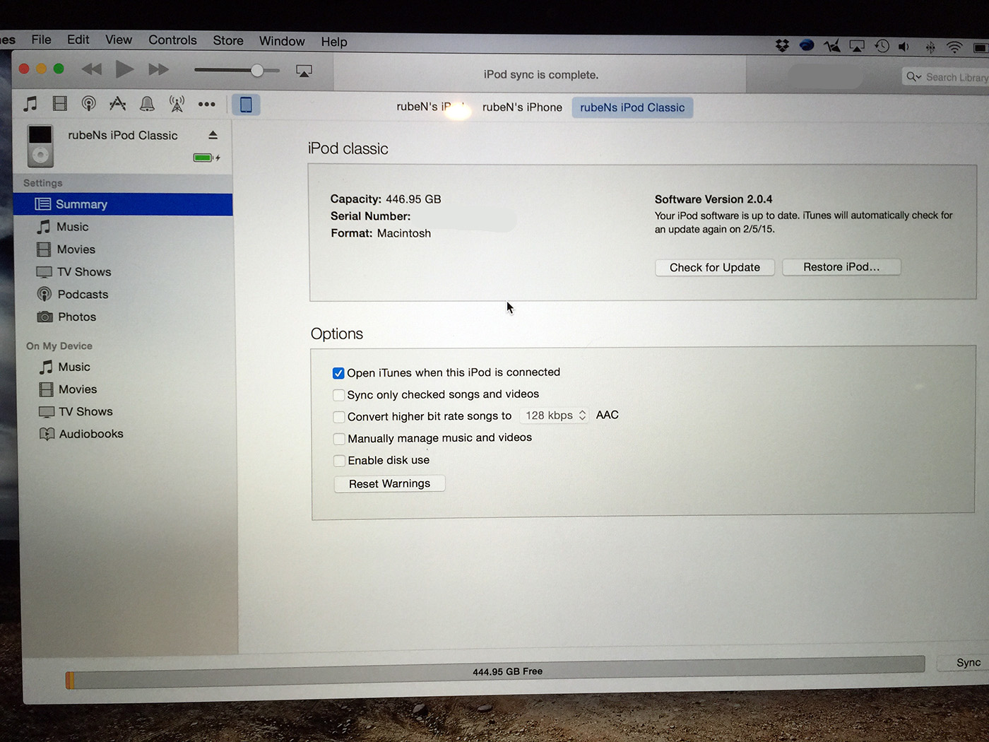

Alright, so as a test, I made my first modded iPod classic.
For this one, I used a used 120GB iPod classic that I bought on eBay. (Given that the 2007 iPod classics used a different color for the black models than the 2008 120GB and the 2009 160GB classics, I'm only going to be working with silver iPod classics for simplicity's sake). I bought a custom "128GB" backing and I even got the eBay seller to print the correct serial number on the back. I used Tarkan's adapters as well as a PNY 128GB SDXC card (he highly recommends their 256GB card, so I figured that getting 128GB would be fine for this, given that the 2008 120GB thin classics will only see up to 128GB on the Apple firmware). I did ruin the back as well as the front; again, I bought a replacement backing for this occasion as well as a replacement front.
I had to format the iPod in Windows as NTFS. For some reason, Disk Utility doesn't work well here. Then I restored using iTunes for Windows, which then makes it restore-able for Mac via iTunes for OS X. Badda-Bing. 128GB HDD-less iPod classic. Will report later when I get music going on it.
