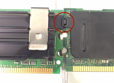

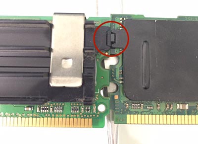

@Macschrauber, what did you do with the locks located on the sides? They are of different widths.
I think it's not safe to cut the board.
The only way I see is to bend up locks and apply heatsinks without using locks.
