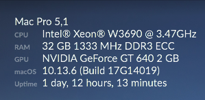

Cheers All,
I just need to find a Metal GPU now, at a 'reasonable' price - f
For what it's worth I use the Nvidia GT 640, I have both a 1GB and the 2GB versions, both work well for my purposes.
Reactions: oztig
