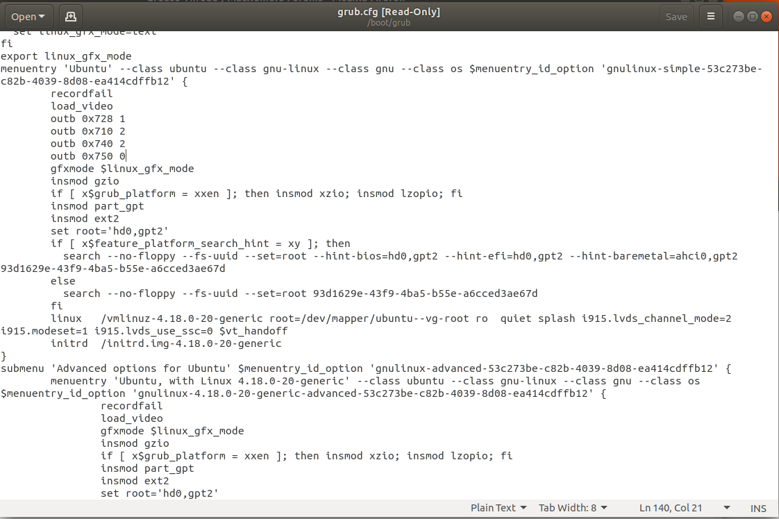

When GUI comes up, I open the Files app> Other Locations >Computer> Boot> Grub, which gave me access to the grub.cfg file. I then opened a Terminal and typed:
Code:
sudo chmod 777
then dragged the grub.cfg file into the open Terminal window.
This changes the permissions of the grub.cfg file to read/write.
I then opened the grub file in text editor, and looked for the [menuentry 'ubuntu'] line. This is the topmost entry in the grub menu of the installed Ubuntu. Underneath this is the same [load_video] entry.
Take note, the file in this case is already 'Read-Only' as I have already tested rebooting to see if it works. To change the permission back to 'Read-Ony' I entered
Code:
sudo chmod 444
In the Terminal window and dragged the grub.cfg grub file and got this:
And that's it. My MBP now boots directly into Ubuntu. The screen does turn white (defaault Mac startup), then green (the AMD GPU activating), then black (the AMD GPU turning off). I've actually composed this thread using the same MBP with Ubuntu.

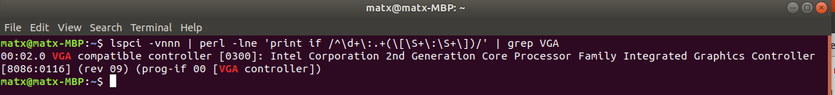

I checked the active GPU with
Code:
lspci -vnnn | perl -lne 'print if /^\d+\:.+(\[\S+\:\S+\])/' | grep VGA
Ain't she a thing of Beauty?

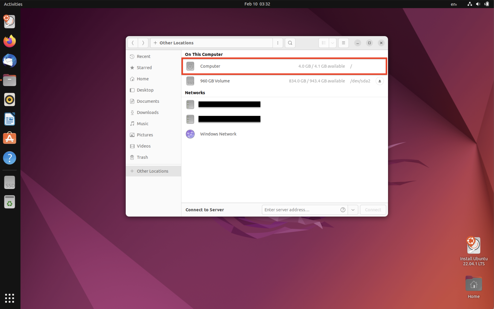

I encountered this issue of the gpu error resurfacing after continued usage but this happened with a reboot, something I've done a number of times since the original fix without issue.
However I was able to follow the guide again and get the machine working again from the live usb and without reinstalling the os.
To note: Something interesting occurred and caused the above guide to not work. When selecting the 'Other Locations' in the file explorer application, I selected the hard drive instead of 'Computer' and followed the path to the grub.cfg file. Doing this did not fix the issue but going back through the guide and taking care to select the 'Computer' location did. See the highlighted in red portion for the location I followed that did work.
I suspect that this has something to with how the partitions on the machine are set up but that is way above my head.
