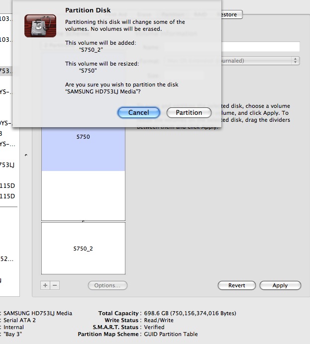

You're all missing the point of Bootcamp
Sure, you can use Disk Utility to repartition the drive into two partitions, but you would be detroying the Mac partition already on there. Boot Camp resizes the OS X partition and adds a second partition to the drive. You can't do that under Disk Utility without destroying the existing OS X partition.
Actually that is not really the case (if you are using Leopard anyway)- since non-destructive partitioning works fine in Leopard's Disk Utility. I have included a shot of a repartitioning in progress to show that resizing an existing partition (by dragging the bottom right corner up to shrink it) and then adding a new partition by clicking the "+" at the bottom of the screen will not result in any data loss. In the example I shrunk the only partition on the disk ("S750") then clicked the plus sign to add a 2nd partition ("S750_2") and you can see that the box that appears when you click "Apply" notes that "No partitions will be erased."
If you want to repartition non-destructively on a boot drive, then you need to run the Disk Utility on an installer disk to do it, but no data need be lost.
BTW- it works in reverse too- if you highlight the second partition and click "-" it will remove that partition and allow you to enlarge the remaining partition back to the full size of the volume with no data loss on it (and obviously the data on the partition you blow away will be gone). You can add or subtract any number of partitions this way and each can be formatted independently.

Not really, on Leopard you can resize the boot volume on the fly too. Done it many times.

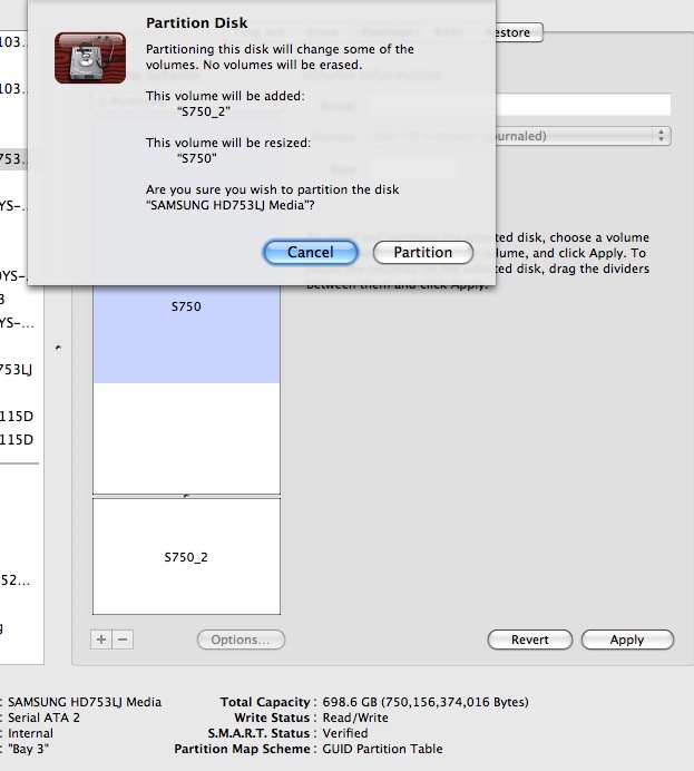

Will this non-destructive repartitioning work in 10.4 as well?
Shoot, didn't realize the thread was quite old. If anyone has the answer still, that would be great.
