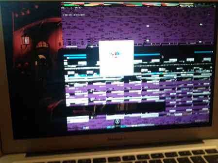

Also, my screen still sometimes scrambles when waking from full sleep.
Honestly, this sucks.
I can't believe there is still a problem this long after launch. I LOVED how quickly my 2010 11" with SL awoke.
