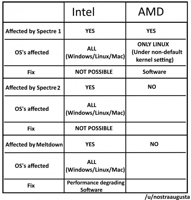

As far as I understand it, AMD CPUs are only affected by Spectre V1, but Intel CPUs affected by Spectre V1, Spectre V2 and Meltdown. All the Intel CPUs from 1st generation to 8th generation affected by this, but only old AMD Bulldozer, Piledriver CPUs are affected by Spectre V1, and only in Linux under non-default kernel settings. No Ryzen CPUs are affected by this.
Moreover, Specter V1 can be fixed through software. Specter V2 only affects Intel CPUs and cannot be fixed; it requires a hardware change.
Meltdown affects only Intel CPUs and can be patched in software, but this caused a performance hit. We now know Intel's 8th Gen CPUs experience a ~10% performance hit but older processors like Haswell will experience greater performance decreases.
I found another poster's chart to be helpful:
Hothardware has a number of informative articles, including two on the performance hit on 8th Gen Intel CPUs and on Haswell CPUs.
No, AMD processors are affected by Spectre V1 and Spectre V2. Both variants affect Ryzen.
Information comes straight from AMD's website:
http://www.amd.com/en/corporate/speculative-execution
Charts like the one you posted are, quite frankly useless and misleading.
