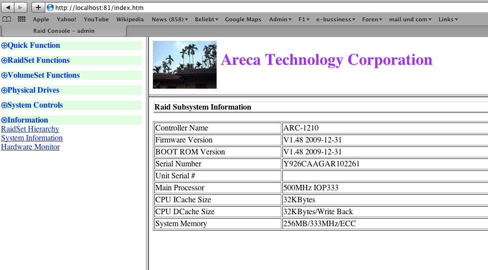

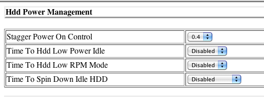

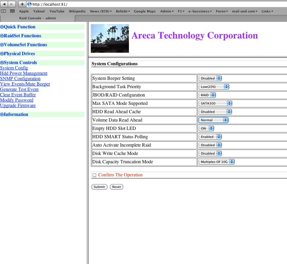

Still having problems. I thought perhaps I'm setting the Raid card with wrong parameters. Please see attachments.

Hi nano! I don't think the SSDs are at fault, but as I said I will test them individually with the Arc1210 and directly on one of the four hard drive points. Can you confirm that my Areca settings are basically ok?
From what's posted on the screen shot, Yes.
But if you've any more (not listed, as other models have multiple pages), or have since made changes, please post them so I can take a look. Even a good description would suffice, as it doesn't have to be screen shots (whatever's easiest for you). 😉
This is pretty much all I find. I'm running 10.6.4 with a clean install now. At the moment it seems to be pretty stable, but I often had crashes after some days when I started to do something important like doing a Windows backup with Winclone. Windows btw is running nicely with AHCI but with HFS drivers disabled. When I clone the OS X on a HDD I have no crashes at all.
Looks good setting wise.
