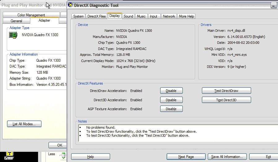

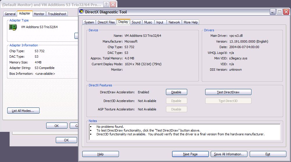

The virtual machine sees an emulated S3 Trio card, no DirectX. The first pic is the VM, the second is the host machine. Big difference.

AidenShaw said:
Sorry, arn, but you got this one wrong.
These screenshots from Windows VPC? Hmm... guess I'm wrong with the current VPC. But is there a technical limitation in preventing Windows from "taking over"?
