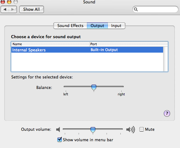

Are your sound settings correct in the System Prefs? Mine looks like this:
BTW, should the headphone jack glow red? I don't think mine does that? 😕

UPDATE: I tried to plug in another audio-out cord (iPod earbuds) into my headphone jack, and once I pulled them out, I got sound from my internal speakers. However, once I plugged back in my internal speakers, the jack still glowed red after I unplugged those... a pretty weird occurrence. After that, I tried plugging in the earbuds again and unplugging them to get sound, but the jack still would glow red when there was nothing plugged into it. Also, my sound settings doesn't list an "Internal Speakers" when my audio-out is plugged in or when it is not. Should I try to get a new audio-out cord for my speakers?
