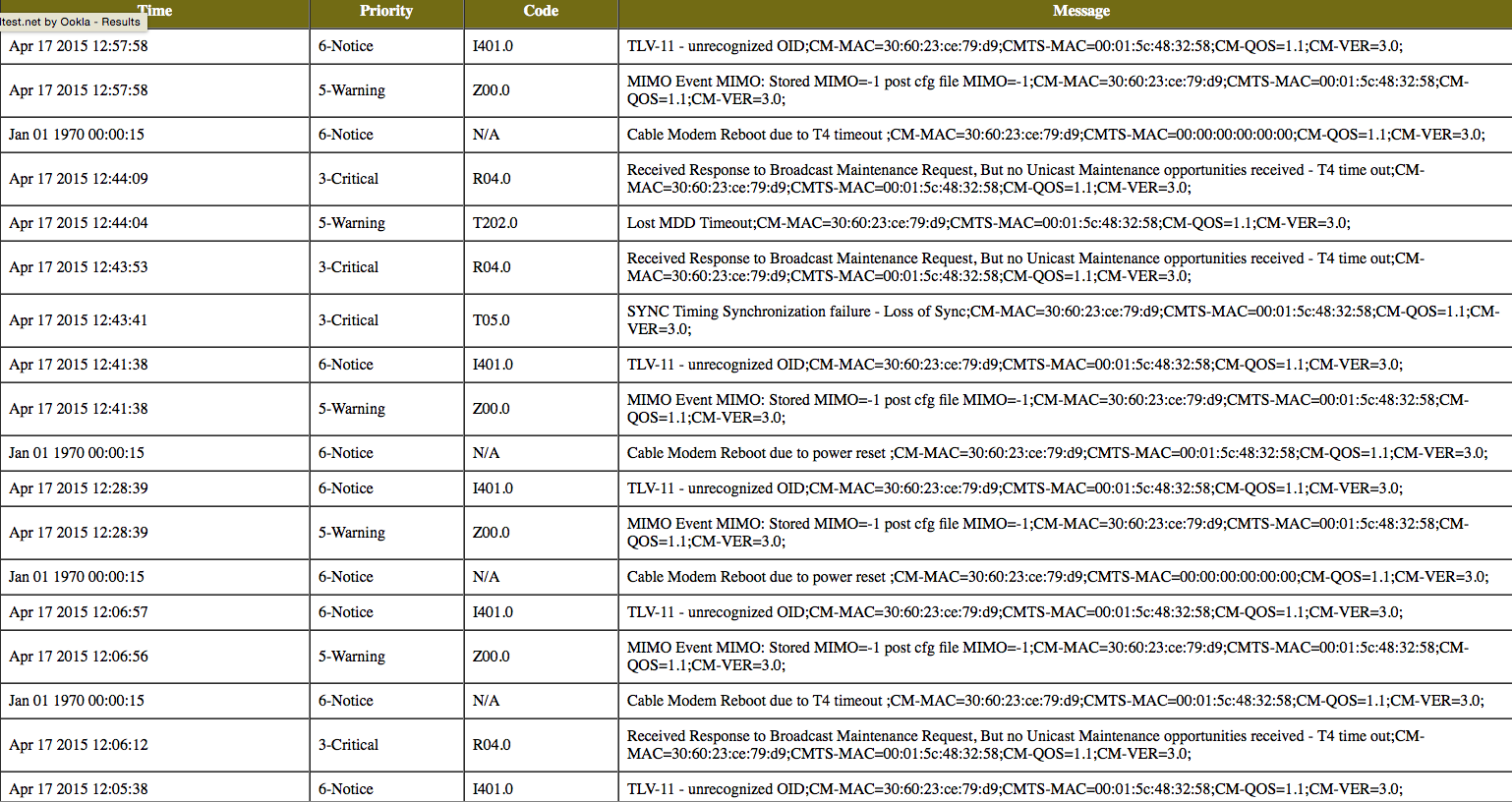

I noticed today when I had Airport Utility open because I hasn't getting a connection that it showed the internet disconnected. After a few seconds it reconnected.
What is the best way to figure out why all of a sudden we are having internet disruptions ?

Yeah... you need to get Time Warner out there to fix it. See those T4 timeout errors that are making the modem reboot, that means there is a bad connection somewhere between your cable modem and the cable headend and only Time Warner can fix it (assuming the connections in your house are good).

I went through this with them a few years ago and it took them three trips to finally find a bad connection on a junction box a couple miles away. Just tell them the log shows the modem is rebooting on its own and causing you to lose the connection. Hopefully you can get someone that knows what they are doing.
What I did was even time I lost the connection I would not the time then grab that screenshot showing what happened and that helped convince them it was on their end.

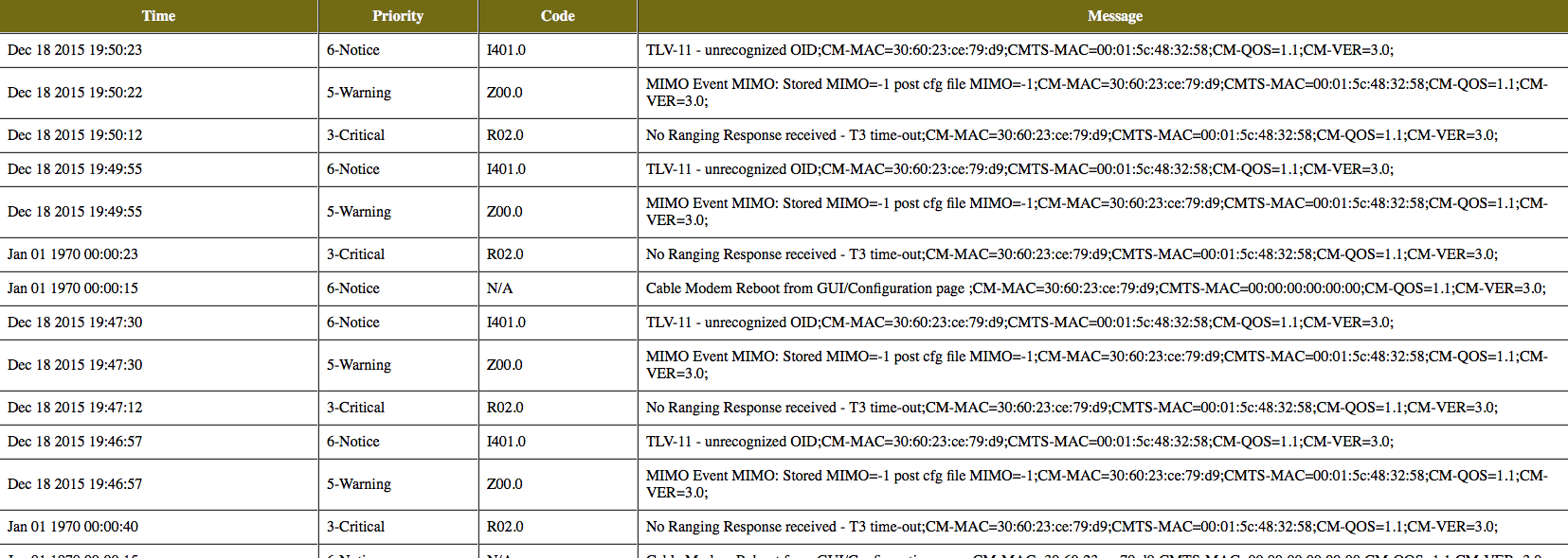

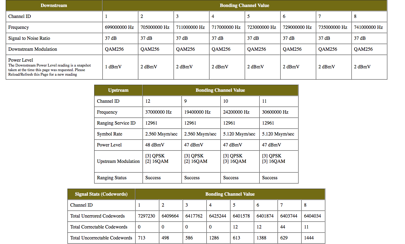

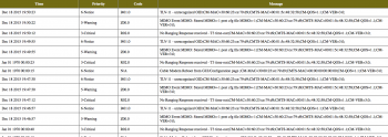

I am having problems with my internet connections again. I took a few screen shots. I was going to call Time Warner but I thought I get a few opinions on here before I call them
Looks like you are getting those same T3 timeouts as before. These are usually because of a bad connection somewhere along the line between you and the cable plant headend. Nothing much you can do yourself to fix it. I would just call your cable provider to have a service tech come out and take a look.
These symptoms are typical for the SB6141. I would get a different modem as the SB6141 has many issues with AirPorts and Netgear routers.
