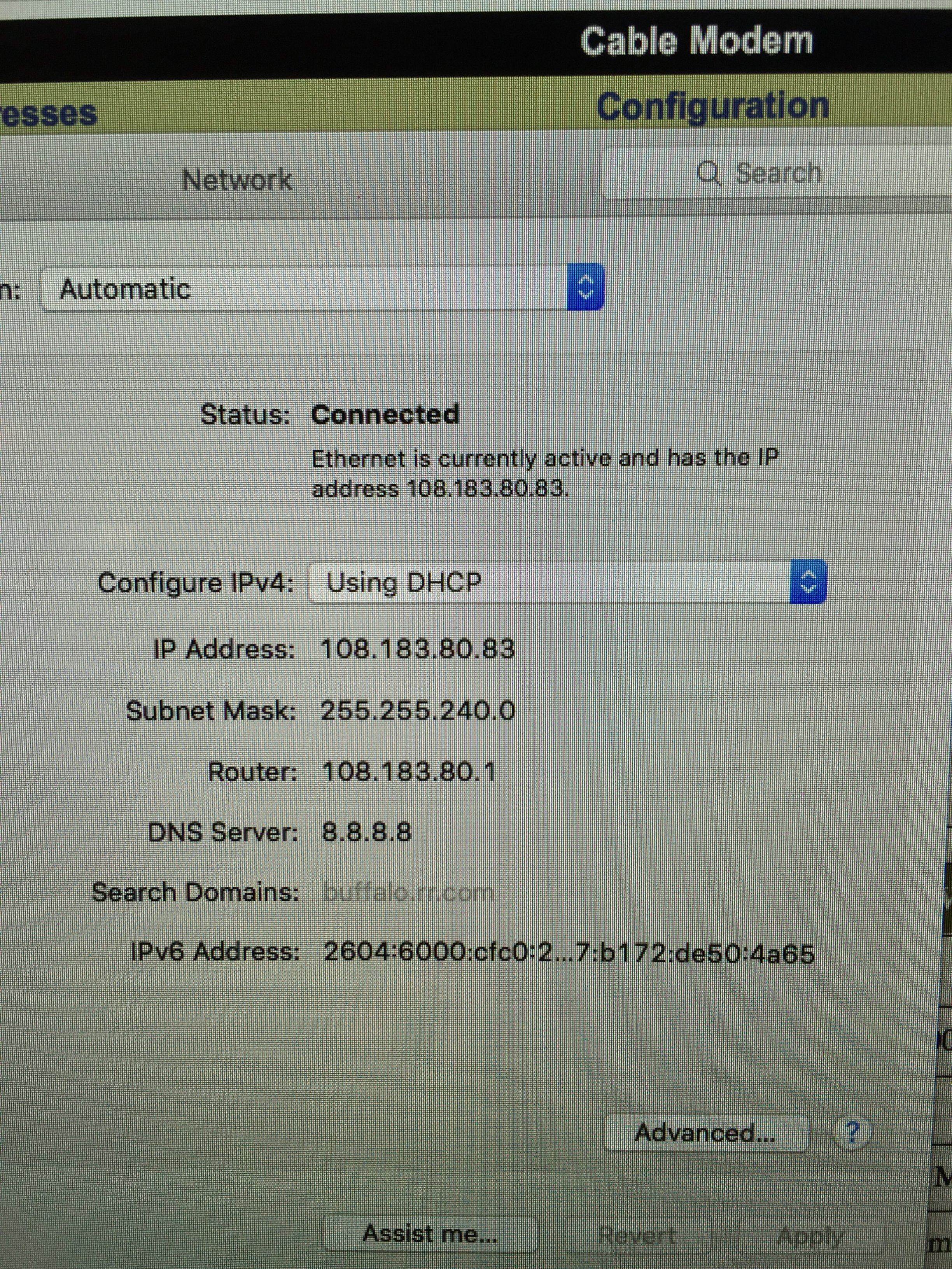

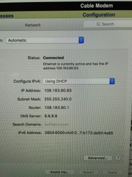

I connected my iMac with Ethernet cable directly to the sb6141 and it was very slow connecting to website. At least a minute.
I connected my wife's laptop to Ethernet cable and it connected right away.
What could be causing the issue with the iMac not connecting

Yes. I tried the iMac and it didn't work so I unplugged and tried the laptop and it worked and tried the iMac after restarting modem and still nothing.

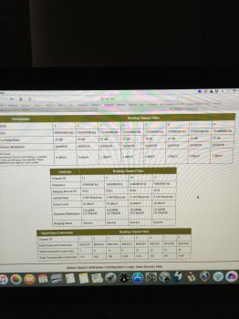

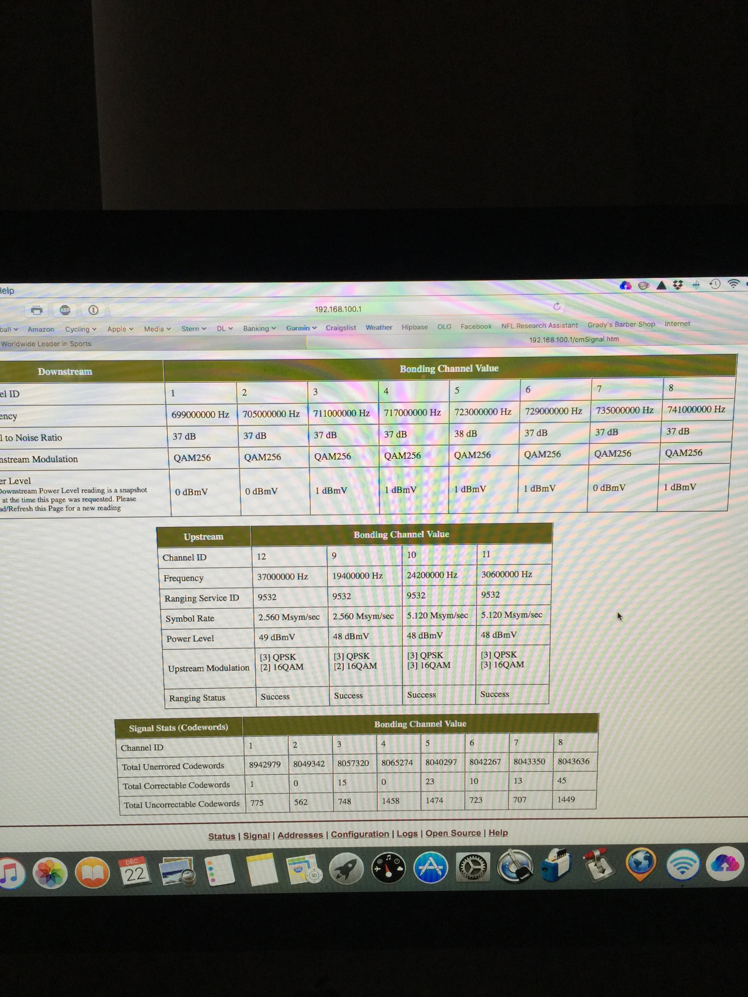

Are you using the same ethernet cable for both? If it is working with the laptop over ethernet, I can't think of any reason it would not work with the iMac.
If you use it over ethernet on the laptop for a while, does the connection ever drop? Are you still seeing those T3 errors?

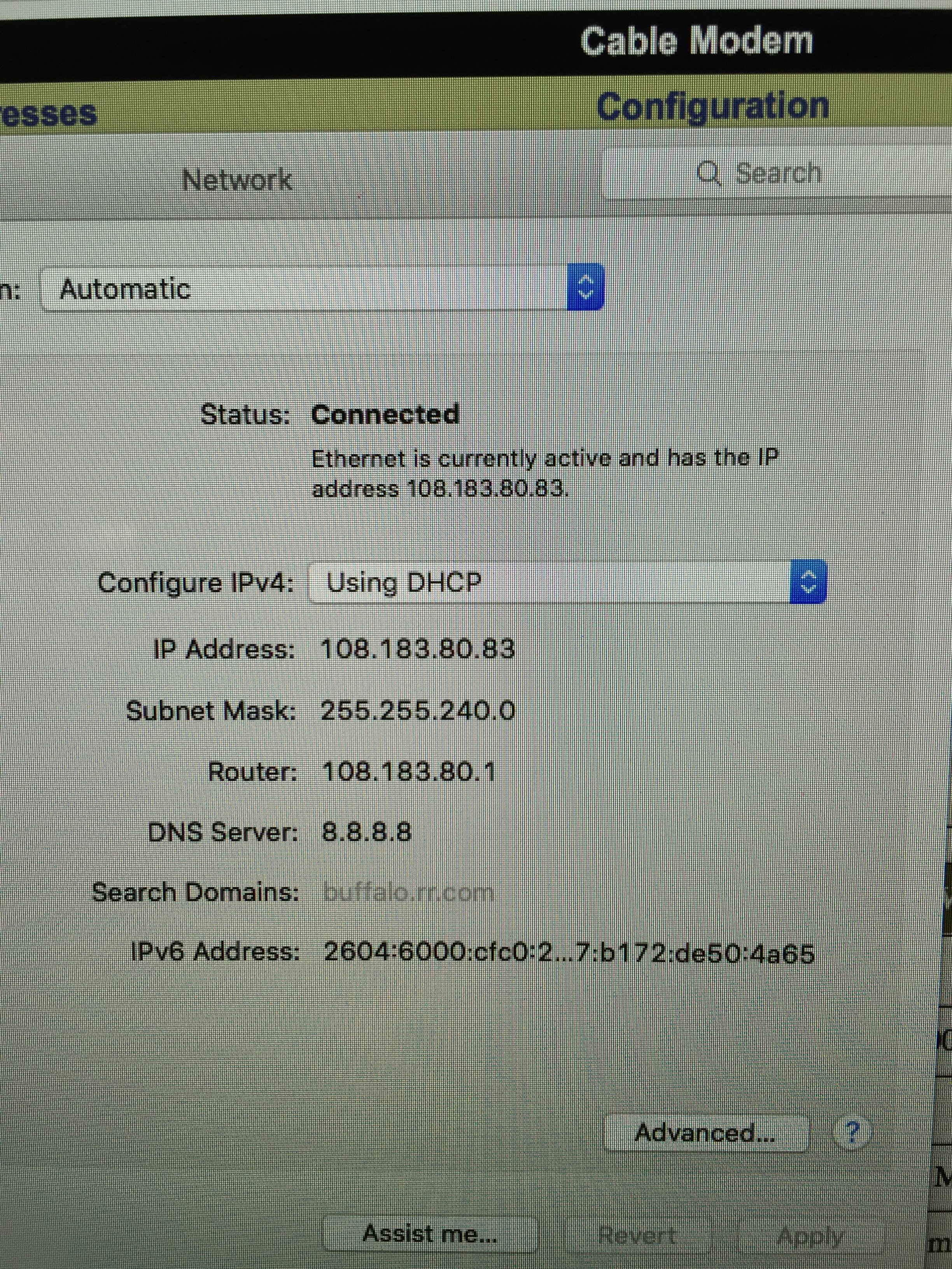

When I click on the wifi icon on the upper right side of iMac it scrolls between "Wifi: On" and "Wi-Fi: Connecting for Network"?

I'm confused... if you have removed the router and connected directly to the cable modem with an ethernet cable, the wifi would not work at all.
