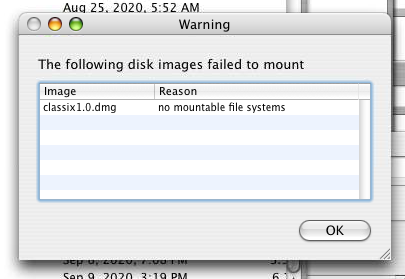

The new upload works, and consider me impressed with the theming. Of course, I did run it on a Mac that does support OS 9, but I feel my MDD is a good test environment for these sorts of things. Considering the amount of customization you're going for,
