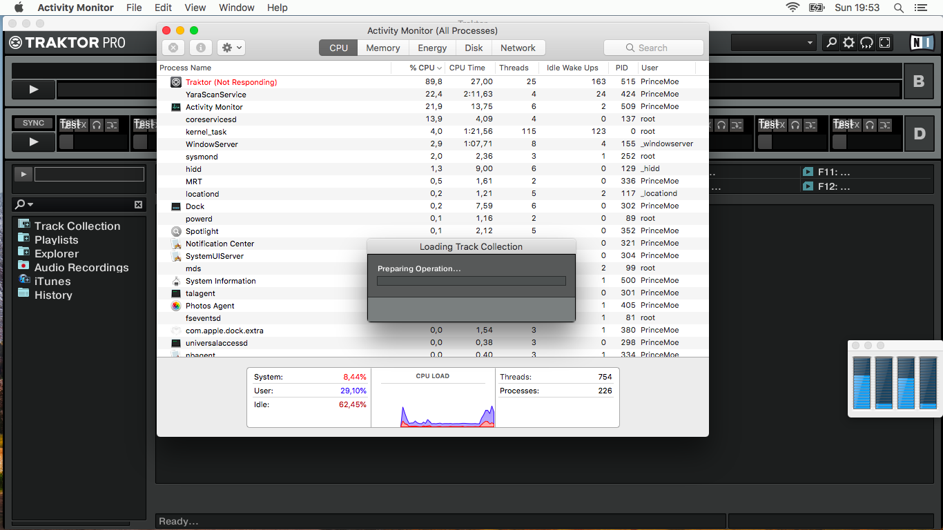

I ran the Macbook Air using Command (⌘)-R
I did a complete wipe using the disk utility and then fresh install.
Even after a fresh install my Mac is not working as smooth as it should.
The CPU load is high in the skies when I use it.
No unnecessary apps at start up and no softwares to start with except Traktor DJ.
When I was doing with (a fresh install) I had audio drop outs.
Activity monitor showed all bar FULL in overload.
Google search shows that I am not the only one with the issue but no one seems to know the issue cause and solution.
Here's the checkup after quitting Traktor. Oh by the way, my fans are always running on max I realised. AND all of that so sudden, no change to my usual routine.

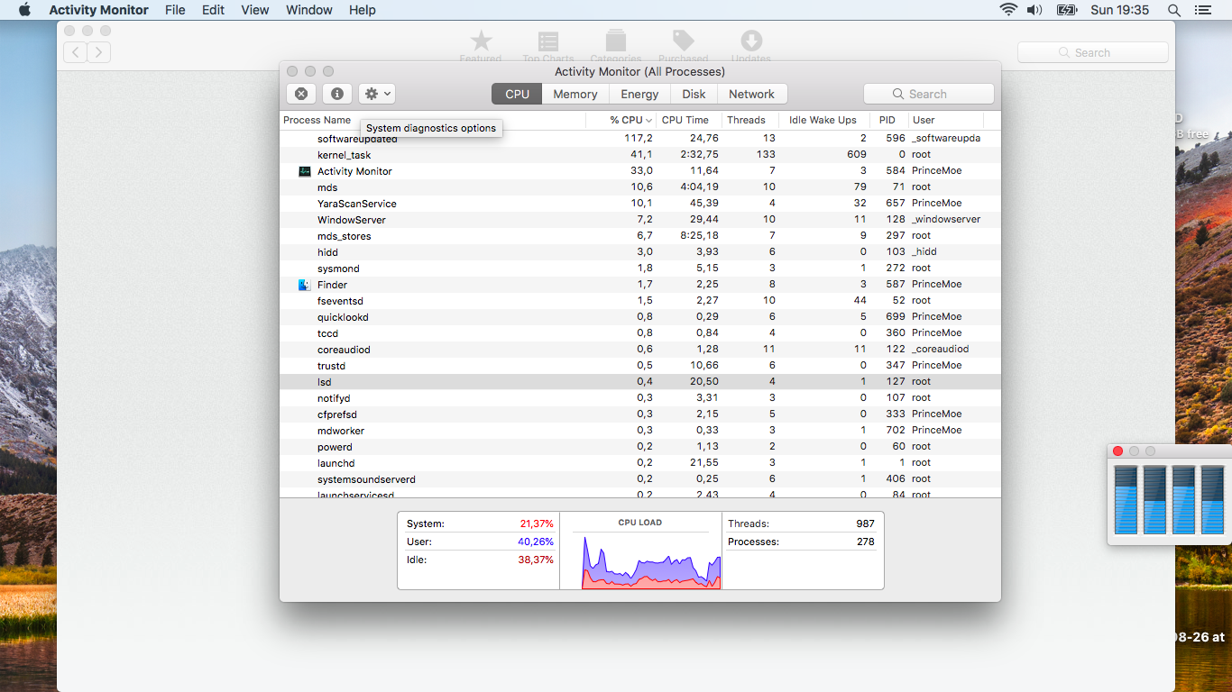

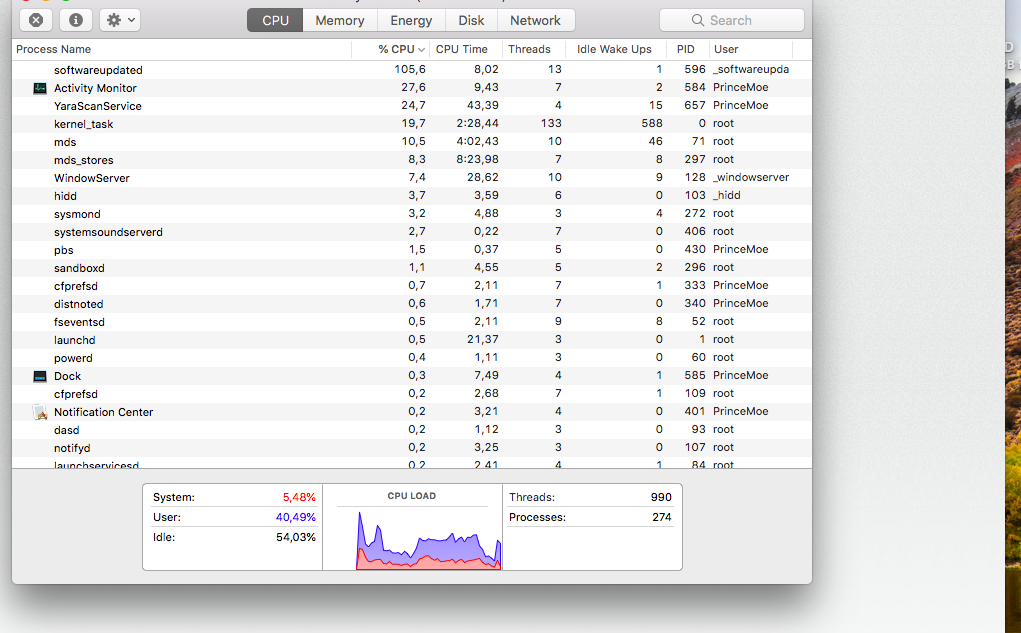

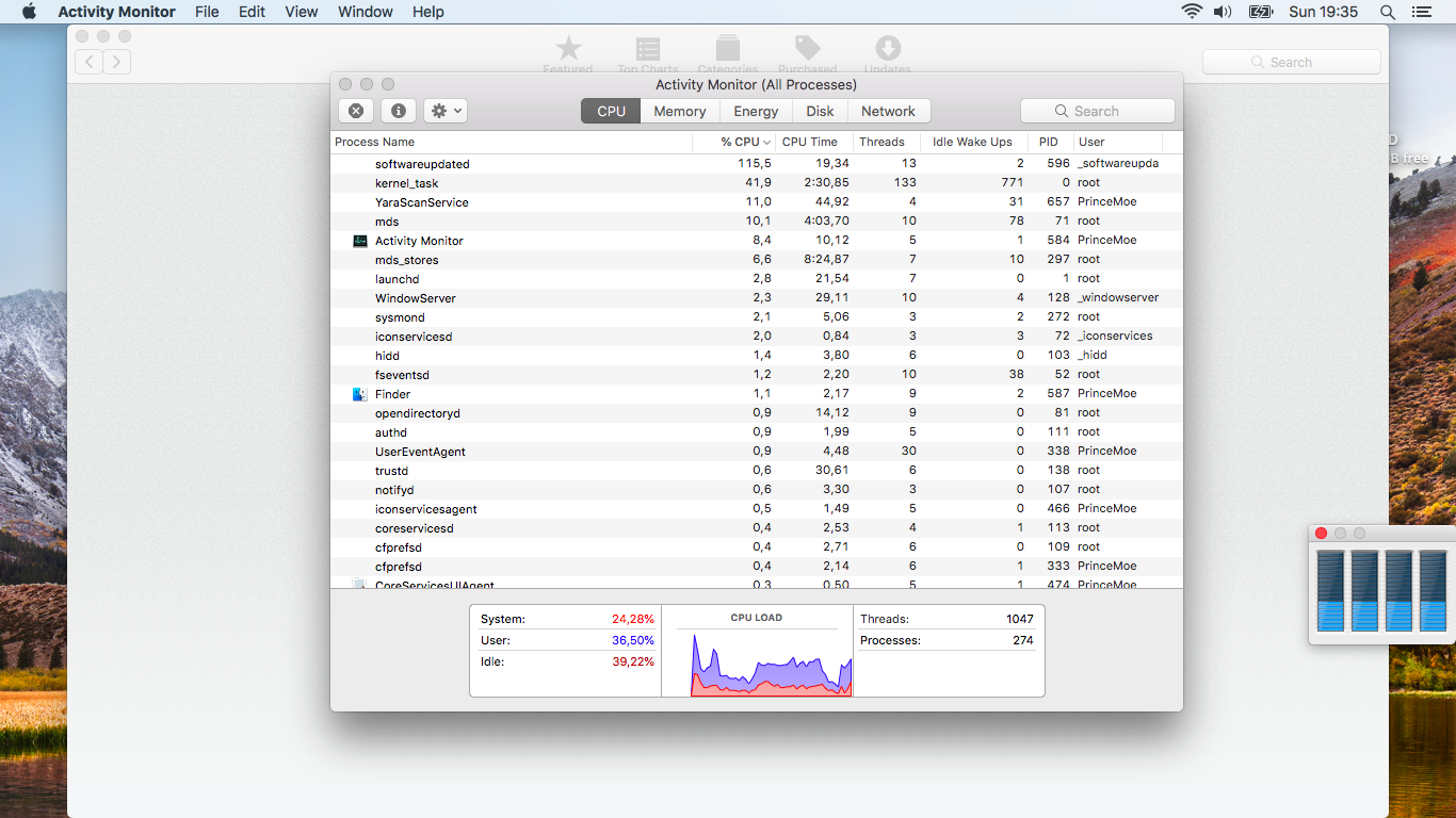

I don't think the issue is solved.
Even in safe mode and an OS update to Sierra...
Fans are spinning at full speed.
No software is running except Traktor and Activity monitor. The activity level is so high...
attached are a few screenshots seconds or minutes away from each other...
If you are in safe mode, why is Traktor running? The idea is to use safe mode with nothing else running to see if that fixes it.
I tried running the software to see what impact it would have. Nevertheless, even when its not running the Mac seems to be having issues. So nothing really changed.
So what are the issues that you have after a complete wipe, reinstall, and safe mode boot running no programs?
When activity monitor settles down to a consistent list of processes that would be useful to see those that are using a lot of cpu.

So with no programs running in safe mode, what are the processes that are consistently consuming the cpu?
With NO programs running, Activity Monitor/Cpu/Sort by CPU %. Then sort by CPU time. We need to find out what process(es) are causing the problem.
