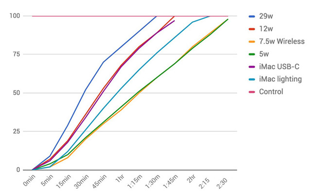

is that graph correct for 7.5W wireless? That line looks more like the standard 5w wireless - I think I read other reports saying wireless is basically on par with the standard 5W charger? 75W should be more around where that light blue line is
I think it was a 7.5W charger but the device was on an older version of iOS 11 at the time of the test so it's only drawing 5W.
It shows the difference between the 12W and 29W chargers though.
