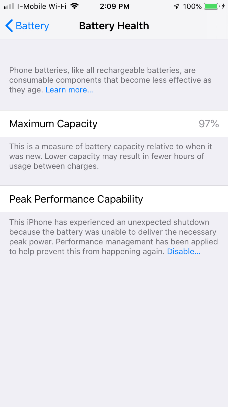

My iPhone 6s had a battery replacement in February of 2018 by Apple and has 97% capacity and is already experiencing shutdowns.

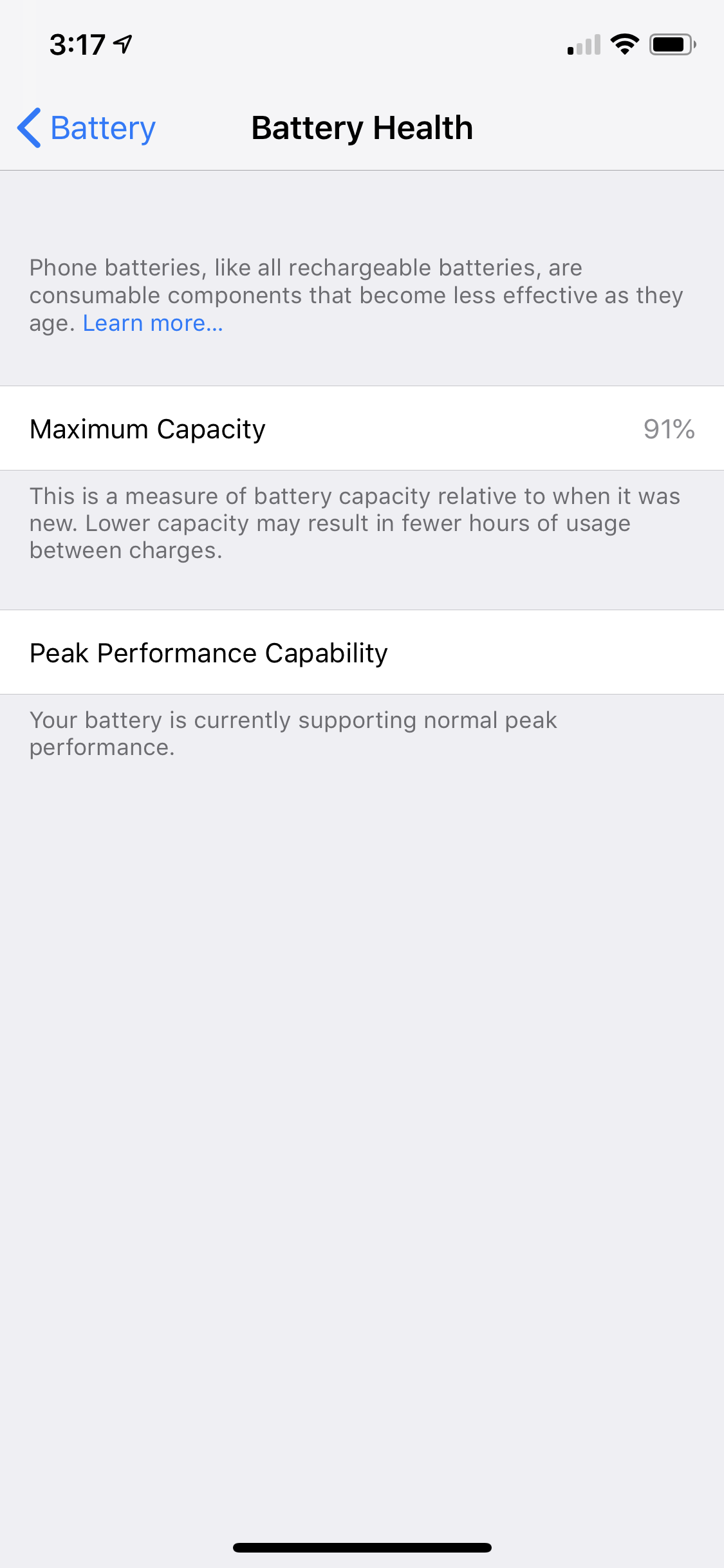

My iPhone X has an older battery (still on its factory battery for over a year) has 91% capacity and isn't experiencing shutdowns.
