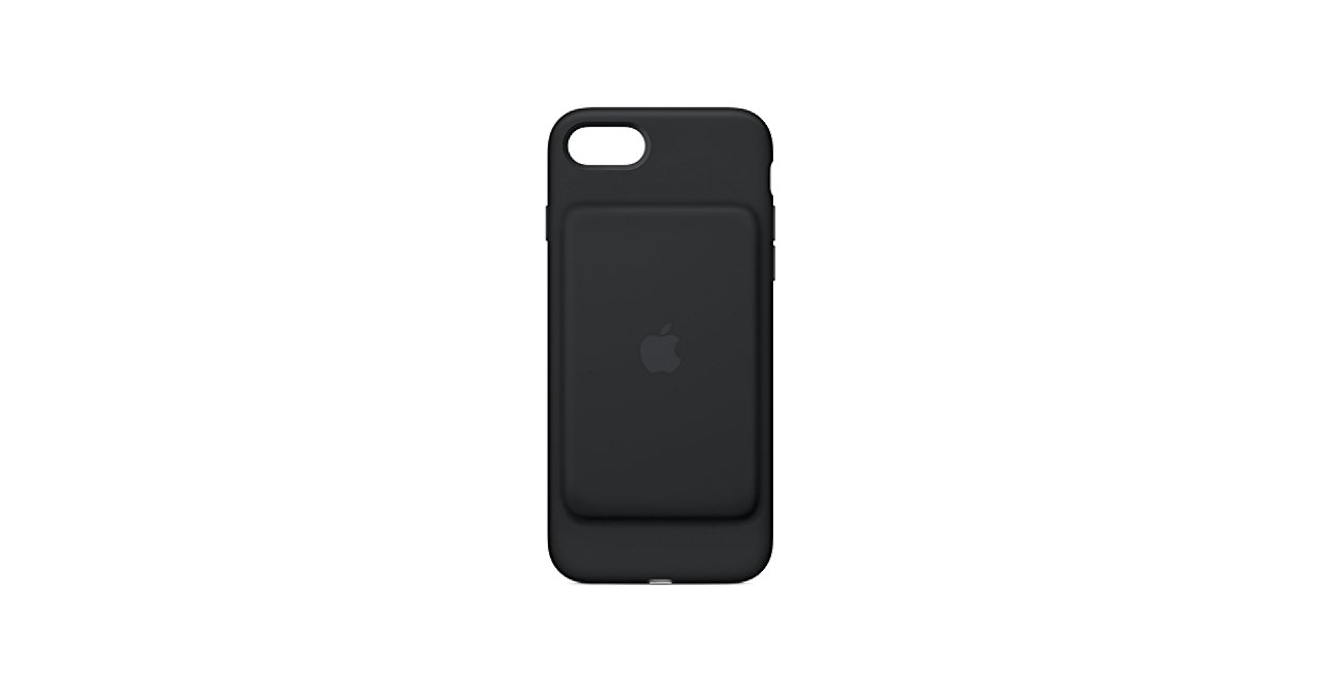

Which battery case are you using?
Becase the iPhone 7 from Apple it's expensive and I hate that chunk bezel in the bottom of the case.
I am using the iPhone 7 Smart Battery Case. Amazon has the black case on sale for $78. On 9/20 it was $49.

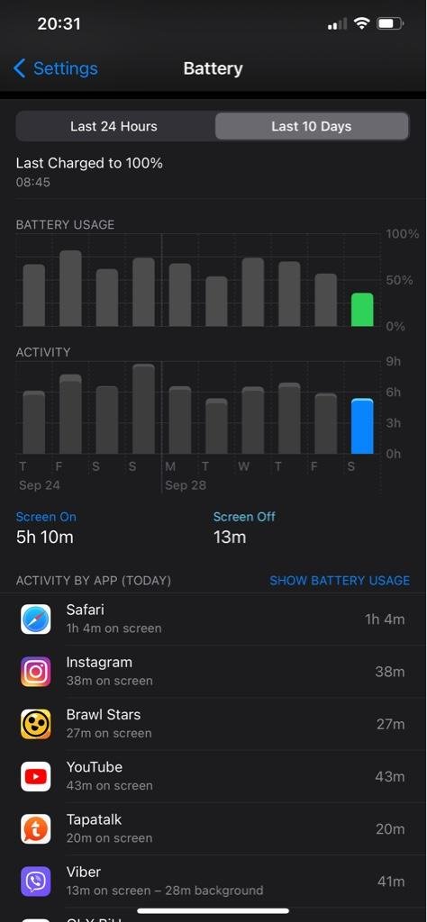

Just some data: On my iPhone X I lose about 3 % of battery life when using Safari + Discord for about 10 minutes. That’s quite bad, isn’t it?
