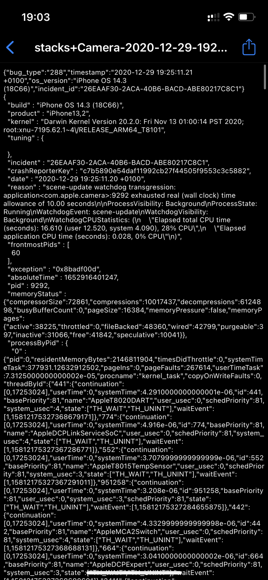

That is great! Mine crashed like seconds ago 😂 but finally I have got a log from the crash, it seems like the iOS is killing camera app because it takes too much of cpu resources so it kills the app to prevent the iOS from becoming very laggy. So either it is a problem in optimization or problem with my cpu. I am attaching part of this log as a screenshot.
This is very useful info! This might help Apple finally solve the problem. It may be that some units have a faulty cpu.
Diagnostics should catch that though. It really is a frustrating problem, and I'm still not convinced that I'm free of it. My original phone has gone longer than this between crashes. If I get through a couple of weeks with no incidents then I will be sure. Until then, I still hold my breath every time I try the camera.
