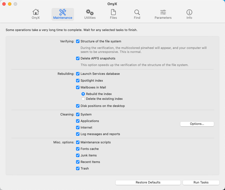

Quick update from me: I ran the Onyx maintenance script and Homekit has been happy since (72 hours and counting...)
Didn't help. I have Ipod mini, 86 accessories, and seven bridges. just tested and try all the tricks but still automations failing. before IOS 16 all was perfect
