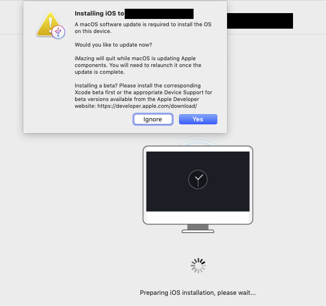

I first backed up the phone using iMazing (2.18.1) using a USB cable. I then tried to update the phone from iMazing itself, but was first asked to install some MacOS updates:
Unfortunately nothing happened after pressing "Yes" except iMazing quit. I tried it several times with the same result and waiting for a long time for something to happen.
So I decided to remove the USB cable to the Mac, turn on Wifi on the phone and (with the phone's charger plugged in) upgraded to iOS 18.4 from the "Settings" app. This worked perfectly, but took quite a while (I think something like 45 minutes).

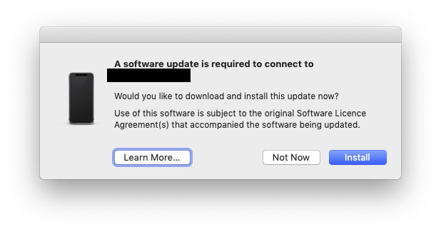

Next, I plugged the updated phone into the USB cable attached to the Mac and the following alert popped up on the Mac (MacOS 10.14.6) after a couple of seconds (so apparently something went wrong with the upgrade in iMazing, where I waited for several minutes without any response):

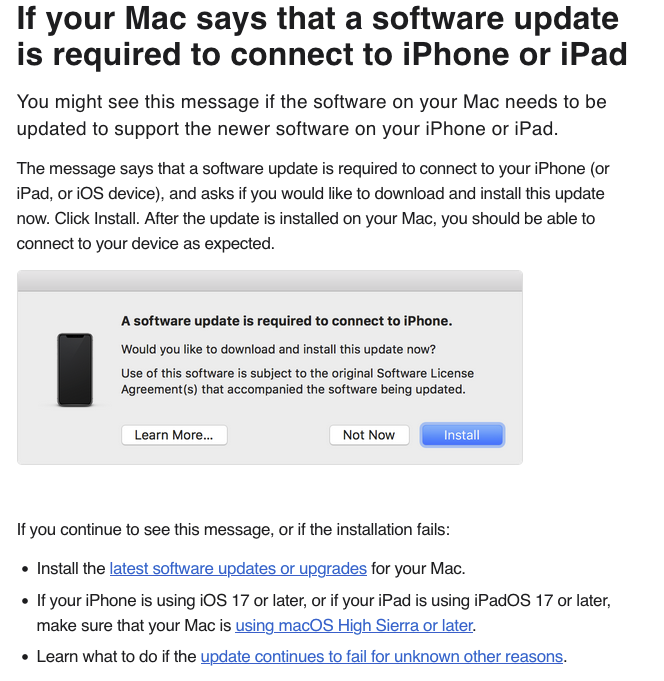

By clicking on the "Learn more..." button a web page from Apple entitled If your Mac says that a software update is required to connect to iPhone or iPad popped up:
Interestingly it appears that unlike most other upgrades in MacOS, here the minimum requirements appear to have stopped at MacOS High Sierra (10.13) which is good news of course!

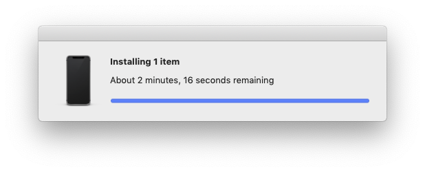

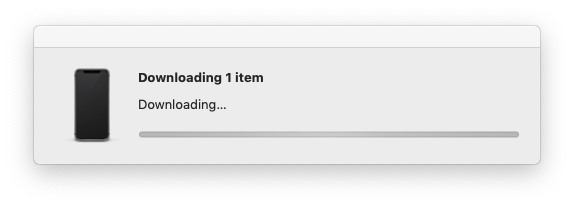

Next I pressed the "Install" button which started the Mac update:
When done I opened iTunes (still showing version 12.9.5.5 as before), and the phone showed up there just as before the iOS update. I also tried transferring some new PDFs etc. over to the iPhone and it worked perfectly.
