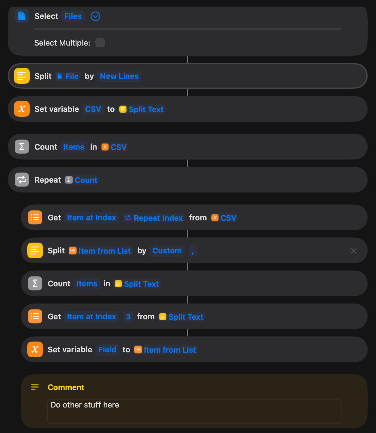

forgive me for asking (I have tried numerous times for several weeks trying to do all I know to do and I can’t figure it out. reddit and google and chatgpt sound promising but I can’t get it to work)
can someone tell me what to type into the new shortcuts app so that I can import a bunch of podcasts feeds into Apple Podcasts? I have tried methods to start with an opml file, I have tried a more plain csv that I just copy and paste the feeds a few at a time, and I have tried one feed at a time.

That’s certainly a unique use case.. I’d ask over on shortcut.bot, lots of great help there
Have not messed with Podcasts actions in Shortcuts, but CSV processing is usually pretty straight forward (assuming the CSV does not have stray commas in it).
Generally, see attached.

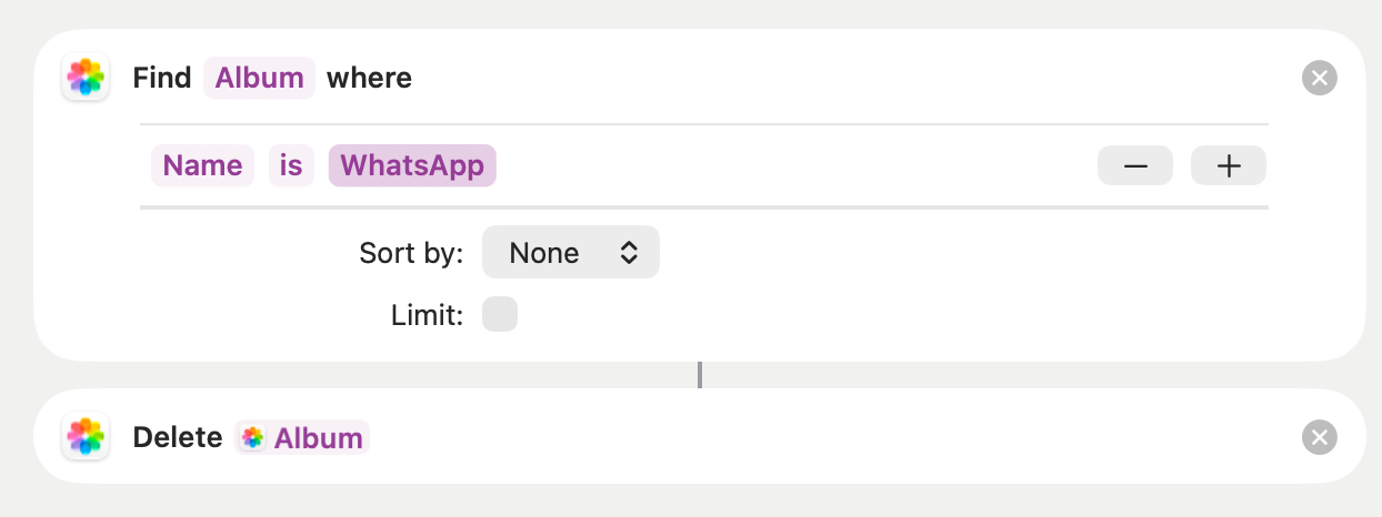

... try asking Siri to create a shortcut using the new Photo "delete album" action. Even creating one manually fails to work.
Still doesn't work. FB ignored. I suspect we'll go live with this not working.

D'oh. I fixed the delete photo album issue.
Despite it looking like it should work, *AND* if I ask Siri to create the shortcut it does the same thing, you can't pass a text variable into the shortcut "delete album" action. You have to pass al album.
You could add some logic to throw an error if the album doesn't exist, but as it is it silently does nothing if the album passed doesn't exist, which is good enough for my automation.
