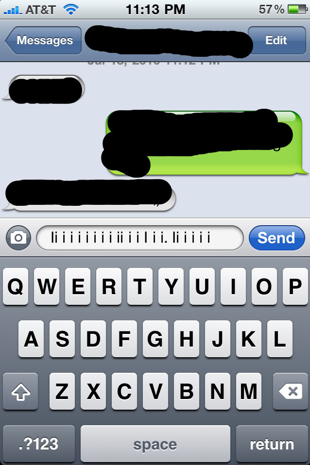

Is there anyone else that has this issue? I searched around and found a thread on a different site from a year or two ago but that is an old OS and I figure Apple would have had it figured out by now. I can never type a message without having the OS put in a lower case I. This is extremely annoying and can be remedied by me typing really slowly.
It seems whenever I type relatively fast (which isn't that fast for me since it's a touchscreen keyboard) it totally skips over capitalizing I, however it doesn't hesitate to auto correct other things I don't want it to).
Does anyone have a solution to this? It is extremely frustrating as it makes me look like an idiot in my opinion, all because I don't want to take the extra 5 seconds per instance to highlight, delete, type it in and then send. Super annoying.
I thank you in advance for any help that you might give me!

Wait, before you do this: Are you typing this into an Apple app? Like Notes?
Keep in mind, third party apps have control how to handle text corrections in textfields. Be sure to test this in Notes.
http://www.youtube.com/watch?v=wRup2jrLSdY
This is the video of me doing it. The application I am in is Apples messaging program so it is definitely not a third party program issue.

Okay, I just figured it out and yes you're right. There is a bug in 4.0.
Here's a way to test it: Put your thumbs on Space and the letter I. Now alternate slowly between the two, removing your thumb before pressing the other button. No problems.
Now: Overlap your presses. Press I and then right before you let up off I, press space, this will advance your text insertion point (caret) and not correct the spelling.
I also just tested this on a 3GS with 3.1.3, and it works ask expected, with no errors, even while overlapping.
Time to submit this bug.
