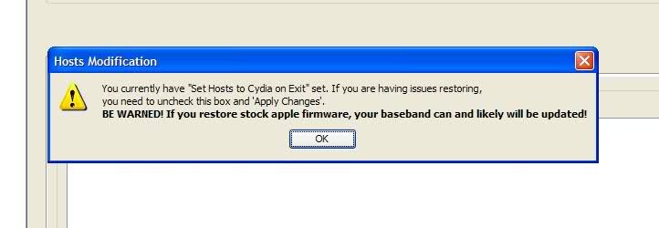

Sounds like you just have a hosts problem.
You can set the hosts to Apples servers with TU in order to get a proper stock restore with itunes.
What you mean? I have no clue how to use tiny umbrella at all lol

if you do restore, you need to set the host file to apple.
in TU go to the advanced tab and uncheck set host to cydia.
In that way it pionts to apple instead of cydia, which is neede for an 5.01 restore.
Also after restore and rejailbreak by redsn0w restore from backup, add all cydia packages manually, don't use a backup from pkgbackup or the likes, it might be a non-compatible app you have in your back-ups somewhere.

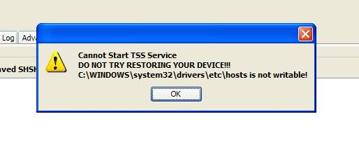

I did though, I opened TU and i unchecked the cydia host part and did a restore and at the end it gave me error 1601
this is what the log in TU said
01/12/2012 05:56:44.578 Loaded History... 01/12/2012 05:56:53.062 Cannot Start TSS Service DO NOT TRY RESTORING YOUR DEVICE!!! Your hosts file is not writable! 01/12/2012 05:56:53.062 You are using the current version of TinyUmbrella.
I have no clue how to restore this damn thing i think im stuck with a currupt jailbroken phone
