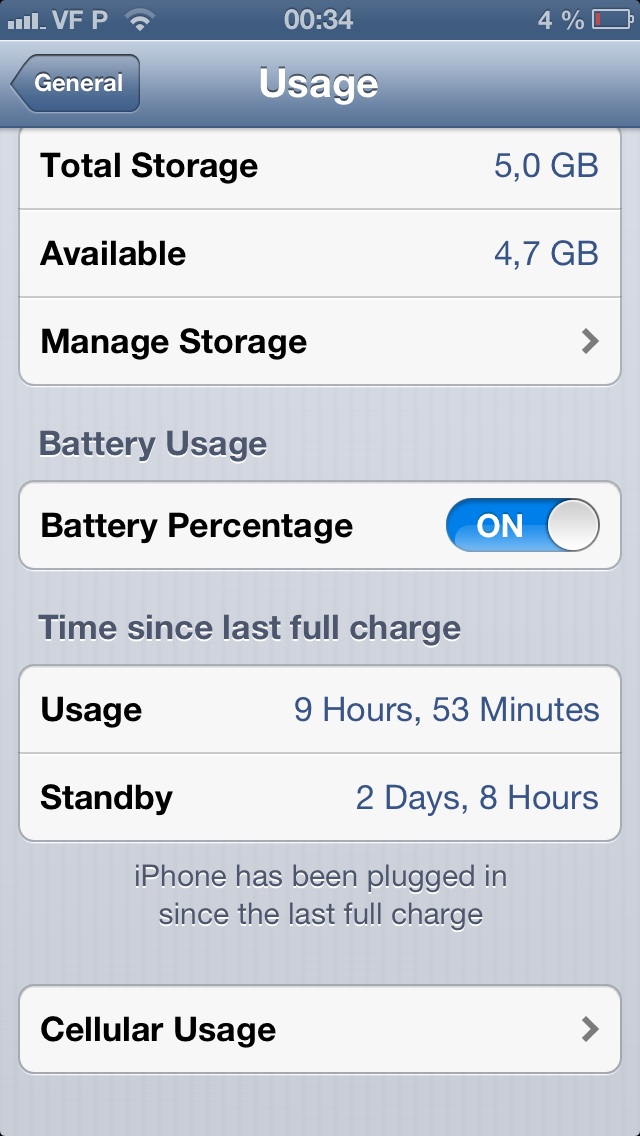

So guys now with the new built in battery u get more usage with ios7 what are ur stats?
I got my phone exchanged by apple for a new iphone 5 because i also had battery issues with ios 7 and the send me one with ios 6 on it.. Now i don t know if i should update or not. What do u think? Has sby experienced the same?
