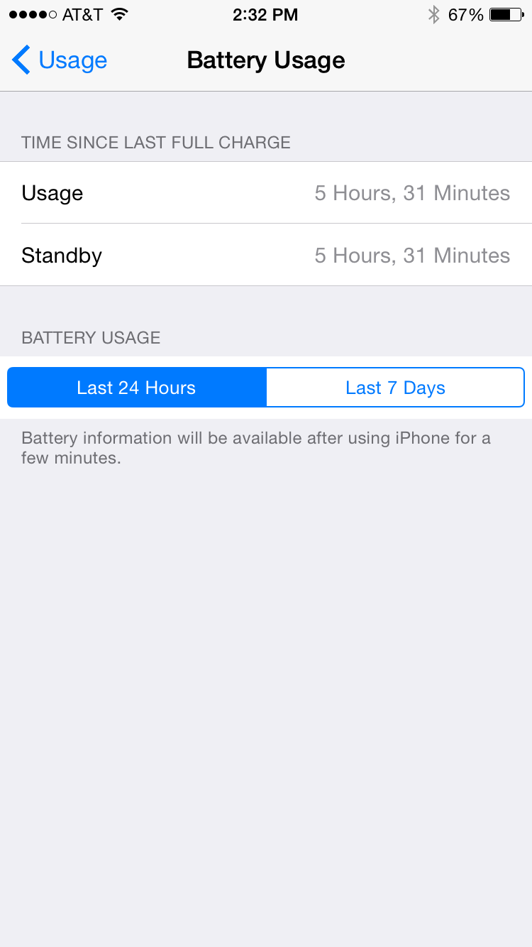

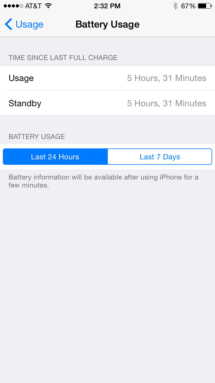

iPhone 6 here. My standby and usage are IDENTICAL and it won't load any of the apps to tell me what is using the most battery. I restored this from a backup of iPhone 5. The iPhone 5 was displaying the apps fine. Anyone else seeing this?

Here's a screenshot of what I'm seeing.

Wait at least 24 hours. A lot of internal and external processing occurs in a new iPhone setup, especially if you did an iCloud restore.
