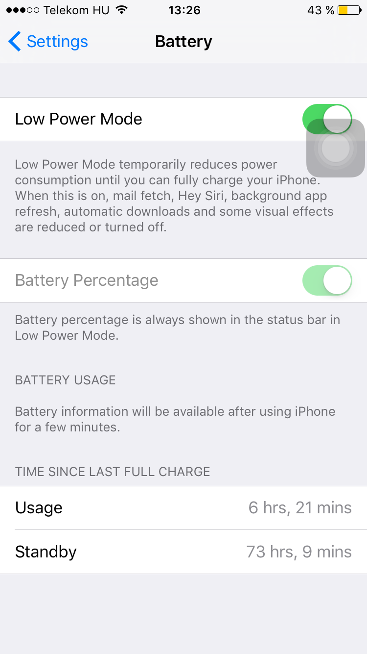

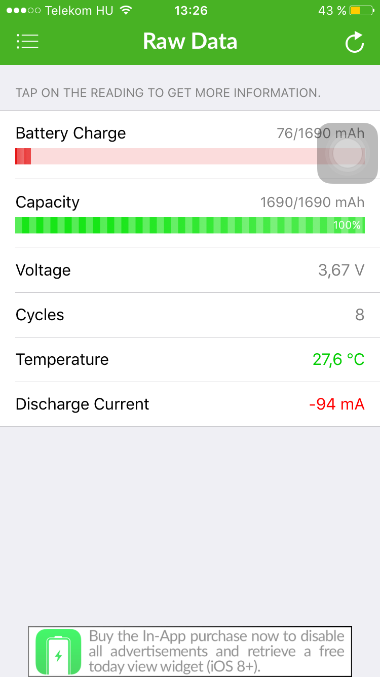

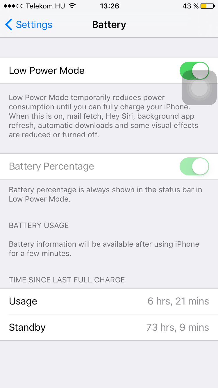

That is currently my battery status on 5%. What are your opinions about this usage?
Btw my battery indicator got stuck... So it's not the battery usage for 43% but only for 5%
The usage only really tells us that there is a problem, but on its own, it doesn't really give any indicators as to what exactly has caused it. However, the fact that you said your battery indicator got stuck, does tell us that the problem here is less likely to be app related, and more likely to be an issue with the phone itself. (and that it could either be a corrupt iOS file, or it could be the actual device). If this is the case, the first thing I would recommend doing, is going into iTunes and doing a full phone backup. (it's fairly easy to do, but worth doing before you do anything else, as that way, you won't lose any data if you end up having to reset the phone.) -You can simply copy all your data back onto the phone straight afterwards, and it will be exactly as your phone is now). But if something has gone wrong with the iOS software (like a corrupt file that's not behaving as it should), then reinstalling iOS via a simple phone reset (the same as when you set up your phone for the first time when you just bought it). But doing this will put everything back as it should, without whatever corrupt files were causing your battery to do this. If however after all this it still has the same problematic behavior, this will tell us that the problem is not an issue with iOS either, and that the problem lies with the phone's hardware. (the device itself, not the operating system). So if this is what you find happens, then Apple will be able to replace it, and you will be able to put all your old data back on the new phone from the backup you made earlier).
It's fairly easy to do, but if you don't feel confident in doing this, or if you have any questions you are not sure about, then don't be shy to ask. I will help with whatever I can. And also if you prefer personal help from an actual Apple representative, they will usually be able to help you at any Apple store. (at least, they've always been pretty helpful at the Apple stores that I've ever been to.)

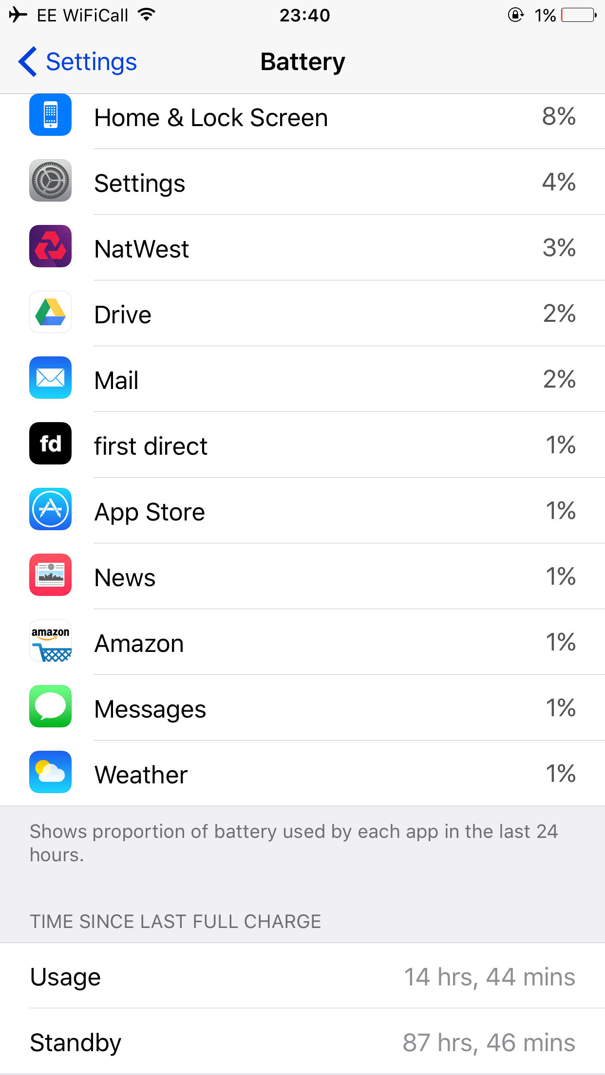

Seriously, what is this crap? Started fresh from backup from ITunes after some disastrous days after upgrading to iOS 9.3.1. It seemed to solve the battery drain but the latest two days the drain has been back with a vengeance! I haven't done anything differently the last days. I've had the phone in my pocket for 10 h and it seems that the phone has been working nonstop!!!
