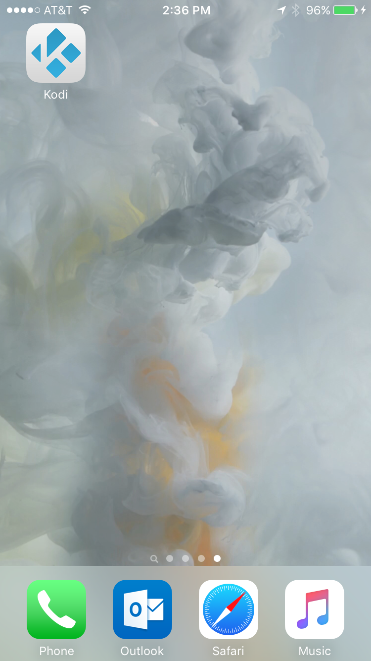

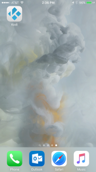

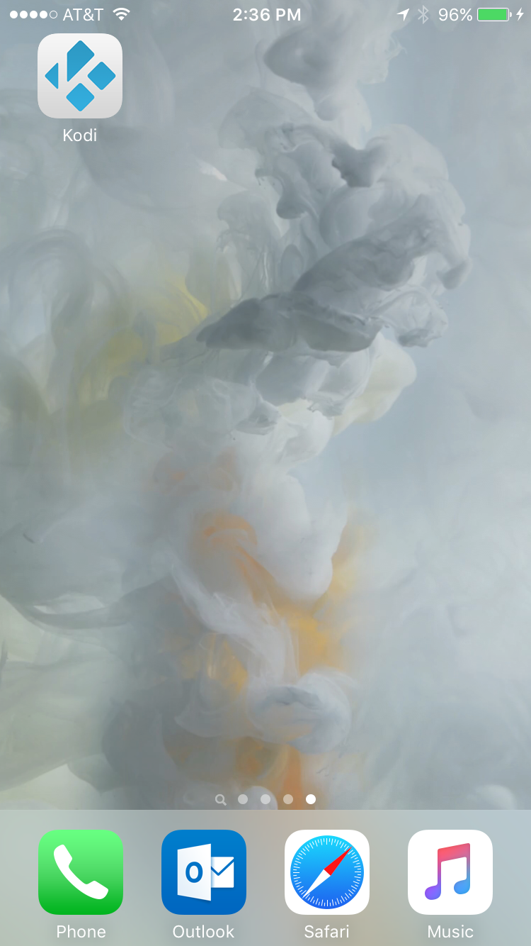

I just compiled this and loaded it on the iphone and i am total noob when it comes to these things. I followed the guide on kodi github. You have to add your apple id to sign the app. You don't have to pay for anything.
Umm will have to check if they updated it to ios9 since they were waiting for a jb to come out to do so. A few weeks ago You had to do a workaround and modify the code using the tutorial from the kodi forums since ios9 breaks universal compatibility of the app.
I don't want to jailbreak the device for security reasons and there is no jailbreak for 9.1. I just wanted to try it. Kodi isn't designed for a phone and drains the battery quickly.
