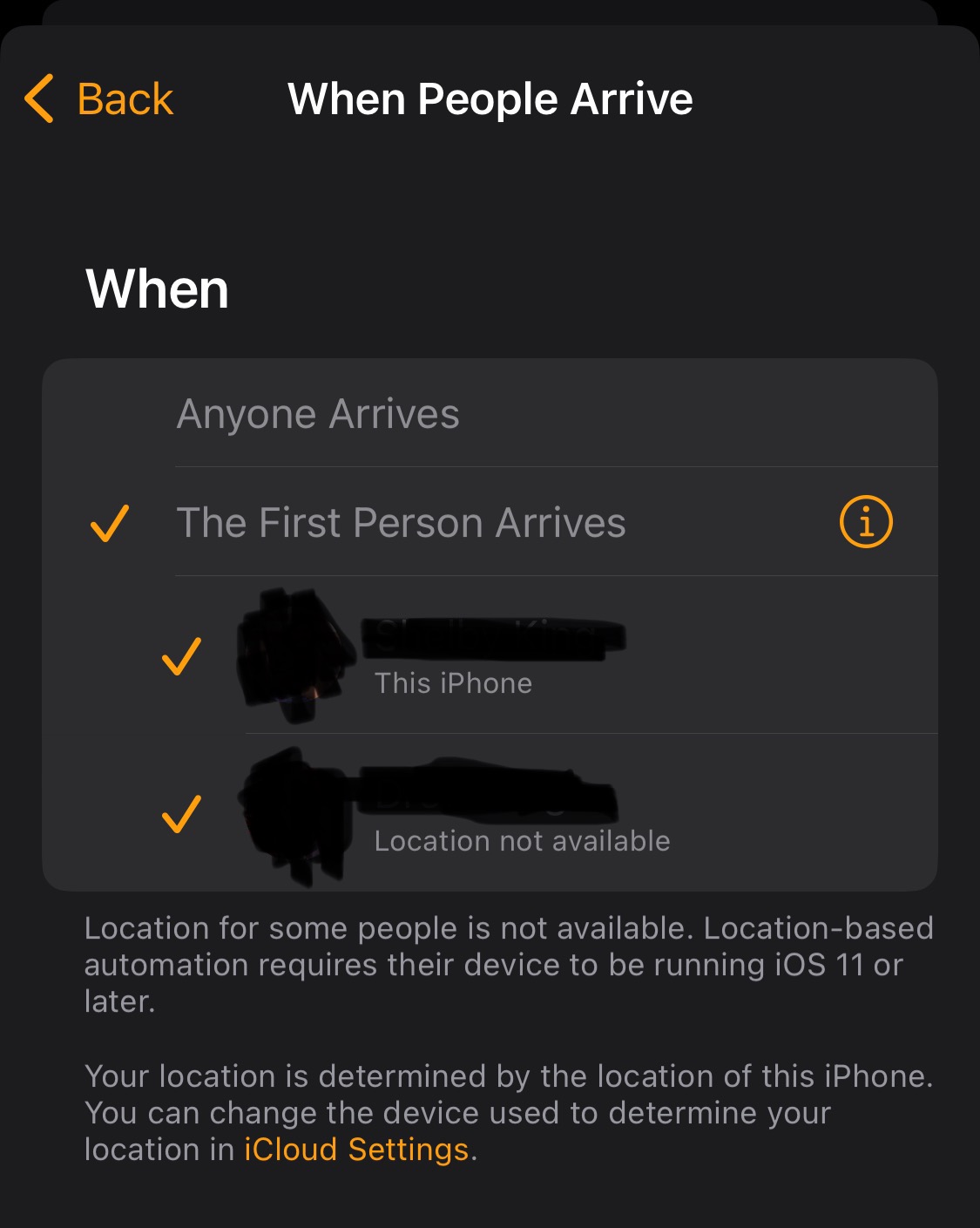

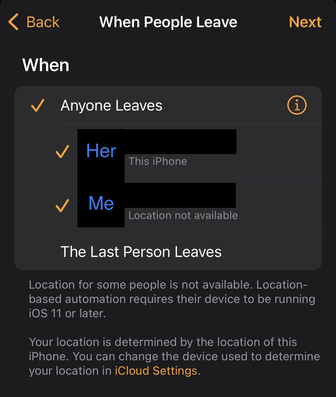

I have been having the same issue. I noticed on my wife’s device it is giving me an error saying “Location not available”, speaking about my device. It goes on to say the device requires iOS 11 or later. I have an iPhone 14 Pro Max so I have definitely checked that box.
I have completely reset my Home and set up all my devices once again with the same issue. I am assuming this is some kind of but that will be fixed, hopefully, with iOS 16.1
Thank you for posting this. I too am seeing this very same "Location not available" on my wife's phone regarding my location for these Arrive/Leave automations, of which the "Last Person Leaves" automation does not work.
Have you been able to figure anything out on this front?
At this point I would like to stop wasting my time and hope for the best with the next update in order to resolve this.
Oh it’s been a while but I did resolve the issue. I believe I had to use the nuclear option and delete my “home” and start from square one. It was a pain, but I haven’t had any issues sense.
