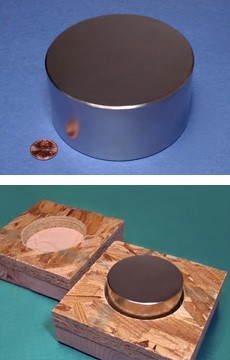

Also, a magnet would have to be a really really really big neodymium magnet to effect electronics. The size of a Hockey Puck. The magnets in the Smart cover and iPad 2 are just too small.
http://www.kjmagnetics.com/proddetail.asp?prod=DZX0Y0-N52&cat=168

Also, a magnet would have to be really really really big neodymium magnet to effect electronics. The size of a Hockey Puck. The magnets in the Smart cover and iPad 2 are just too small.
